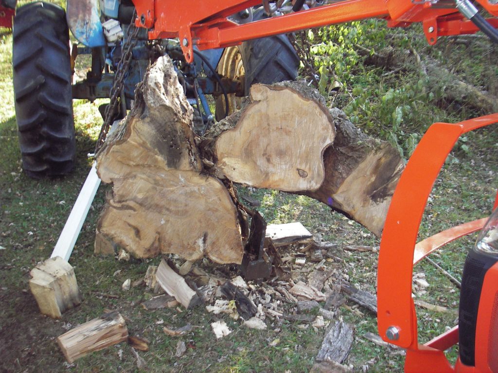

I'm not sure what they weigh but they are too heavy for me to wrestle.
I put 1/2" lag bolts either side and lift them with the pallet forks on to the splitter.
Slow going but I don't have a faster way.
Pick the cleavage line
Bam!
I drive it over to the splitter flat on the forks, then get the chain on the lag bolts because it swings on the chain and might hit the tractor.
It's easy to stand clear as it falls in half.

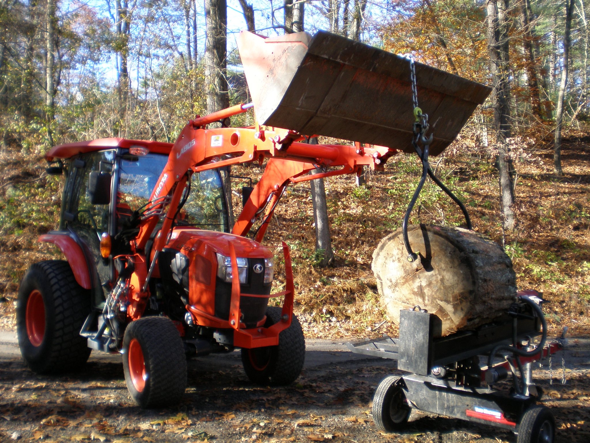

I know what you mean. I have had my share of very large and heavy logs and the only way is with the tractor to lift them onto the splitter.

If you ordered a third function and grapple tonight it might be this time next year before you get them, but that looks like a job for a grapple. Pick it up with the giant hydraulic hand and set it up there. Loosen the lids a little bit and split it. Backhoe with thumb would do the same thing.

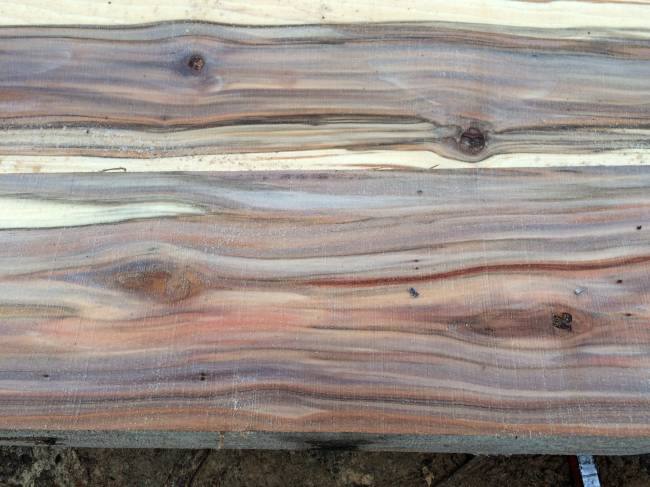

spent a summer milling 'live edge spalted Maple' . enough to fill a 20x40x14 shop, 1/2 were close to 24" wide,2" thick,all properly stickered,air dried for 5 years. NO warping.ZERO interest in them even though 'live edge' tables were a hot item. Took chainsaw to sut up into 2' lengths and spent several months burning them in firepit.
next were the 'chickootery boards', 350+ of them, again milled,stickerd,dry, 'flat as a board'. ZERO interest. even the guy who'se wife sells them at $80 each, wouldn't buy the blanks at $1 each. They burned in th e pit as well
While I enjoyed the running of the sawmill, since no onewood buy the lumber, I gave it away, probably do the same with the BX23S next summer.

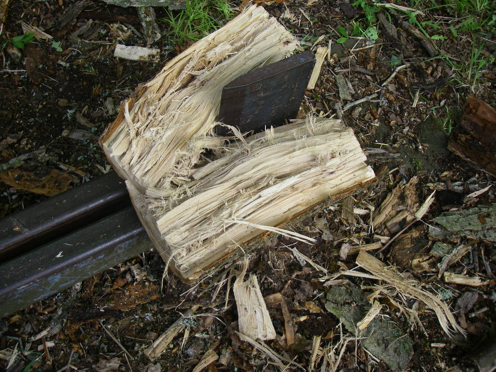

I would like to see the supersplit argue with this gnarly piece of Elm.
Elm is in the 'spiral grain' category and will fight before splitting. So it goes for other spiral grain species such as Hickory, Pecan, Sycamore, & Sweetgum.

I forgot to include Hackberry (which is in the Elm family). The spiral will reverse direction and be in the opposite direction several times during a tree's life creating a finger lacing affect which resists splitting.
Here are a couple of pictures of Sweetgum clearing showing the inter-woven wood grain.
