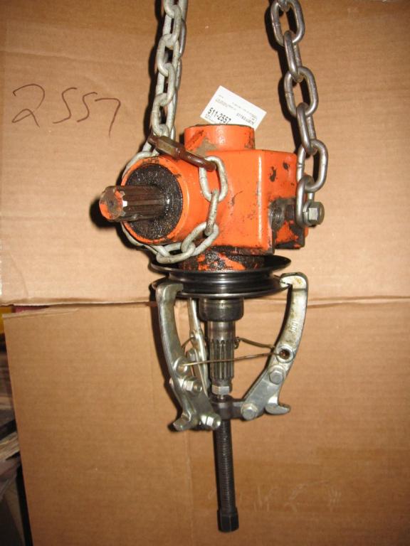

Now that mowing season is over, I am taking the time to work over the RCB60-I belly mower on my new-to-me B8200DT. Primary task is to repair the gearbox powered by the front PTO shaft. The manuals call for 90W gear oil for lube, but the seal is gone - just leaks out in a puddle.

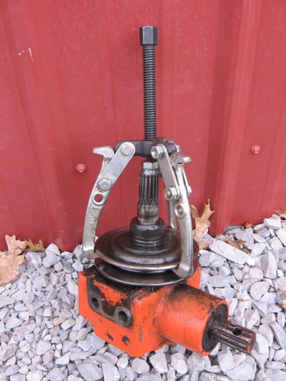

I have the gearbox pulled and separated from the lower jack shaft. Just need to get the pulley off to reach the lower seal. My three jaw pulley fits this job pretty well. I've tapped on the shaft and applied lots of PB Blaster. I sure don't want to bend the pulley, as Messicks is pretty proud of their new ones (Part #70712-99750, $102.88)
It's not rusty and I'm not wild about heating it with 'the gas wrench' unless I have to. What is the secret handshake to getting this thing to pop loose?

I do not remember if this is possible but at least consider trying to get the box apart with the pulley still on the shaft.
Once apart, then you have a better chance of getting the pulley off with something supporting the hub behind the pulley while trying to press the shaft through the pulley.
The pulley will bend easily.
Dave
Big Kahuna
Kubota 2000 L3010 HST with Loader ,1992 B7100HST , 1979 B6100E & 2007 F2880
Dec 23, 2011
375
10
Homer City, Pa.
Take #4 off then remove circlip and drop shaft thru gearbox, then support pulley and press shaft off.

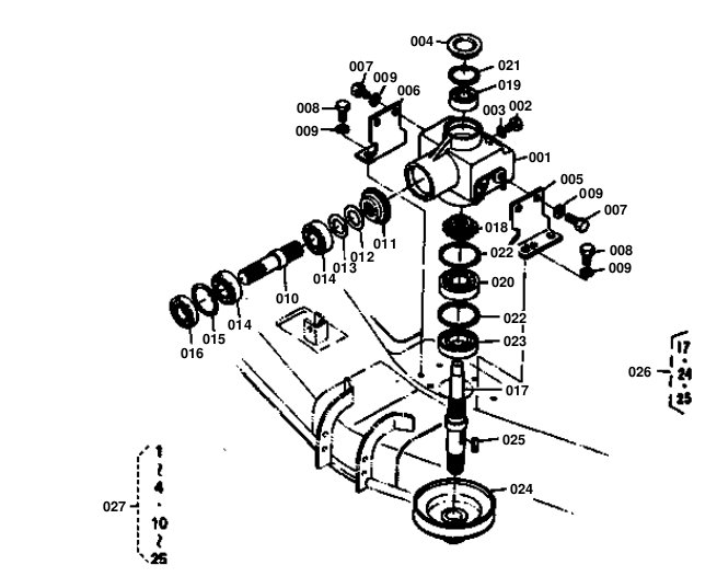

How in the world did you get the gearbox off the deck?! I've tried for an hour and can't figure it out.
Took off blade, little cover with the tabs and the Cclip. On the top the entire gear box is loose. Shouldn't it just pull straight up? In the parts diagram there is another C clip about half way up the shaft but I can't figure out how to get the other pieces off to get to it.
