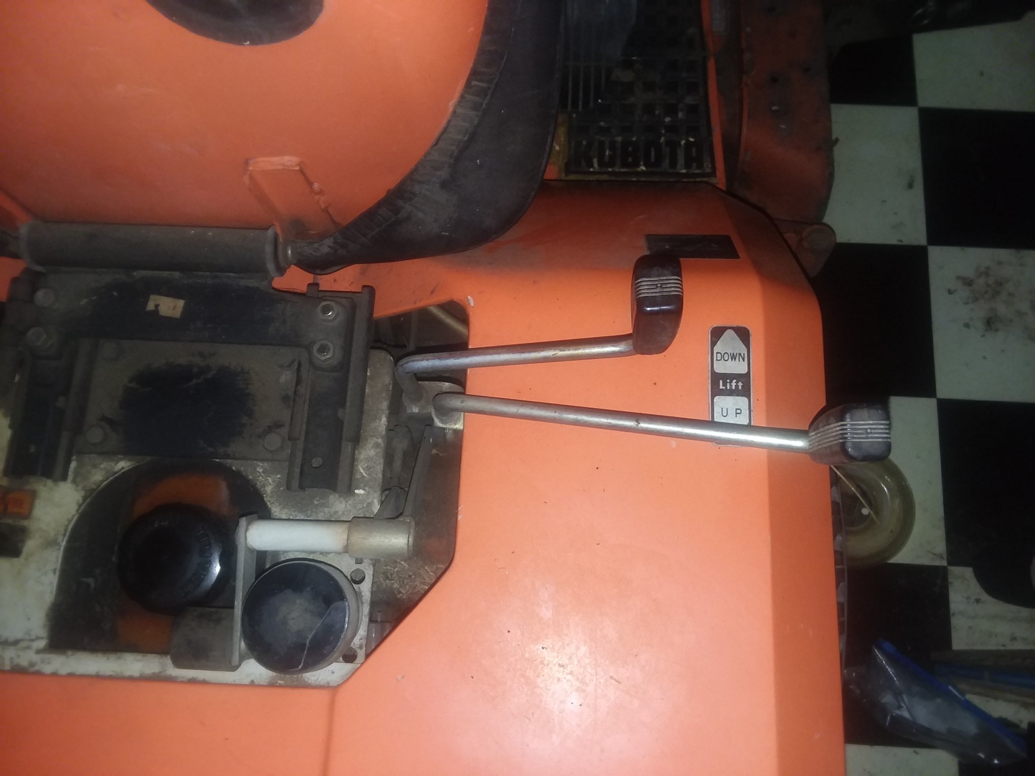

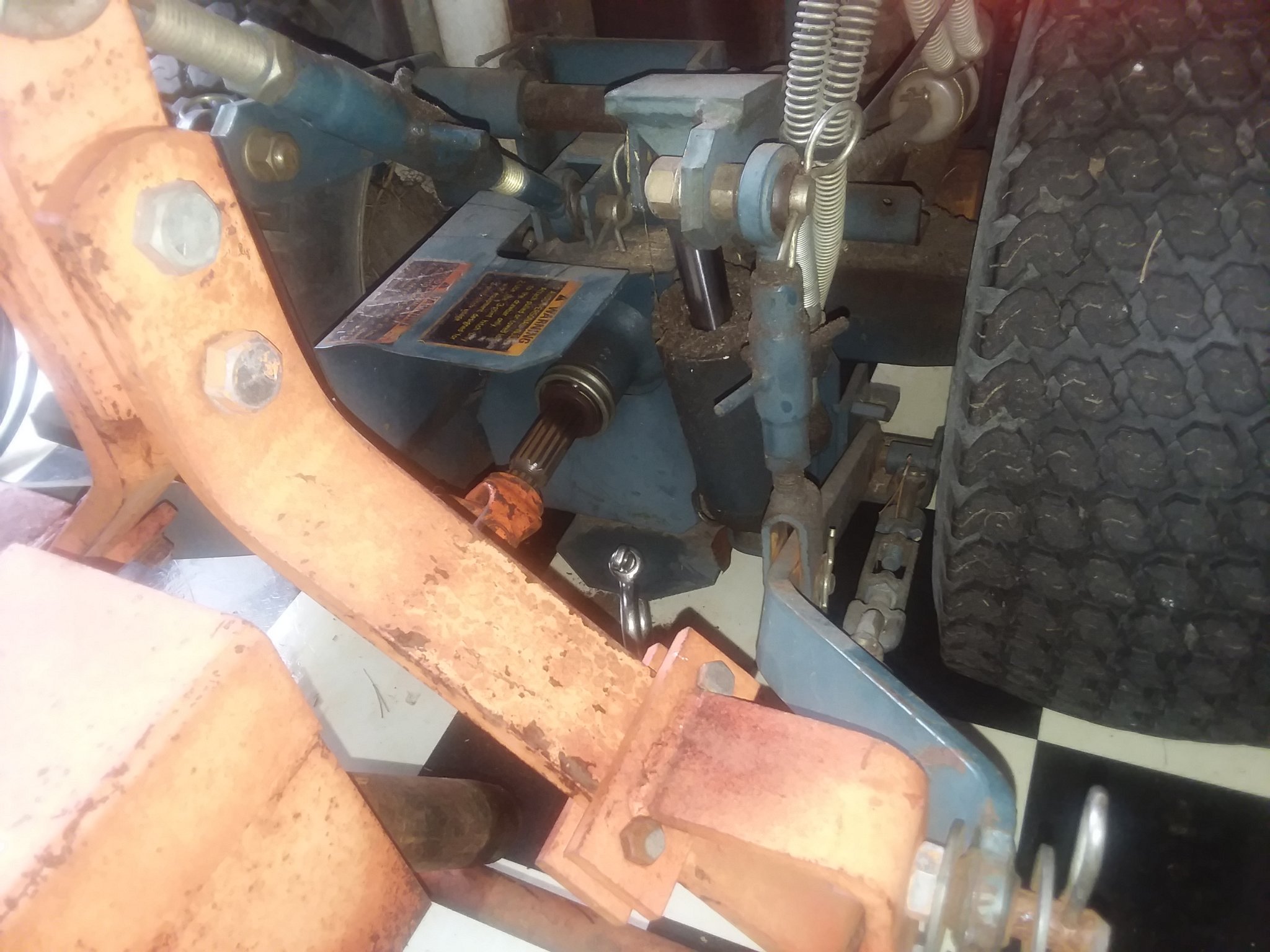

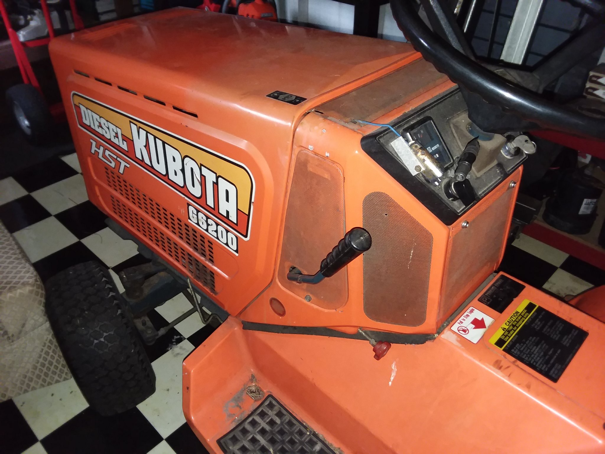

Hi and thanks for your reply,
I'm including some pictures. The rotortiller is supported by the 3 point hitch and the shaft is a universal joint with a splined shaft on the tractor side and square drive into the tiller. There are 2 levers under the right side of the seat that are 1) for the mower deck lift and 2) for the 3 point hitch lift. The only power take off lever is for the belt tensioner for the front PTO drive connected to the mower deck. Hope this helps. 20201122_131050.jpg 20201122_131115.jpg 20201122_131248.jpg

Lets not forget that the rear PTO option was not often purchased so there are VERY few folks who have them in real life.
From looking at the online diagrams, ( https://apps.kubotausa.com/illustrated-parts/ ) it appears that the rear PTO is driven from the same lever/belts as the mowdeck.
It appears that the driveshaft for the mowdeck is to be removed and replaced with driveshaft which connects to the rear PTO assembly.(instead of the mowdeck)
I would suggest you review the online service manual for the rear PTO option to get familiar with how it functions.

Just a quick update - long over due - but I finally put the tractor on the lift, removed the mower deck and searched through some spare parts that I eventually got from the previous owner, in the box was a longer drive shaft which, wouldn't you know, is exactly the length of the front pto drive to the splined shaft on the front of the rear PTO assembly. Got it all together, mounted the tiller on the 3 point hitch and I'm in business. The tiller works great, and removing the mower deck isn't much of a job.
