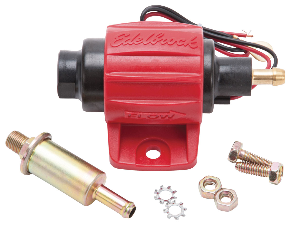

The fuel pump on my G5200 started to run intermittently... that is the failure mode for mine. Rapping it with a screwdriver-handle would make it start again.
My engine would run fine with with a FULL tank of fuel... but as the tank got lower, the engine would begin to stumble or quit running.
After hours of research, I ended up with an EDELELEBROCK electric pump from local autoparts supplier. It included a screw-in filter on the input and is a ROTARY pump instead of the noisy reciprocating pump like the original.
The MAIN thing you need to to validate is the PRESSURE it supplies is similar to the original pump. (approx 3-7 psi)
Here is photo of the pump I used ==> https://www.opgi.com/product/image/...edelbrock-universal-38gph-4-7-psi-edl7301.jpg
I did have to do some soldering to make it plug into the factory harness and figure out how to mount it... but that was trivial for me.
If you want plug-n-play replacement, go with original Kubota pump. (which will be VERY expensive.)
