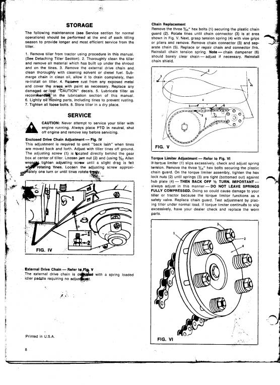

I think your tiller is the same as one I have. Mine is a B-36 but I am pretty sure I have read that they are the same. If I am correct you have a built in slip clutch under the chain guard for the external drive chain. Can you get a picture of your tiller? I have the original manual with the instructions for adjusting the slip clutch.

If that is your tiller then, yes you have a built in slip clutch under the chain cover.

Here is the page with the slip clutch adjustment. I hope you can read it. PM me with your email address and I will send you a PDF copy of the complete book.
