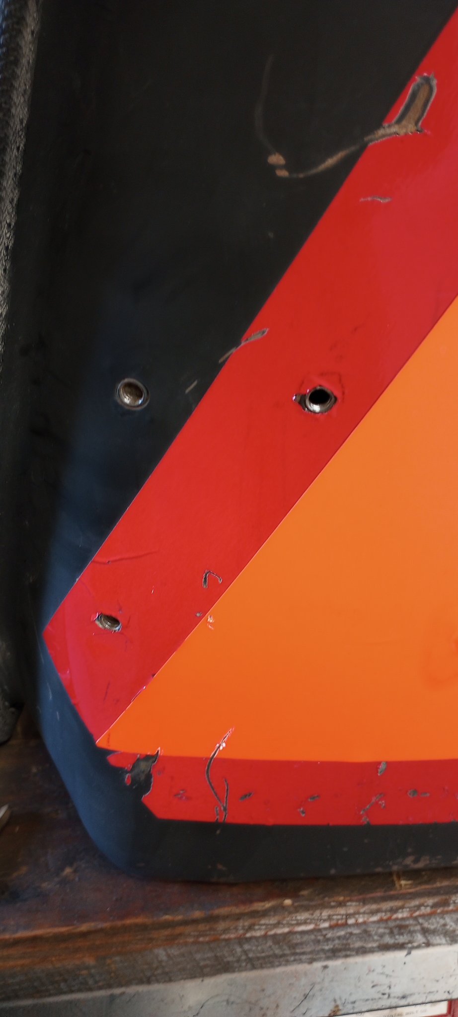

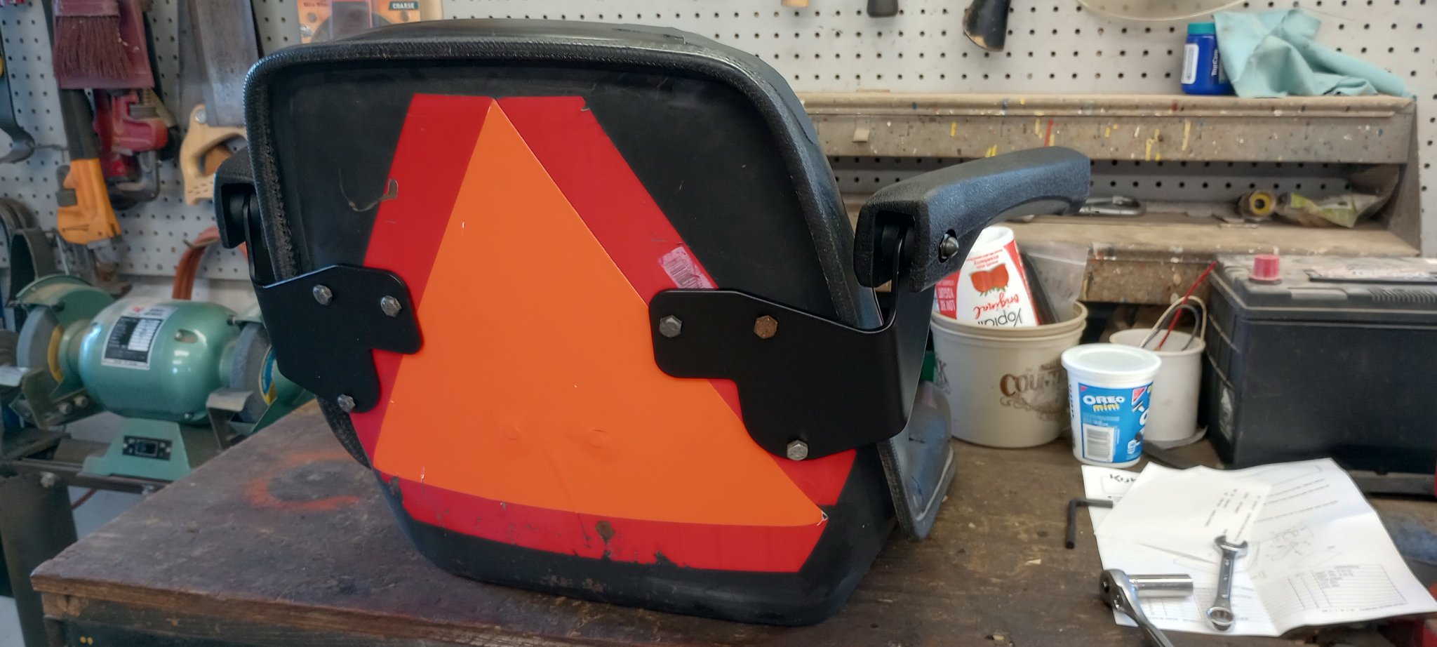

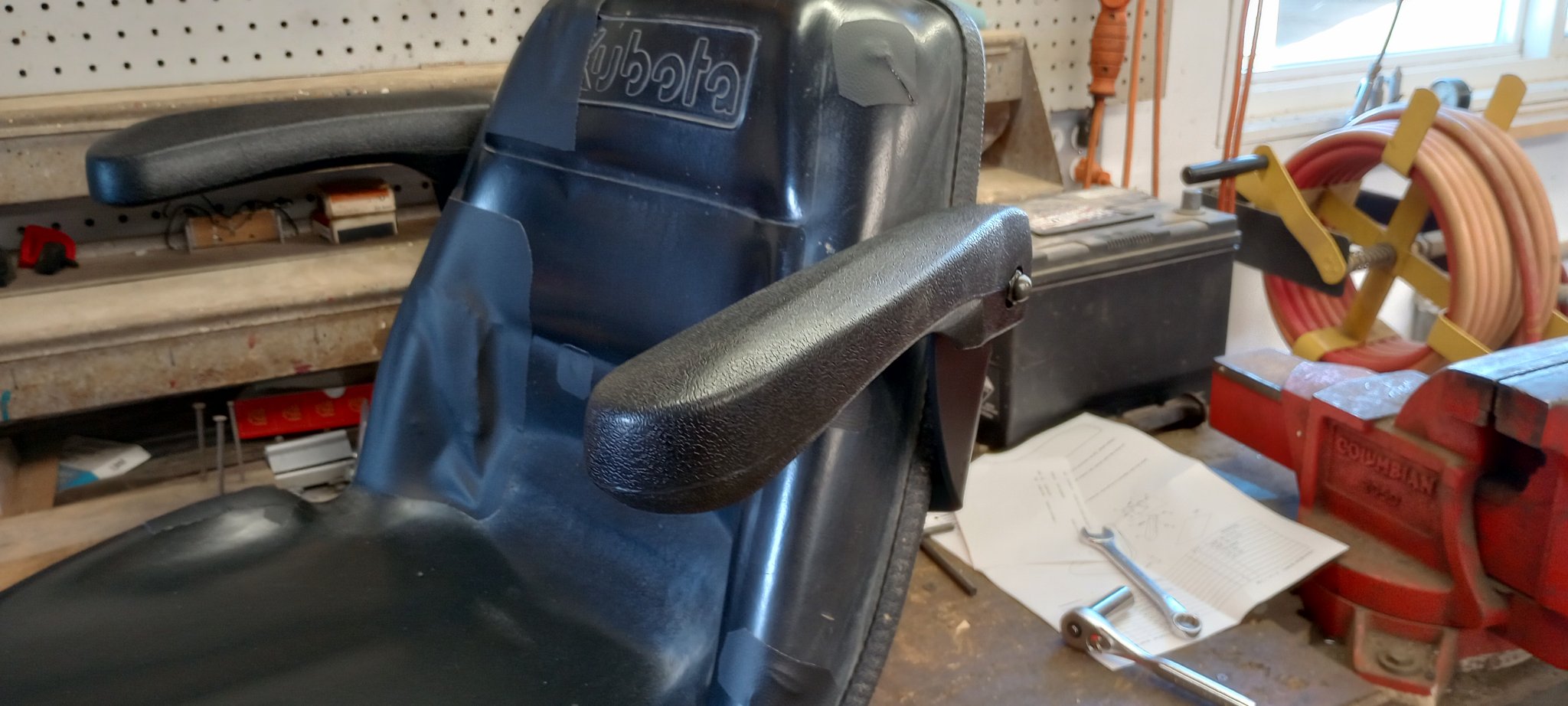

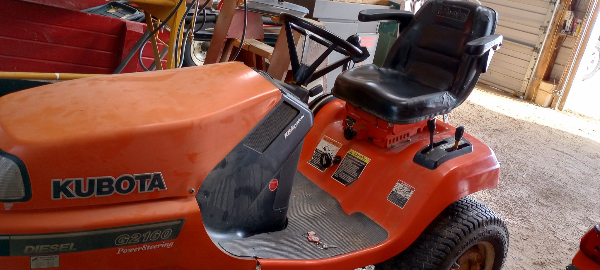

Not sure if already out there, we just got a used G2160, wanted armrest for the seat. found same ones that I put on my BX1860 will work atleast on mine. So if you have a Kubota seat that has the correct 6 holes in the back of the seat. See my pics, the B7358 kit worked on mine, I had to change out the 6 bracket mounting bolts to 5/16NC bolts. Cant wait now to use. Randy
