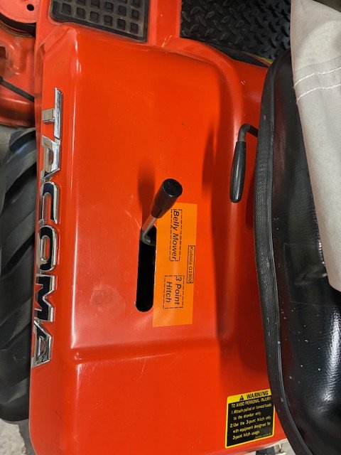

My home made lever and decal for ya Hugo. Hopefully Youngadretti comes back to post what you want.

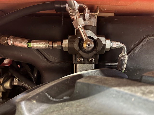

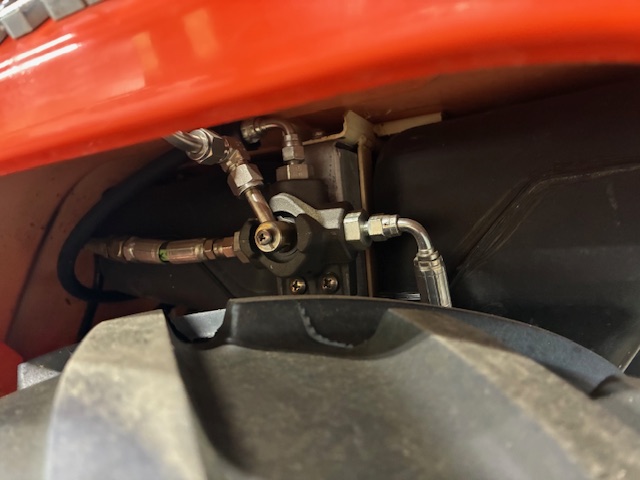

Thank you very much, but I need this space for the rear PTO clutch (and more hydraulics levers), so my lever has to go into the original position. Still playing with the position of the diverter valve. The original solution is ideal, but unfortunately price wise prohibitive. Very tight in this area, see picture.
YOUNGDRETTI was last seen on the forum 11 March. So slim chance we will get a picture from him.
The original label 79840-13240 seems still available in the US (not available in Europe any more), but shipping would be too expensive although it would fit in a normal letter envelope.
Now there is a thought: do you have a Kubota dealer near by and could order the label and send me a good quality scan or good quality picture of it? I would reimburse you for the cost and you would have the original label.
