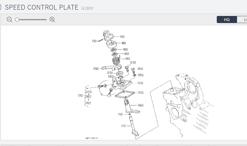

The stop solenoid can be broken, as long as its not retracted.
33,943
9,160
Pull the speed control plate first to see if that is causing the issue.
there might be a spring attached to one of the levers when you pull it out.
kubotafreak
Sep 20, 2018
1,049
397
Arkansas, US
Yup rack is stuck, be sure to note orientation of parts. They can be installed 180’ out. No need to remove throttle lever just pump.
