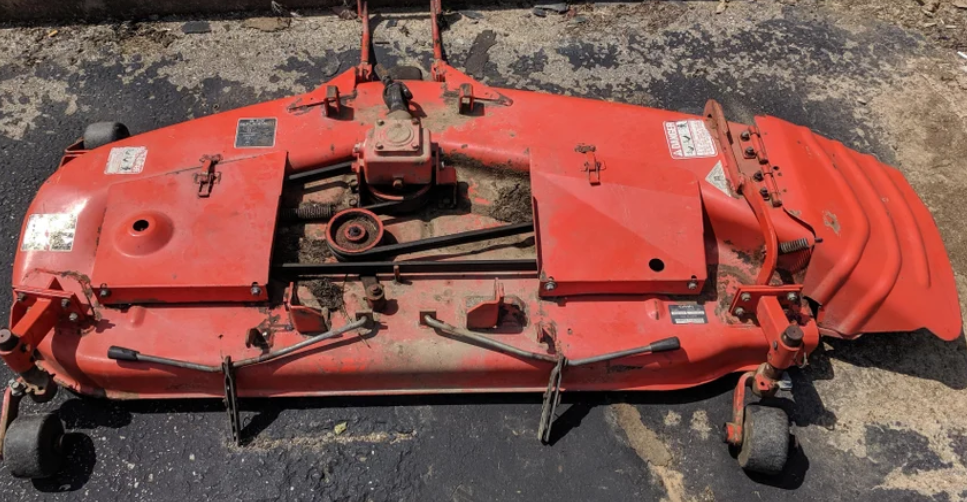

Is this what your 1800 deck looks like?

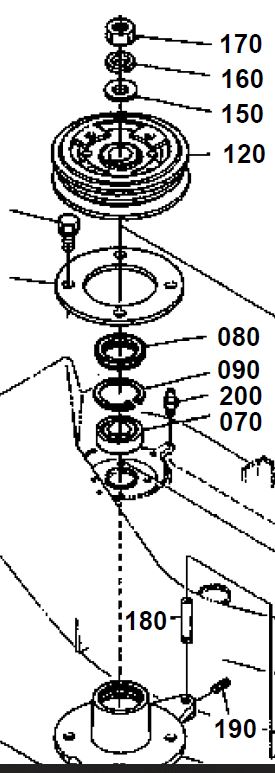

Here's a detail pic from the Parts List:
Not sure why they made the RH spindle different than the LH. LH is handier to grease because the zerk is screwed right into the end of the shaft, which is bored to deliver the grease to the bearings.
I'd be very tempted to get another LH spindle assembly and install that on the R side. Really, you just need the spindle itself. PN of that LH spindle is 76539-34550 if your deck's serial number is >=20001.
PN for the "Pipe Extension" (Part 180 in the diagram) that holds the zerk is 76539-34132. Part 190 in the diagram is a set screw, PN 03410-50606.
The grease is delivered to the same place on both RH and LH spindles - between the upper and lower bearings.

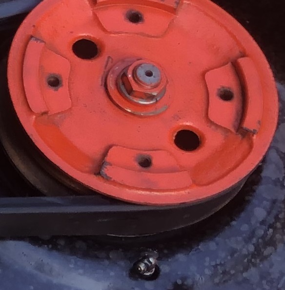

Just for reference, here's a close-up of the LH spindle on an RC54-G20 deck:
There's the zerk, screwed into the center of the LH spindle. Corresponds to the hole in the cover in the image that Nicksacco posted. I do not think there are any dimensional differences between LH and RH spindles.

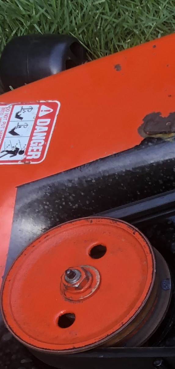

Heres what happened I should point out that when the deck came back after repair i had to weld on a post for the tension spring because that was missing.Following your indepth tutorial i could see on the spindle where the grease tube should be so stripped it down ...pulley off blades off spindle out planning to mark the hole for tube to go through only to find the grease passage had been filled and not recently.This led me to have another look at the shaft on the spindle only to find that all it needed was a grease nipple.Obviously i felt a bit of a goose but there you go cheers for your help
