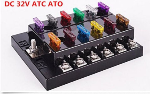

I replaced the whole block with modern automotive fuses in the L225 I sold.
