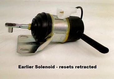

On older models (roughly through 2002) the solenoid's rest position is RETRACTED, allowing fuel to flow. With engine running, KEY-OFF activates it from rest to EXTENDED, cutting the fuel supply. A timer shuts it off a few seconds later - a spring RESETs it to the retracted position where flow is re-enabled for starting next time. Up to 2003 a solenoid like this was installed on 149 Kubota models.

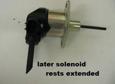

Starting around 2003 and operation was changed. The new solenoid's rest position was EXTENDED, blocking fuel. On KEY-ON it RETRACTS, allowing fuel to flow. On KEY-OFF its spring returns it to EXTENDED, the rest position, shutting off fuel (no timer involved). The difference was that active 12v power is needed to keep fuel flowing. This type solenoid is used in another 96 machines. (thx to Messick's for model counts)
Its another place to look when a rig won’t start or quits while running. Dick B

On older models (roughly through 2002) the solenoid's rest position is retracted, allowing flow. When running, KEY-OFF activates it from rest to EXTENDED, cutting the fuel aupply. A timer shuts it off a few seconds later, a spring RESETs it to the retracted position where flow is re-enabled for starting next time. Up to 2003 a solenoid like this was installed on 149 Kubota models.
For models in 2003 and later the operation is different. The solenoid's rest position is already EXTENDED, blocking fuel. On KEY-ON the new type RETRACTS against a spring, allowing fuel to flow. On KEY-OFF it goes to its EXTENDED rest position, shutting off fuel (no timer needed). The difference is that active 12v power is needed to keep fuel flowing to the injection pump. The solenoid below is the type used in 96 models. (thx Messick's)
Another possibility to keep in mind when a rig won’t start or quits while running. Sorry if I'm late to the party with this. Dick B
