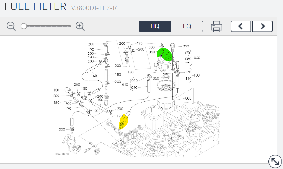

If your getting fuel to bleed from the injection pump input, then your issue is more than likely a problem with the stop solenoid.
Remove the fuel inlet line off the pump (yellow) and operate the primer (green) and see if you get good fuel flow.
You will need the WSM (aka service manual) to know how to test the stop solenoid for operation.
But start by checking fuses.
