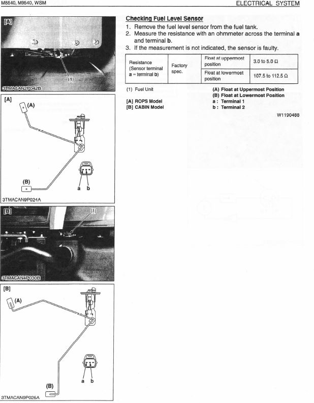

I have most of the M9540 manuals - here is the info for testing the fuel sensor - PM me and I will try to provide more info. The manuals are huge so posting them or emailing them in there entirety is probably not possible.
