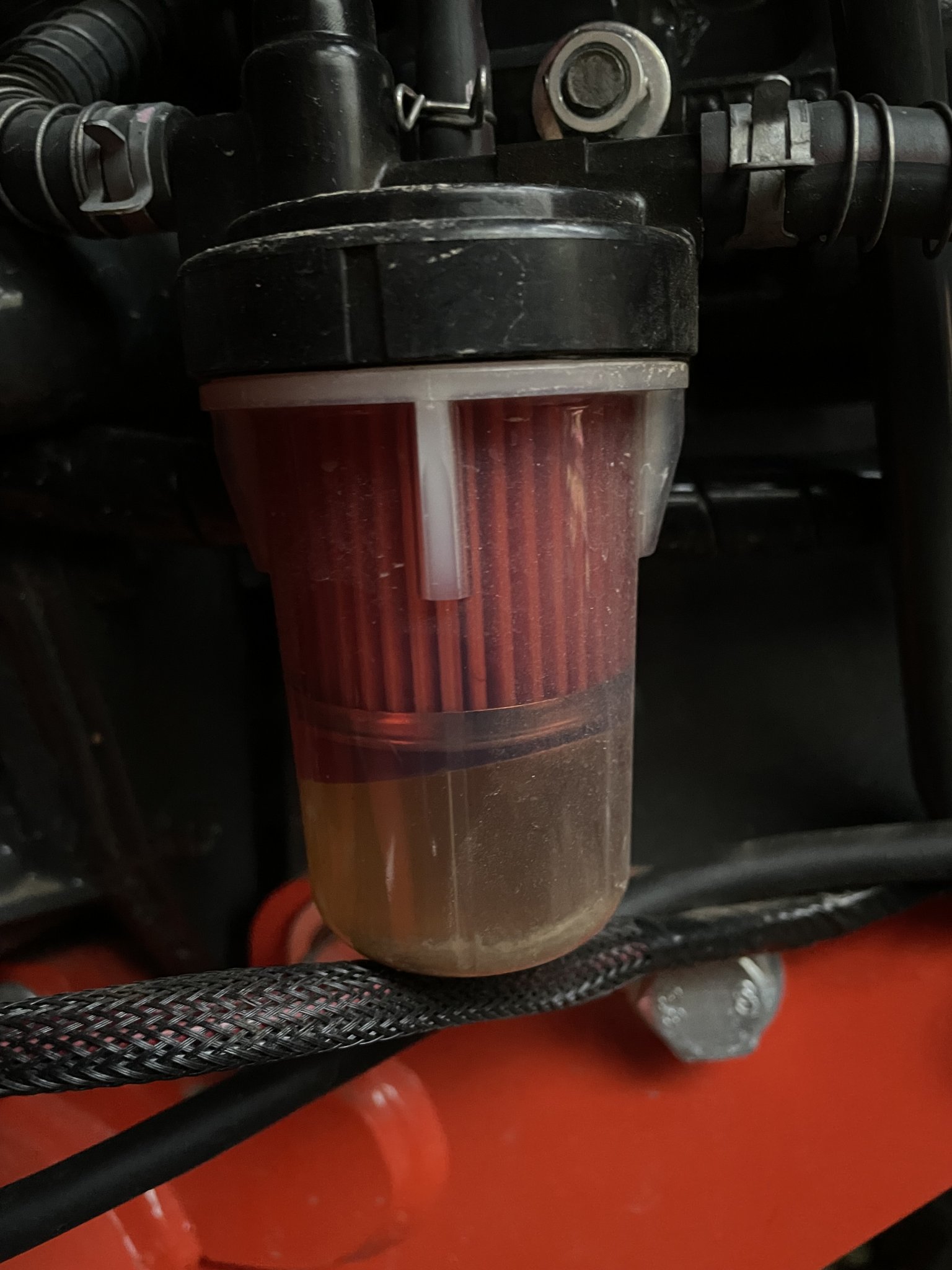

Hello,
I'm super new to my kubota and the forums. I have a B2601 with only 6 hours on it. I haven't even added fuel yet; still running on the tank it came with.
Today after a week on vacation, and significant cooling temperatures, I went out to look for the QR code to add it to the kubota app and I noticed this in the fuel filter (attached pics). Last time I ran it it was solid red, but not there is clearly something else. They say "red or yellow, never clear" and this looks yellow, but I know it's not diesel. What is this? Is it water? But it also looks like some kind of sediment at the bottom. I assume something needs to be done before I run my tractor? Thanks in advance for any advice.

Sure looks like water with some diesel floating on the top. No expert but I would drain it and pull the inlet hose and drain into a clear container till it all looked clean.

Diesel fuel is lighter than water, therefore what you see is water condensation with some fuel on top. The cause of this is a partially filled fuel tank and with dropping ambient temps water condenses. Make sure the fuel tank is full at all times.

6 hours? First thing I'd do is call the dealer I bought it from and tell them they need to correct that situation. Looks like a lot of water in the bottom.

This almost looks like bad/old biodiesel. The glycerol is separating out, thus being yellow and not clear like water. Also there’s a lot of sediment in the bowl for a new machine with only six hours.
Regardless you do NOT want that stuff getting into your engine! The tank needs to be drained/flushed and filters replaced under warranty.

It does seem like a lot of gunk for a new machine. That’s why I was so confused. A bit of water from condensation would make sense with humid cooling weather. But that doesn’t look like simply water. I guess just because it’s a new machine doesn’t mean it was filled with fresh fuel. I’d like to think the dealer wouldn’t set me up fir problems, but …
i emailed the owner and will call on Mon when they open. Guess I don’t get to play with my new toy this weekend.

Just because the machine is "new" to you... I suspect is has been around for some time. Thermocycling causes condensation within ANY unsealed container. (including fuel-tank, gearboxes....etc)
This is one reason it is a GOOD thing to run machines HARD. Get it good and hot for at least a couple hours to drive out the moisture within the gearboxes and hydraulic systems.
Your photos show that the water-separator is doing its job.... your job is to check/clean the when water is present. I see no need to make a huge deal out of this besides changing the fuel filters.
As you run the machine, any condensation in the fuel system will migrate to the water-separator for your viewing pleasure.
I ALWAYS add diesel-additive (Power Service Diesel Kleen) to my fuel tank when filling up. This increases Cetane, helps control moisture caused by condensation, and keeps injectors clean.
Power Service products are available at any WallyMart. You only need to add a capful to tractor tank.
I ALWAYS add diesel-additive (Power Service Diesel Kleen) to my fuel tank when filling up. This increases Cetane and helps control moisture caused by condensation.
So, the yellow liquid and sediment is just normal water from condensation? Not something more sinister? Just take it off, dump it, change the filter and everything is fine?
I got a winter additive, but didn’t think it is cold enough yet. Is power service diesel kleen something I get at the gas station, or a more specialized store?
I see nothing 'sinister'.... just water-separator doing its thing (it is clear for a reason)
There should be MULTIPLE fuel filters on your tractor. I would change ALL of them. As other folks have said, you DO NOT want crud finding its way into the injection system. This is the reason for all the fuel-filters.
That 'filter' you see in the water-separator is simply to aid in separating the water.... it is NOT the main fuel-filter.

Just talked with the dealer. I emailed him a pic. He says it’s not clear so I don’t need to be worried. They may have added road diesel (yellow) that didn’t mix with the ag diesel (red). He says I can go ahead and run it without doing anything. He also mentioned that new tractors can have some sediment as things from the factory get cleaned out. He had one with bits of plastic show up.
Does this all sound right?

We can only guess as to what the stuff is in your fuel, but I would drain it and save the contents. After careful examination, determine if the tank needs drained and flushed. When complete, take any and all contaminated fuel to your dealer and pour it in the tank of a new tractor in the showroom.
I have circled the sun more times than most on here and have yet to see any measurable amount of condensation, maybe I'm just lucky.

Diesel fuel mixes with diesel fuel. The only difference between red and clear/yellow diesel fuel is the red is dyed to make it road tax-exempt.
The clear fluid in the bottom of your fuel filter cup is not diesel.
Guess I also assumed he or warranty would cover any problems since I contacted him and I haven’t done anything to it since delivery. But, maybe worth confirming and I’d still rather avoid trouble than fix it afterwards.
The warranty will not cover any damage caused by fluid contamination.
If I empty the bowl, I have to bleed the fuel lines since that’ll introduce air, right?
You can simply unscrew the cup, empty it and reinstall it. The system has an auto fuel shut-off and will bleed itself through the small return hose on the top of the filter head.
This is the only fuel filter a B2601, contrary to what was stated to you earlier.

I did remove the cup and emptied it into a glass jar. The b2601 stops the flow, so can’t easily collect a sample. Then I rinsed the filter and cup with my ‘road diesel’ and poured that into a glass jar. It seems obvious that they are not the same. Also, when shaking the red jar it doesn’t even pretend to mix. It’s obviously water based.
i also noticed that the red diesel is a bit cloudy, but might be the sediment that was in the bottom of the cup.
After that, I filled the cup with fresh diesel and put it back on. Figured that way I wouldn’t get too much air in the lines. I’ll let it sit til tomorrow to see if anything else collects. If it’s clean, is it safe to start it up?
Is it better to run all the old diesel out and then fill with fresh, or fill with fresh before running to dilute any potentially bad fuel with good stuff? There’s a bit less than half tank left.
Is there an additive I should add to help protect in case something isn’t ideal with the old diesel?

When in doubt, toss it out !
Honestly WHY take ANY chances !!!
Drain 100% of the 'fuel' into cans. Pour some fresh diesel into the tank, drain that as well.
Then FILL the tank up with 'pump fresh' diesel.
NOW you KNOW it's 100% good diesel.
The cost ? Maybe $50 ?? and your time....
As for the questionable diesel,store some in a bog glass jar, check in a week to see if it separates into distinct 'levels'. I use old diesel to help start fires, kill stumps, etc.
