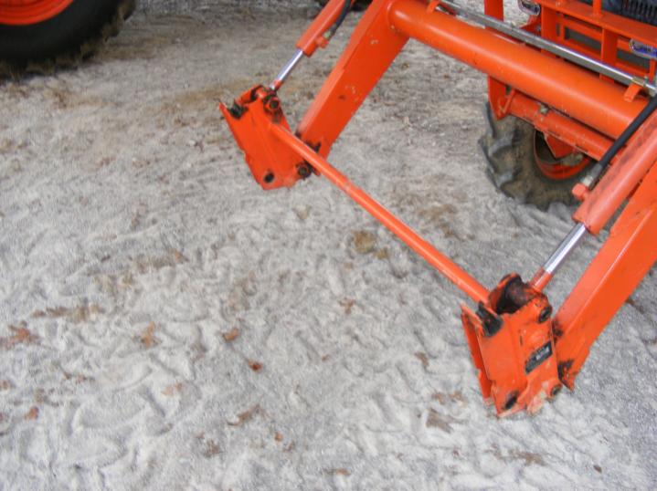

This may not be of any help but I'll pass it on anyway. I used to remove my loader from my L3000 all the time to mow and do gardens, ect. I bought a Kubota QA for the loader and now I only remove the bucket instead of the entire loader. It has been worth every penny.

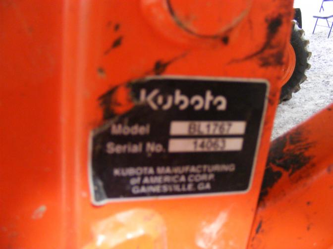

I considered the QA for bucket removal as one stated, but my dealer qote was over a grand $$ to do this so I opted for the weights.
This may not be offered for your loader but I would ask the dealer to be sure. I paid $300 for mine and it requires no modification at all. Take it home, remove the bucket and pin the QA to the loader. It's that easy. I haven't had to remove my loader since I put the QA on. Just pull 2 pins and drop the bucket, it was very well spent money to me.
