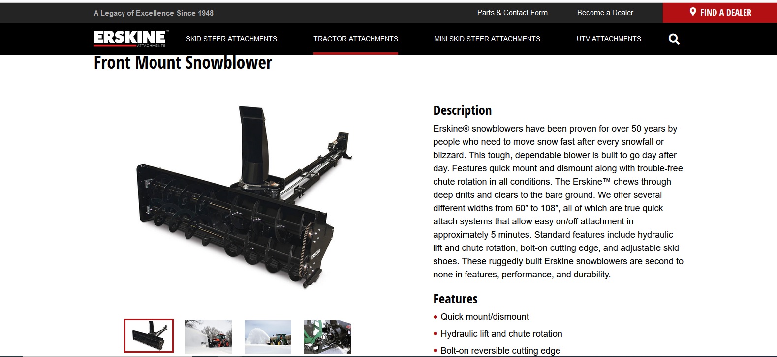

There is a product made by Erskine.
It is a front blower driven by the rear pto.
Erskine

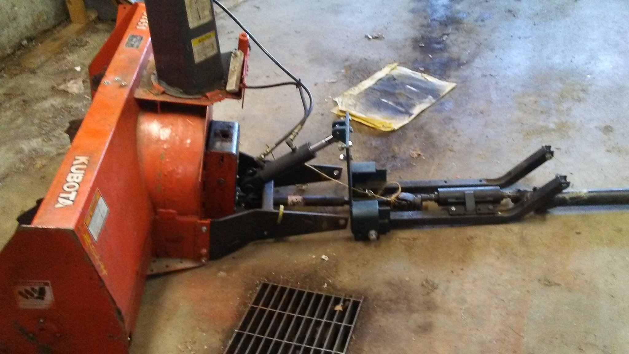

Kubota shows B2650 and B2651 for the B7300 HST. I did not try to figure out the differences.
B2650 is the snow blower. B2651 is the subframe.

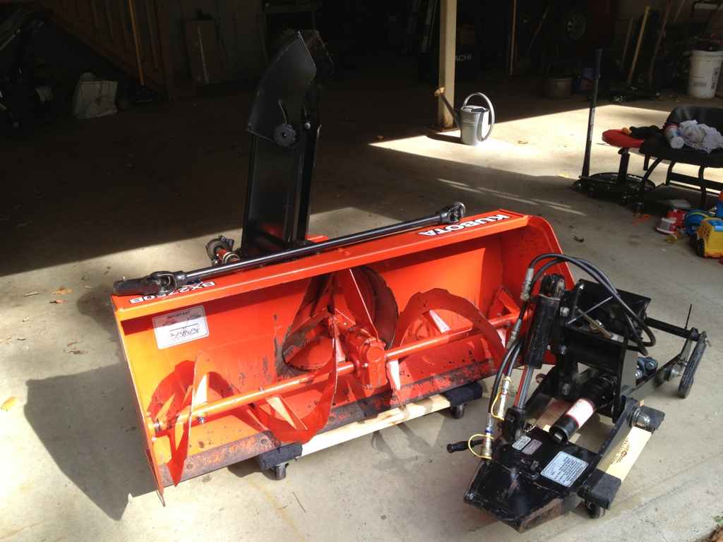

Looks like a B2733 or B2733a subframe will fit. Much newer design than the B2650 with B2651 subframe.
If you got a B2733 subframe then you could add a BX2750 snow blower. Much easier to find than the B2650. You would also need to obtain the correct pto driveshaft.
