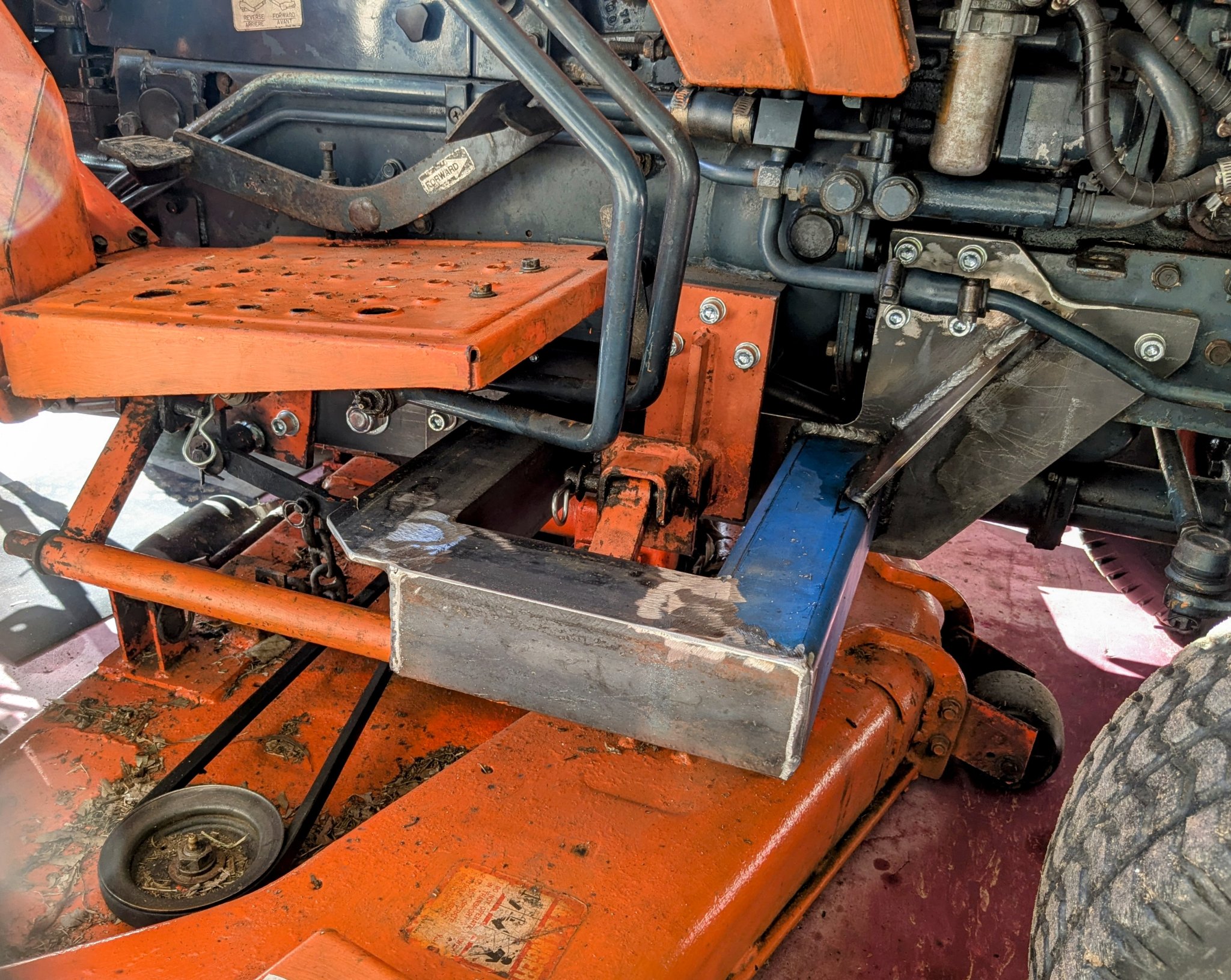

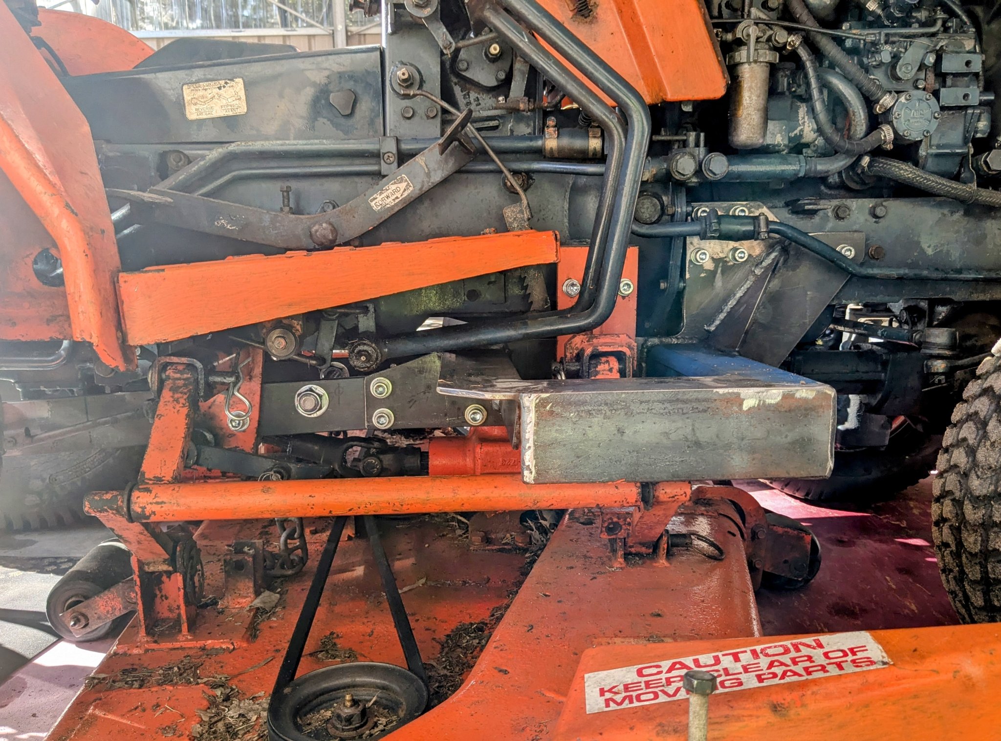

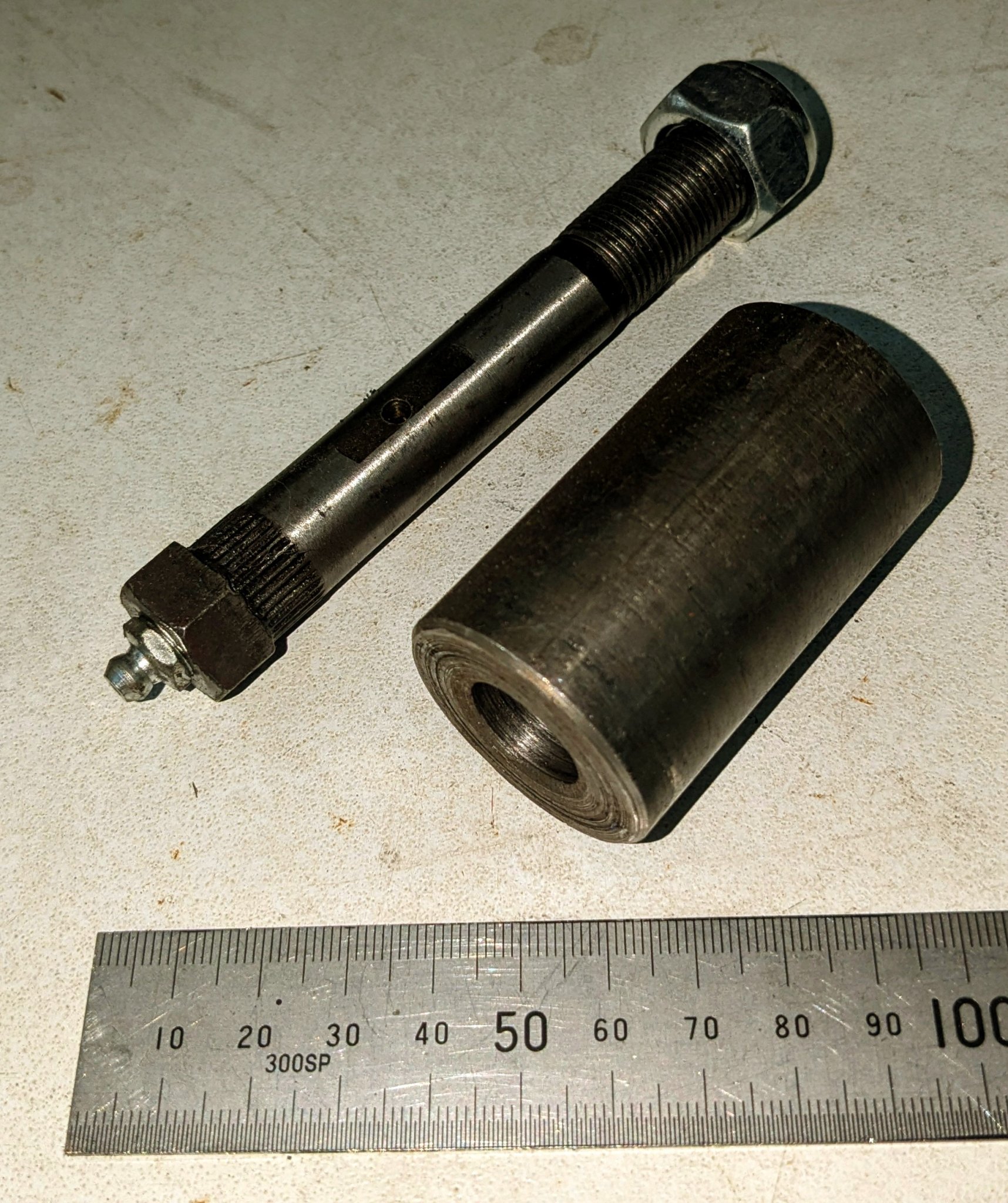

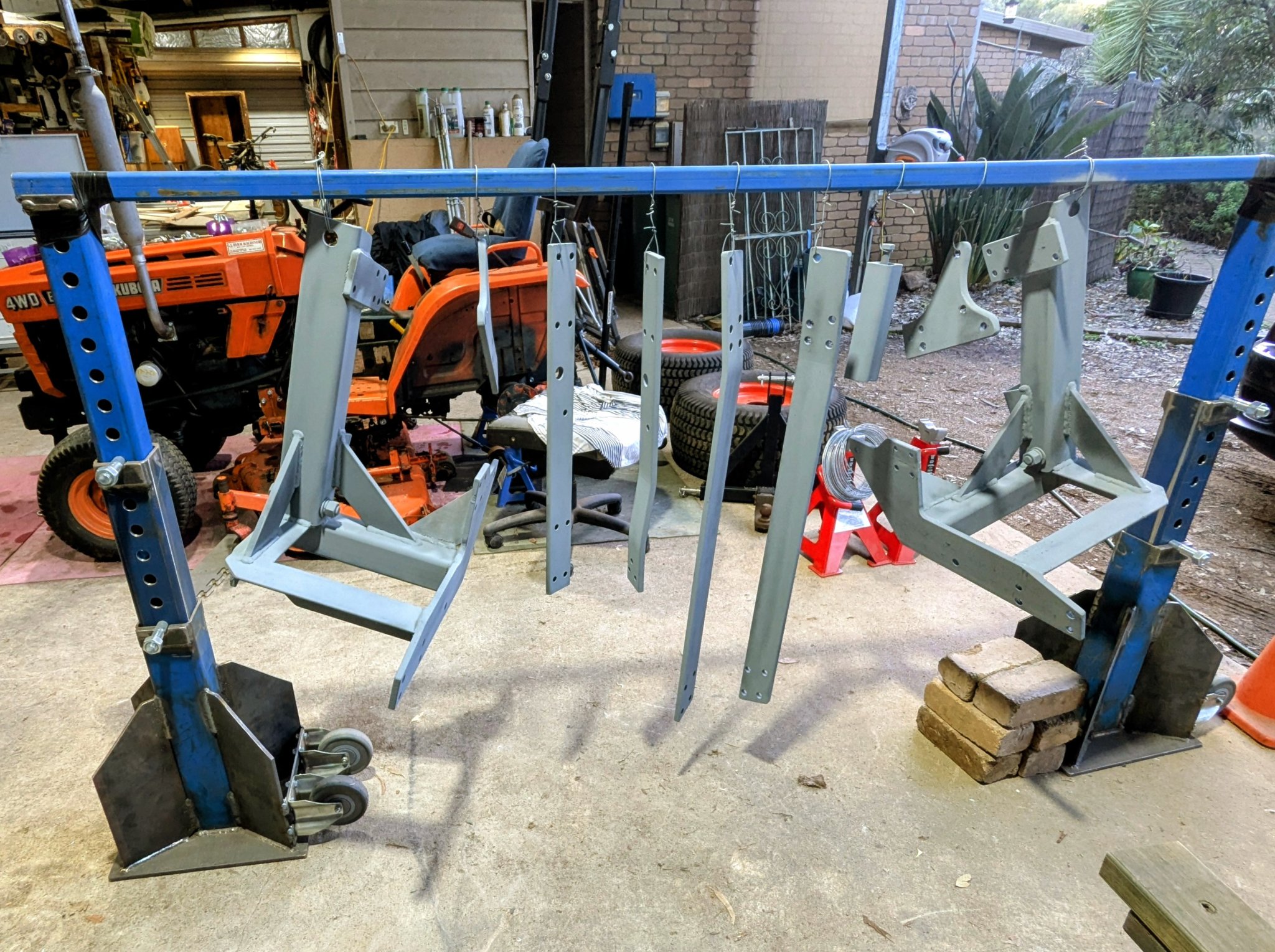

I'm in the process of building a front loader for my recently acquired B7200 and have a question about pins and bushes.
I've bought some steel bushes with greasable 5/8" pins that are normally used for trailer leaf springs (see pic). In loaders such as the B1630/B1640 would it be normal to use a greasable pin into a steel bush, or is there normally a bronze bush fitted as well to allow for wear and replacement ?
If needed, there's plenty of size in the steel bush that I could bore them out to fit a bronze bush and still have plenty of steel left to weld.

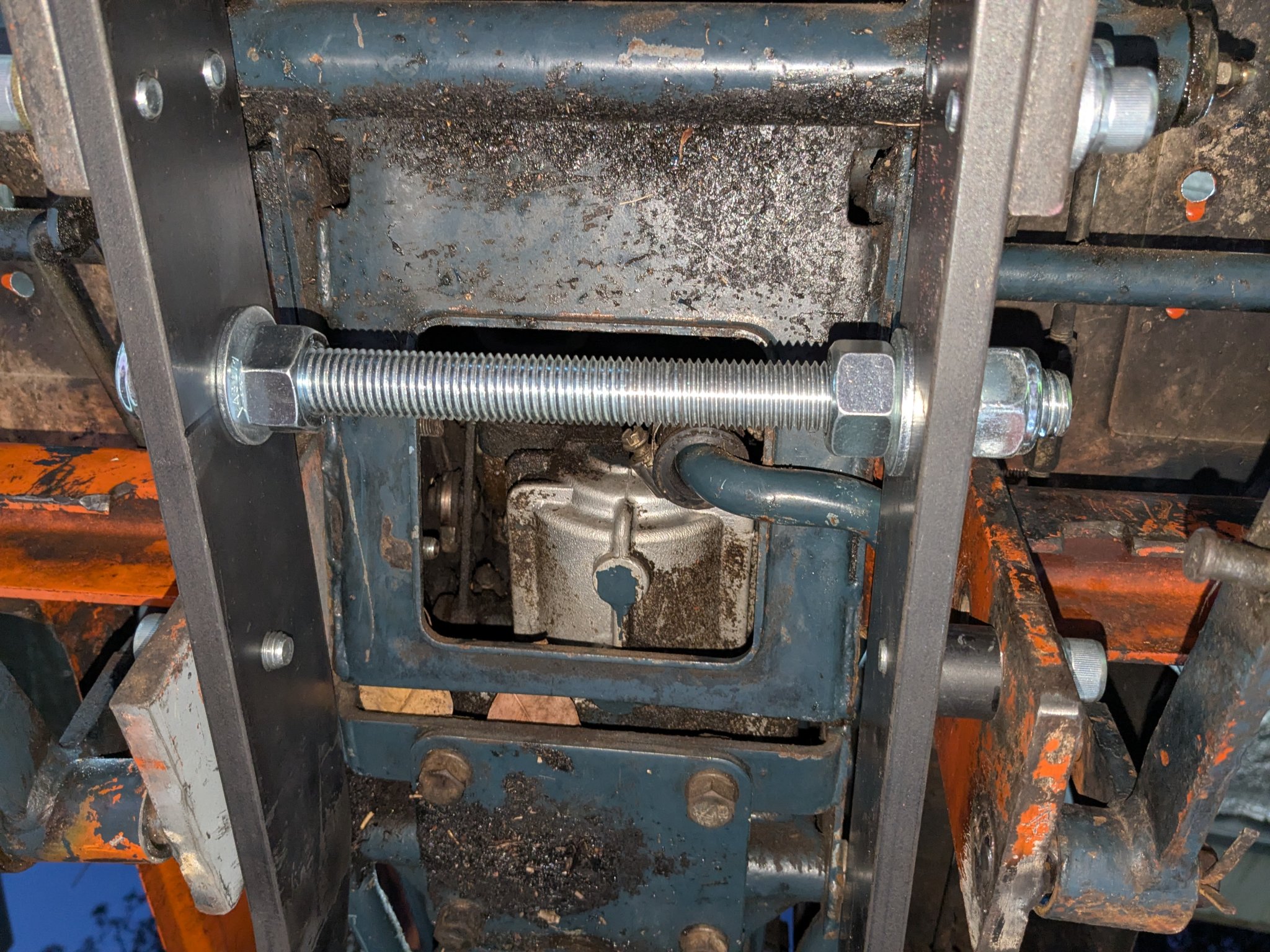

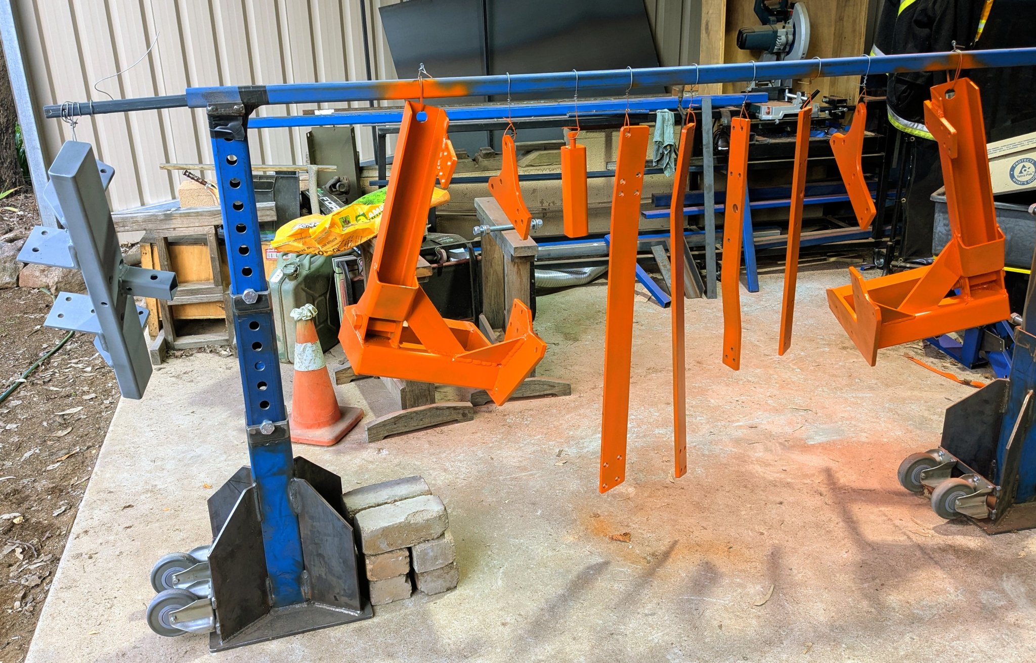

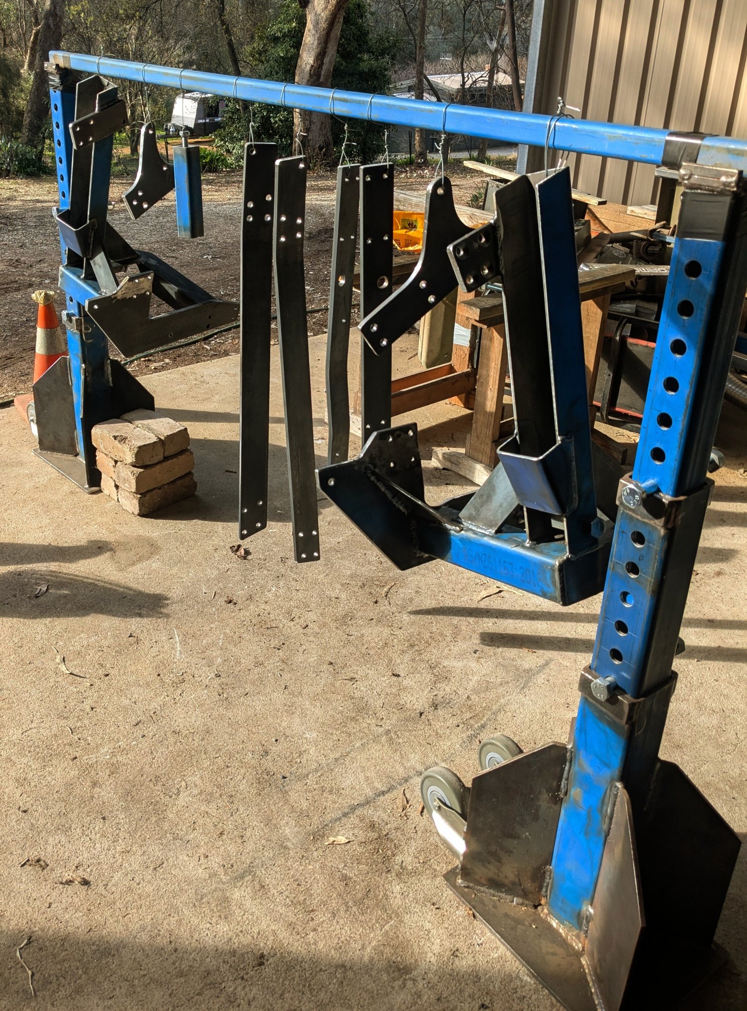

I've also attached some pics of the progress on the loader - so far I have the sub-frame mostly done, roughly copying the sub-frame in the B1640 loader manual.
I'm interested in your thoughts.
Thanks

My pins are considerably larger than that, but they are steel on steel. I'm pretty sure that's common on small tractors. I think that's why the lube interval is only 10 hours (plus, they're not sealed).

You want 1" minimum pins.
(Technically 7/8 but they are harder to find.)
5/8 is way too small.
Steel on steel no bronze bushings.
9,897
5,241
The B1630 had zerks on the cylinder eyes and ordinary 3/4" steel pins with a locking tab to orevent them from rotating. There were no servicable bushings - the pins were fit to welded in mild steel tubing. It used commodity welded cross tube loader cylinders with a 1.5" bore.
My advice - its a small lightweight tractor- resist the urge to over build.

On the TL720, the pins are nominally 30 mm. Many of them have the zerks recessed in the end of the pin, to protect the fitting I suppose. As @TheOldHokie said, most have bolts through tab retainers. I think this prevents the pin from rotating, limiting wear to the inner part

The B1630 was minimalistic. Here is a bottom bracket and pin. No bushings. No bolts. Just a 3/4" pin snd welded tab with one edge bent down. No significsnt wear in my 30 year ownership.
