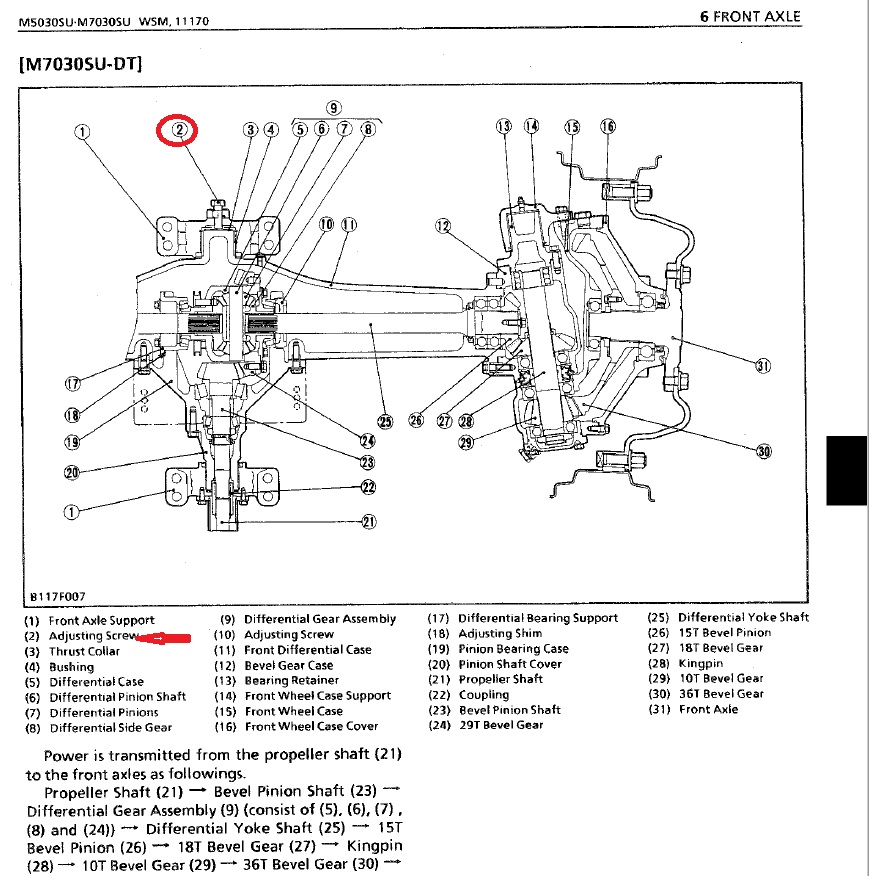

The WSM is scare on details but at the pivot point of the 4WD front axle there is an adjustment screw and lock nut.
No details are provided but that would be the first place I would liik for slop causing noise.
I will leave it to others to advise on oils. This info is usually in an Operators' Manual.

Everything in Dave_eng's photo spins (no lockin/out hubs) all the time. It is not under power until the 4wd is engaged. Since you say it makes noise in 2wd I would look hard at the external stuff firs.
