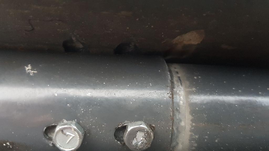

It’s amazing to me how a previous owner must have attempted to use a tractor for a bull dozer. :rolleyes:
My “lightly used” M4700DT is (once again) revealed to have been driven over brush/timber/what-ever. Around 400 hrs when I bought it and the hydraulic filter cannisters heavily dented, and wooden shards found on top of/underneath the metal floorboards, etc. No problem that....
But now, while investigating the front axle supports I noticed the sheet-metal cover-tube surrounding the front axle drive-shaft is worn-thru/paper-thin from the drive shaft wear-thru of the cover tube. The cover tube was pushed upwards slightly to create friction against the drive shaft.
This tube is a two-piece affair with the forward tube inserted into the aft tube at the mid-point. The fwd tube is the one worn-thru.
I used a pry-bar to pry the fwd tube back down into proper position thereby removing further friction. I’m thinking it’d be a good idea to keep dust/dirt out of there but reluctant to separate the front axle from the tractor only for swapping out that cover tube.... unless someone in this group has done this task and recommends it.
Otherwise, I think I’ll fabricate a half-tube (split a tube lengthwise) and hose-clamp it to cover the 3-inch long worn-thru area of that fwd tube. I’ll attempt a follow-up pic, but you guys get the idea. Comments are welcome and invited. Thanks.
You don't have to remove the front axle at all to remove the propeller shaft and the cover.
Remove the bolt, pull cover back, on propeller shaft coupler spin till you see the roll pin in the center, then remove roll pin and slide coupler back and remove propeller shaft and cover, repair and replace.
I see that now in the WSM. (I wish the Table of Contents of the WSM were easier to utilize.)
Thank you for making me see how simple that it really is!

My M9's are the same way. Kubota for some reason puts a soft splined coupler between the FWA output and the drive shaft that has a habit of wallowing out and needs replaced. Did my cab tractor last summer. Easy job, part is relatively cheap too.
The first Owner’s Manual I found listed the M-models to which it applied beginning with my M4700 as the littlest going up thru the M5400 and ending with the M9000... so they must be fairly closely related.

I believe the splined coupler is designed to be sacrifical. Much easier to replace a wallowed out coupler than the splined output shaft or the input stub on the front differential case. I actually bought 2, just in case.
You know when they 'let go' you can hear and feel it. I would imagine the failure rate is higher with a mechanical shuttle versus the hydraulic shuttle because the forward / reverse engagement is modulated so it's not an abrupt mechanical lock up. I do a ton of loader work with the cab tractor, spotting and loading round bales so lots of reversing motion and when doing bales in the field, I'm always in FWA. Same way with the round baler. I leave the pto at rated rpm all the time and start and stop with the shuttle lever so I'm always starting at 2100 rpm.

Just watch if your cover is binding at all on the shaft. Mine started rotating and the screws started to dig into the oil pan. Could have been a disaster. Made a very light woosh sound when driving around slow.
Well, that’s different! The covers on mine don’t have screws to connect them. The fwd one is s slip-fit into the rear one, and they each have a tab which is bolted to the sump to prevent their rotation.

Not sure i like the way this is made, as it could wear the oilpan in it got locked onto shaft. Should have a anti rotation feature.
