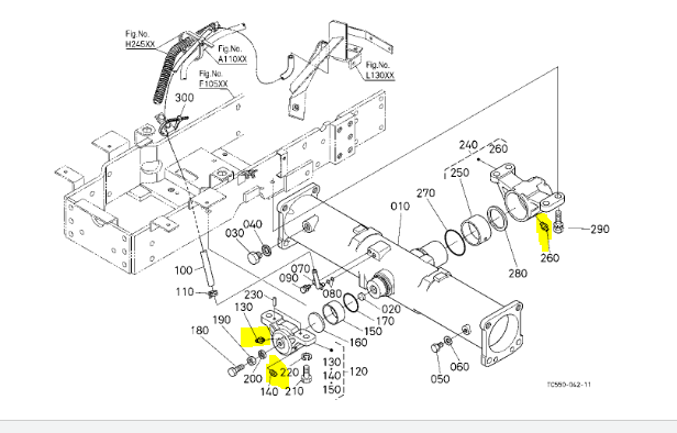

The owners manual says to remove the breather plug, apply grease till it overflows the breather port and reinstall the plug. Easy enough.
I only found one plug on the front pivot. The rear does not have one that I can see. Didnt think much of it at the 1st interval. 4 pumps in each and called it good. This time i started thinking. My wife says thats usually not cheap when i do. Lol.
My questions are....
1) is there a plug on the rear pivot?
2) if not, are the front and rear pivot bearings connected in some way?

My L48 has the same setup, breather plug on the front, none on the rear. I am just going to say the front breather is the only breather. Maybe open it before greasing the rear and then grease the front?
33,601
8,846
No plug on the rear, it vents via the propeller shaft seal, don't over grease it as it just forces grease up the tube.
The front has needs venting and if you do not remove the plug you can blow the O-ring seal out or worse yet crack the case.

Exploded drawings are great. Thanks for the posting.

That there is what I was looking for! Thank you @North Idaho Wolfman ! I figured as much but wanted to be sure. Most times I don't put but 2 or 3 pumps in any zerk anyway.
I appreciate the info!

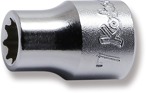

A couple of days ago I was greasing the L48. When I got to the from axle pivot grease fitting, I stopped to get a wrench to remove the vent plug. It is a 7mm square pipe plug, I guess. Unfortunately, when I tried to loosen plug, it felt like the open end wrench was going to slip and round off the corner. So I stopped and looked for a tool that would be more appropriate than an open end wrench.
Ideally, a 7mm 4 point square socket would be just the ticket. I spent way too much time on line looking for a 4 point socket, and also an 8 point socket in the 7mm variety, to no avail. I have no idea why someone would have tightened the plug gorilla tight, except that whoever. it was, must have had the right wrench.
Can anyone point me in the direction of a 7mm 4 point or 8 point socket? I have a few small standard 8 point sockets, 1/4, 5/16, and 3/8. I think they were my father in law's at one time.

But you have to oder two from here:
And if you want to be all pro like:

12 point triple square will work as well, if it is not extremely tight. Open end wrenches often flex too much on Uber tight fasteners.

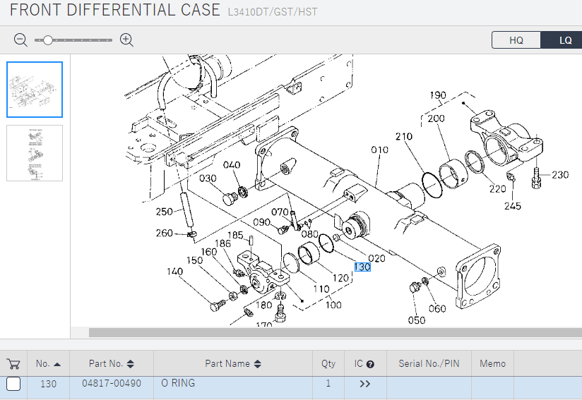

I think I may have blown my front oring by not removing the vent. I don't have a leak... yet. What kink of mess have I created?
33,601
8,846
Is a super easy fix, pull and replace it.

Is that a dealer parts look up , or are you on the web? I would love to be able to see more exploded views.
6,551
2,159
Illustrated parts lists are available on Messicks and Coleman’s website and also on Kubota website linked here
not sure what NIW is posting but it’s similar information
33,601
8,846
I use multiple sources but my main go to is the link Russell noted.
6,551
2,159
Perfect! I need to start using a PC more often than this phone.
I think the Kubota site is pretty friendly to mobile devices but the diagrams for older tractors do get pretty fuzz when enlarged so a PC is much easier than a phone.
