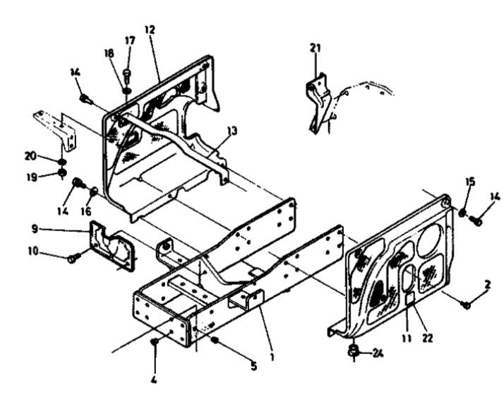

No, lift the front end, support the tractor, and pull the bolts holding the front wheel support frame (#1) from the engine and lower the whole assembly. Then you can pull the center pivot bolt & access the bushings.

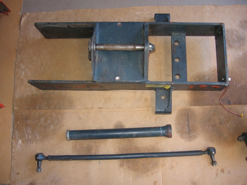

A couple of pics from my front axle rebuild- you won't have to teart it down this far.
