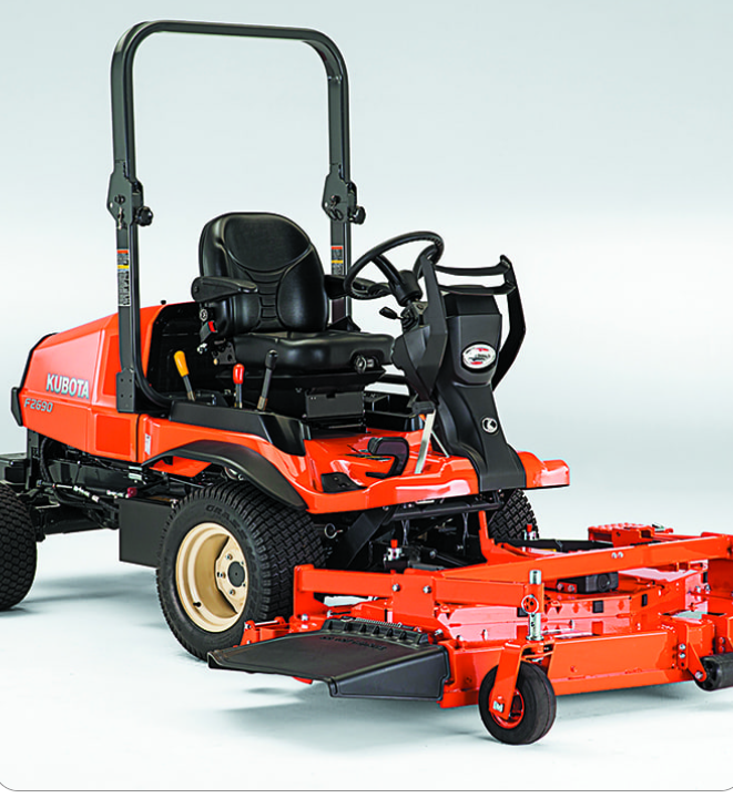

You can, it has to be real low and attached in front of and behind the axle
There was a stock kit to run a snowblower off the front years ago.
As far as a front three point you would have to make it up as Kubota never had that option for these models.
What you really want is an F series Kubota.
