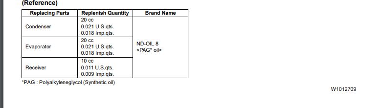

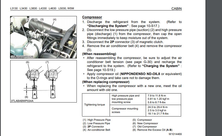

The ones I replaced, only one of the consumers asked for the old compressor back. The others I actually disassembled in free time at home studying their failures. One had a burned clutch, could have been replaced-customer wanted the new compressor. The others, the compressor itself was garbage, all exhibited the same complaint (squealing after running briefly). When the system is opened up, you'll also want to replace the dryer assembly which is the cylindrical part near the radiator. When you replace that, do it last--right before vacuuming the system, then pressure testing with nitrogen, then a final vacuum to at least 500 microns. If the compressor itself (not the clutch) has failed, you will have a high likelihood to have all sorts of junk in the rest of the system---lines, hoses, evaporator, and condenser. They'll ALL have to be replaced in order for the system to work properly and be expected to last.
And therein lies one reason a/c repairs are expensive. The other reasons are government regulation, and the tooling required. It will not be long until a license will be required to purchase HFC-R134A refrigerant. From a technician standpoint, we've got to stand behind our work or risk having to do it twice (the second time are our cost)--thus we ALWAYS recommend replacing the rest of the components that refrigerant touches if a compressor failure has occurred. If we don't do it, it comes back in a month or so, the customer is highly royally PO'd and he runs off & tells all his buddies how poor the workmanship was, perhaps one of his buddies is one of those greedy attorneys who says that because the a/c didn't work in his tractor, he now suffers from (insert your favorite) illness, and then files a suit against the company and the tech, potentially costing them more than a customer. This is the unfortunate truth to working for the public, and a sign of how litigious our society has become.
