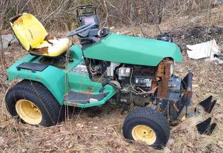

Considered various options and it really came down to finding a way to use that sweet little engine. Spent many a morning cruising Craigslist looking for a suitable candidate for an engine transplant. In the end, I wound up buying a John Deere 455 from an acquaintance. I'd been nursing that poor thing along with baling wire and bubble gum for years, but it finally succumbed to the abuse and barfed up the 3 cylinder Yanmar engine. We discussed rebuilding or replacing the engine some years back but there was no funding so it sat out in the weather for 4-5 years. I worked a deal with him and after selling off some stuff wound up paying $50 out of pocket for it:
As you can see, the plastic was completely trashed, but the tires held air and I had reason to believe the shaft-driven hydro trans was still functional.
