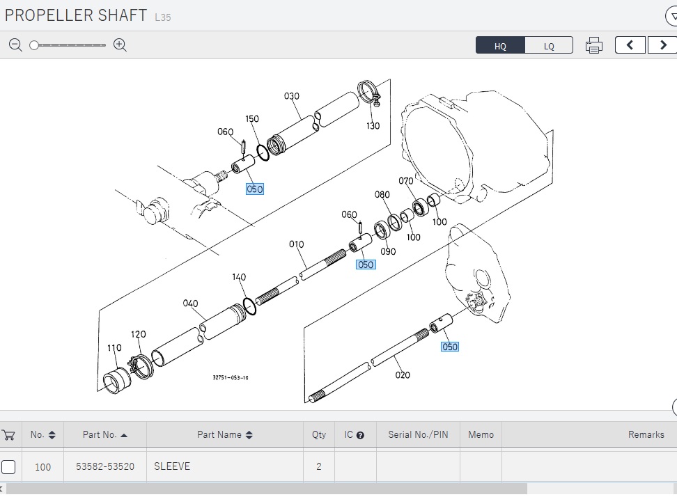

The L35 was (is) an amazing survivor considering the abuse they often get. Many are left in 4wd their whole life and simply wear out their tires and smaller parts.
One common thing on older 4wd's is the front driveshaft coupling splines get rusted and stop working. Take a quick look under there to see whether the outer tubes, shaft & couplings look right. It might be as simple as a stripped out 050 coupling - often the front one.
