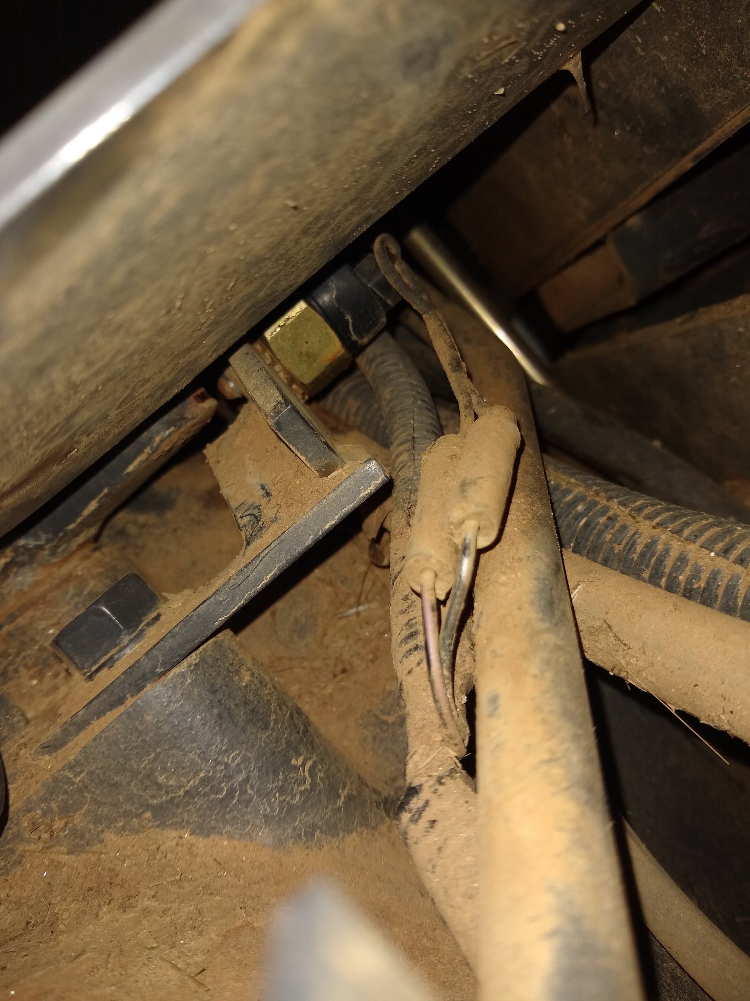

Well that did not go well. I could stick my phone in the access hole to get a picture but not so easy with a wrench. I only have so much time to mess with this so I drilled a hole over top the bolt, put a socket on it and took it out. I had to use a 3' pry bar to break it free even with a 10" ratchet. Doubtful I would have gotten it out without clear access so I was all proud of myself until I tried to pull the bracket. Apparently there's a second bolt that's tucked up under the shuttle shift linkage which is covered by the floor.
Aaargh.. First picture is the switch. Second is the bolt looking from the factory access. Third is the bracket with bolt removed and the fourth is the floor buttoned back up after I quit in shame. I bypassed the safety a month or so ago because I needed the tractor. I don't like operating that way but I'm not going to take out the transmission just to change a switch. Not sure what to do now now other than use it and be careful - does that make me bad?

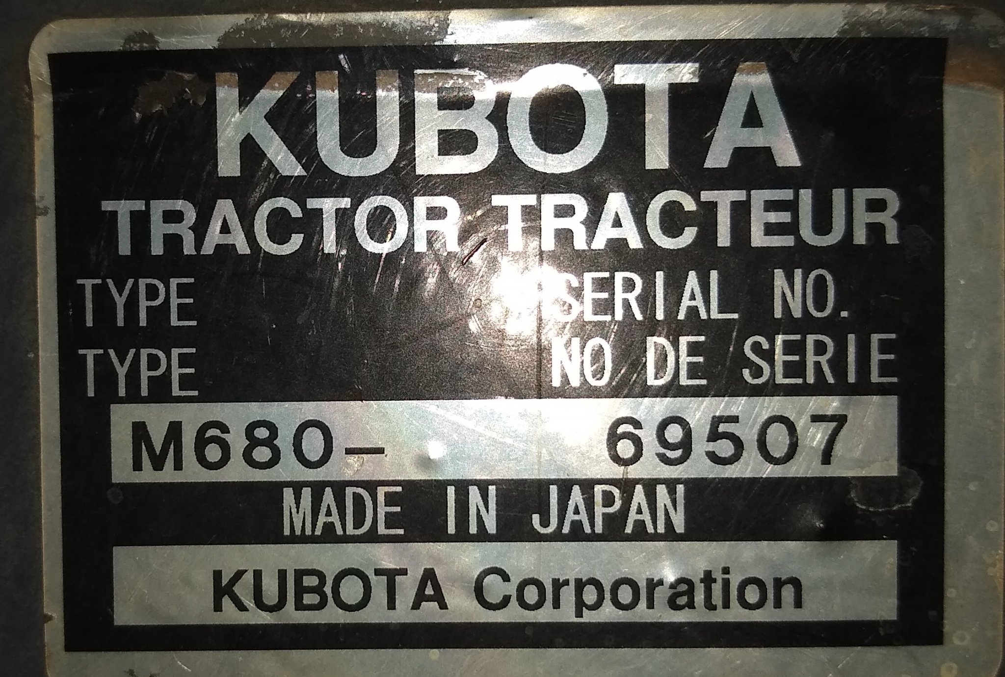

this is the label on the frame. I have a service manual for
M6800,M6800S,M8200,M9000. It says the serial number's first digit is 2006 manufacture.
