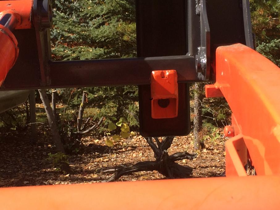

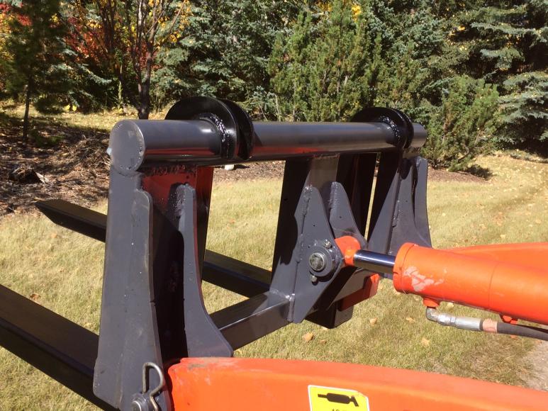

42" forks made from 4"x 2"x 1/2" rectangular tubing
Adjustable width
No quick disconnect - just copied bucket attachment points
Appears to be able to handle all my little hippo can give them
14,213
2,871
That should handle anything you little beast can lift Im sure
