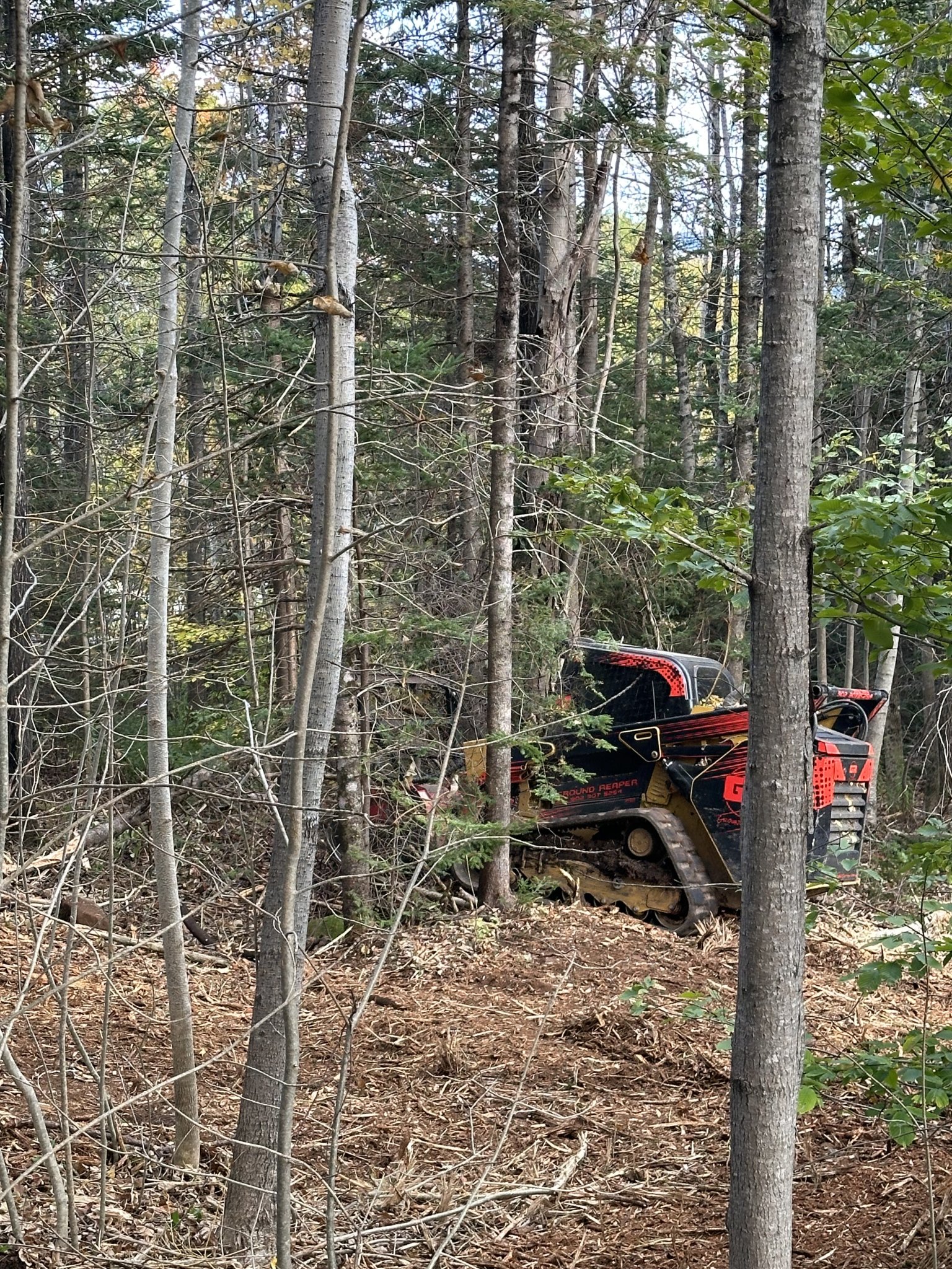

My agency never bids woods work by the hour. That’s almost giving them a blank check. We ask them to bid by the acre and they are invited to walk the project area before bidding. We also break up the area into payment units and they cannot start work in a second unit until satisfactory completion of the first unit. That way the contractor gets paid quicker and we don’t have disputes if they walk off the job and default the contract. A fair system for both parties.
Agreed, NEVER by the hour. Depending on the company, the operator may or may not be very efficient with their work. This one company who quoted my neighbor said $2750 per day, per machine. They can get one acre per day for each machine running.
Many of our contracts are for around $1200/acre. Of course the work is quite variable in different areas, so there is a wider range from $900-1800/acre. But the vegetation in your part of the country is different, so a higher range might be appropriate. The only way to determine this is to get multiple bids with each bidder walking the site prior to bidding.
