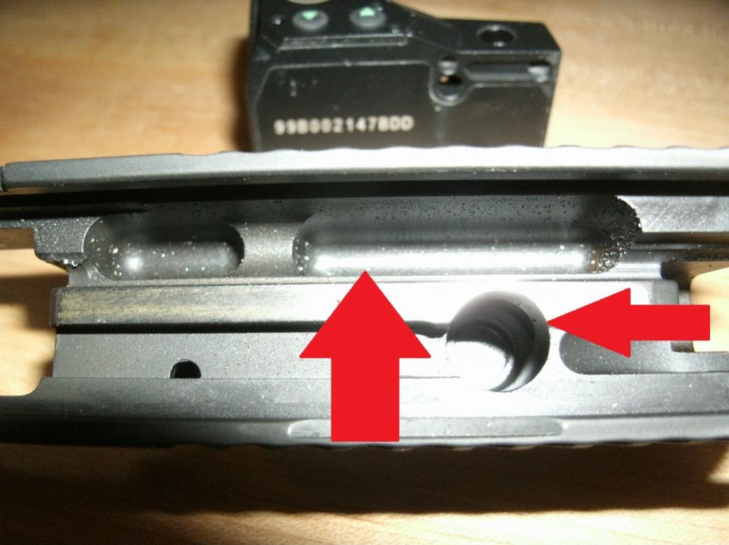

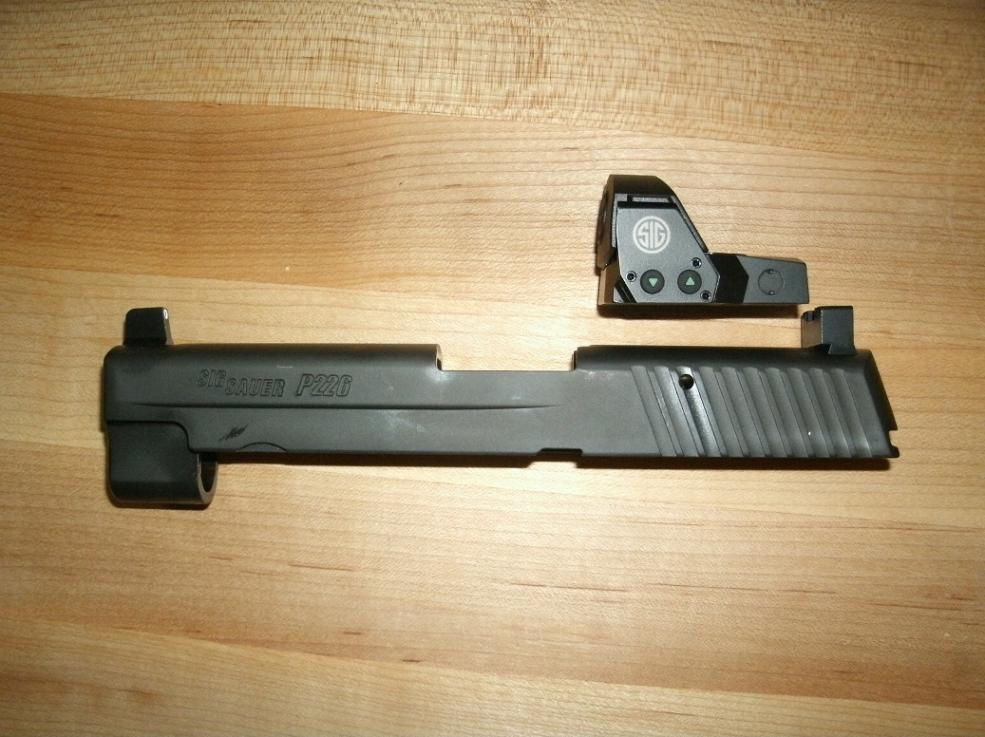

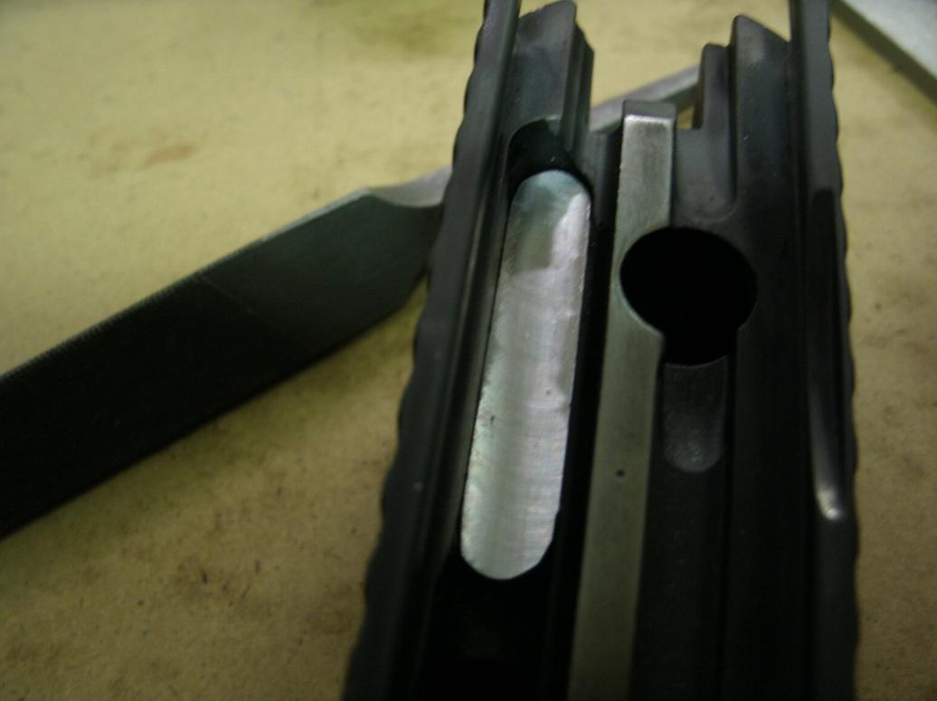

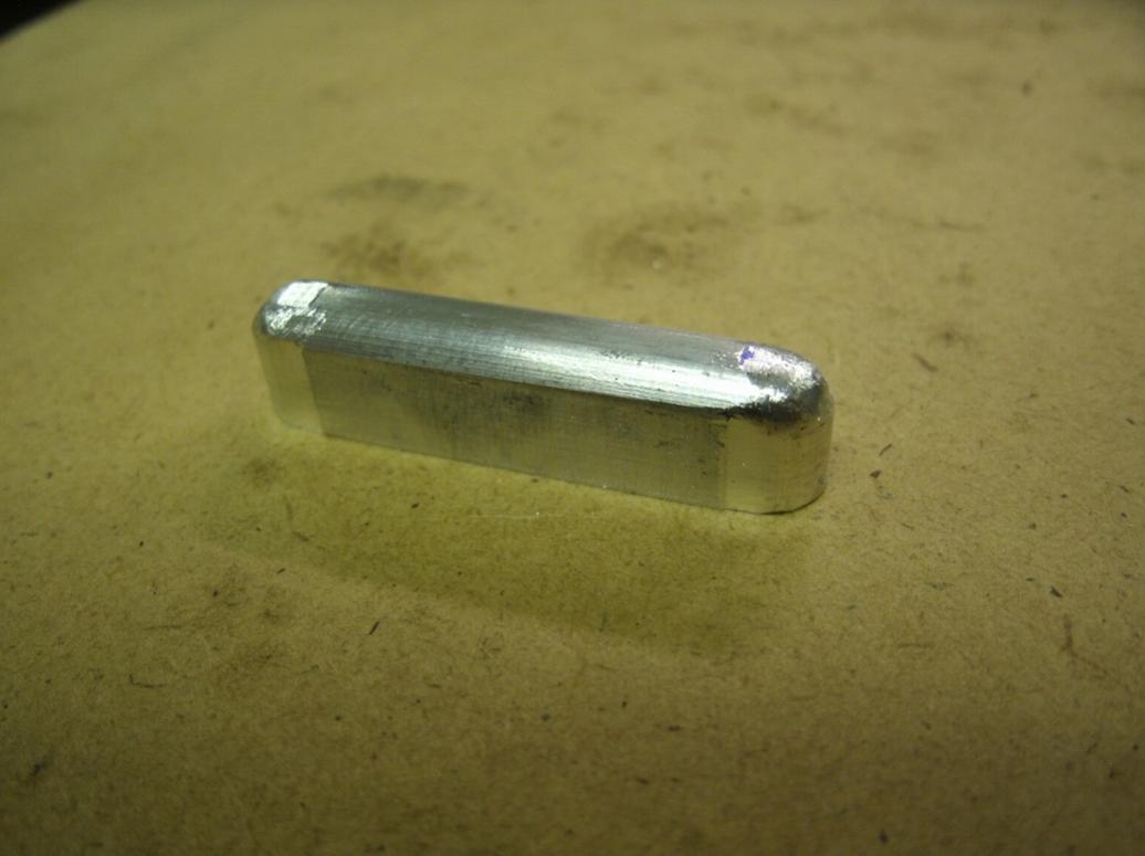

Going to install a red dot sight on my Sig P226. But it comes with some challenges, mostly with the milled pocket for lightening the slide weight (pic 2, vertical arrow) just happens to be right where one of the screws for the sight has to go. So my plan is to make an insert out of aluminum to fill the pocket(pic 3 and 4) so it will press into the slot. I added a little red loctite to secure it for the milling and tapping operation to follow. The plan is to mill down just far enough so the insert is exposed but not so far to allow it to pull out. Once drilled and tapped, the sight screw will hold it in place. More to come tomorrow.

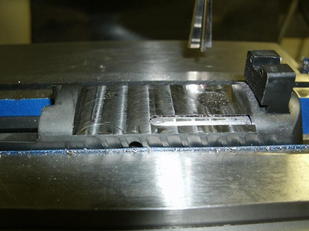

The first pic is showing the milling of the slight dovetail that is built into the sight. I wanted the sight to slide in without force because there has been some broken glass issues on some earlier models. I got it to .005" play back and forth and felt comfortable with that. Time will tell, but these things are fairly new and there is not a lot of info out there that I can find on installations. The second pick is the finished product including trying some stainless blackener. I didn't take any pictures of drilling or tapping because I didn't want to break my concentration at this critical stage (See post #2 by Bill). Pic three is the sight installed and you can kind of see the slight dovetail on the sight. The last two pictures are my attempt to show the red dot co-witnessing with the taller suppressor sights that I added earlier.
