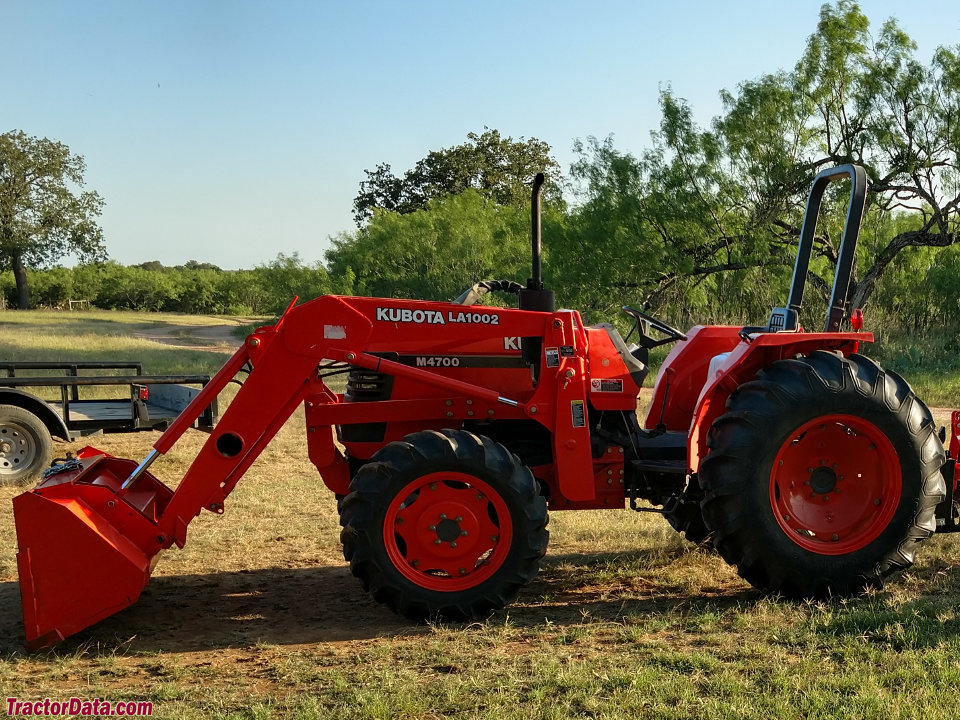

This is exactly what I did to AVOID emissions issues and found TWO M-4700’s within 20 miles of my home, each for less than $20K and each with less than 500 hours on them. I bought the $17K one without the grapple (probably an error since it was only $2K more)... but the ONLY thing I’ve had to do since was buy an alternator ($80) and butt-splice repair a couple mouse-chewed wires. (15-cents...I figure the mouse is what caused the alt to fail.)
Three years later... still NO problems with this tractor, it’s a real hard-working utility tractor with NO DPF, no emissions controls or electronics to trouble me.
Three years later... still NO problems with this tractor, it’s a real hard-working utility tractor with NO DPF, no emissions controls or electronics to trouble me. View attachment 51437
That’s a really pretty rig you found. Looks like it was kept inside and well cared for. If you can find something in that condition for a reasonable price I’d agree it’s a good option.
