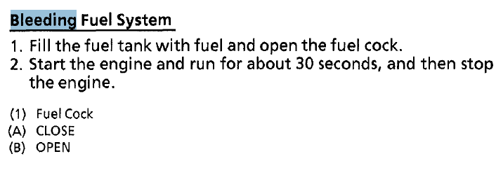

Is bleeding the fuel system what you mean?
Run the engine for 30 seconds then shut down, as per wsm attached? The engine barely runs when started, and I can do that...and that and bleeding the steering is the only bleeding I can find when searching the WSM.

Can anyone comment about how to "bleed the injectors" as suggested.. I searched the entire PDF service manual for the term bleed, and the attached is all I found related to fuel.. I see other posts about opening some kind of port on the high pressure pump.. but I also notice folks messing up that $1000+ pump so I would want to be very careful before I start messing with that.

I searched and searched in the factory service module for any method to "bleed the injectors" and for this model B2100 there does not appear to be any procedure in the manual.. just what I will attach for the second time that you are supposed to do when you change the fuel filter.
