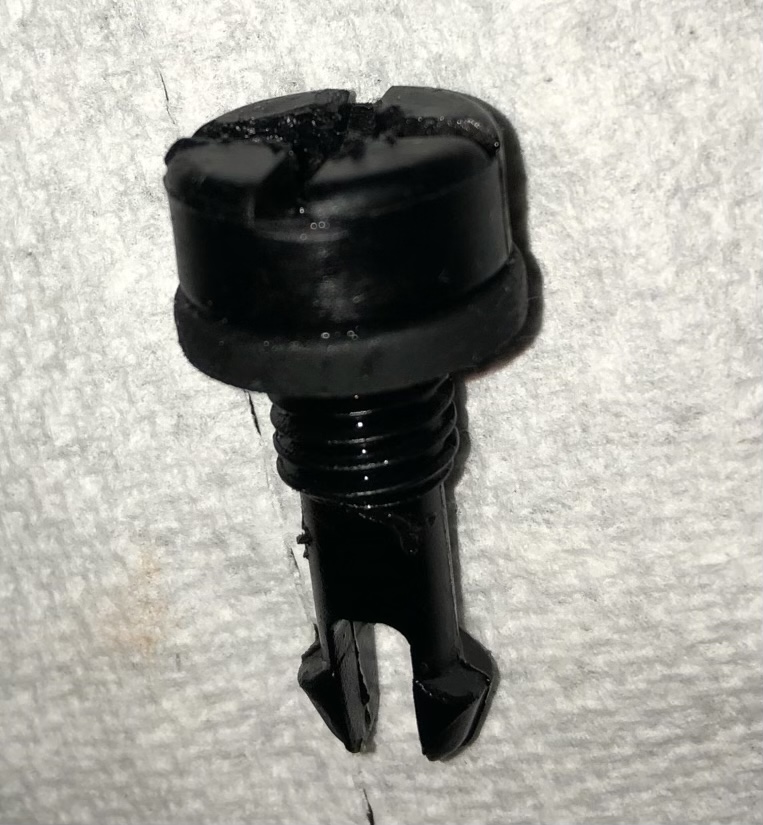

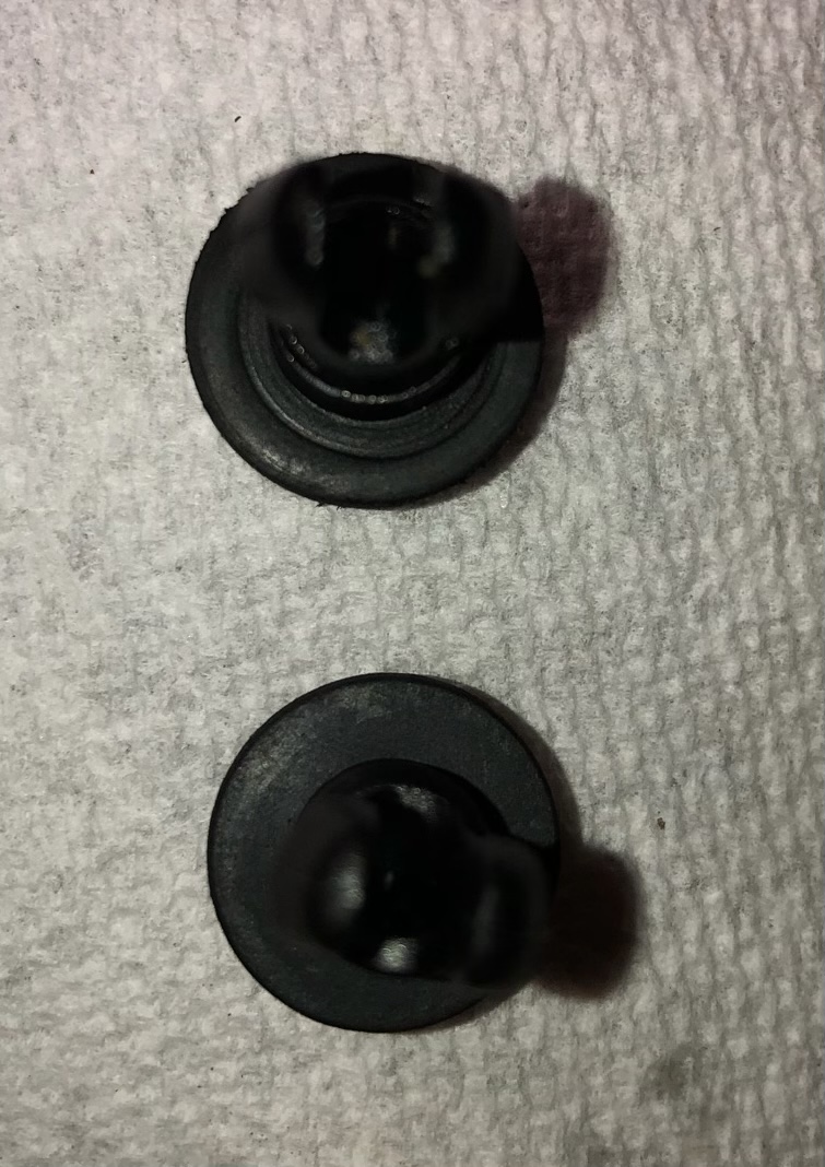

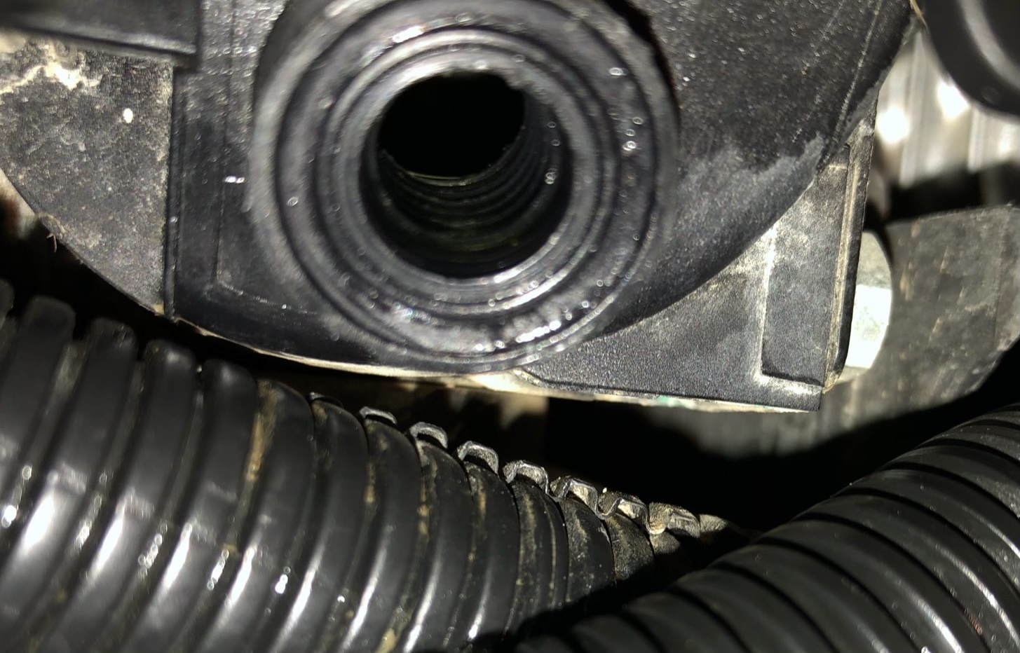

I’ll let others speak to your specific question, but when I did this about a year ago on my 3301 (so likely similar parts, but check), I found the radiator plug (if used to drain there) should be replaced - not reused. You can see how where the two mating surfaces come together, it cuts into the gasket and it’s unlikely you’ll make a good connection again if reusing that plug. Shown here are the used plug and the one I ordered in when I couldn’t stop a slow drip. Later I saw where others were said to be disconnecting a hose instead but I was already past that point.

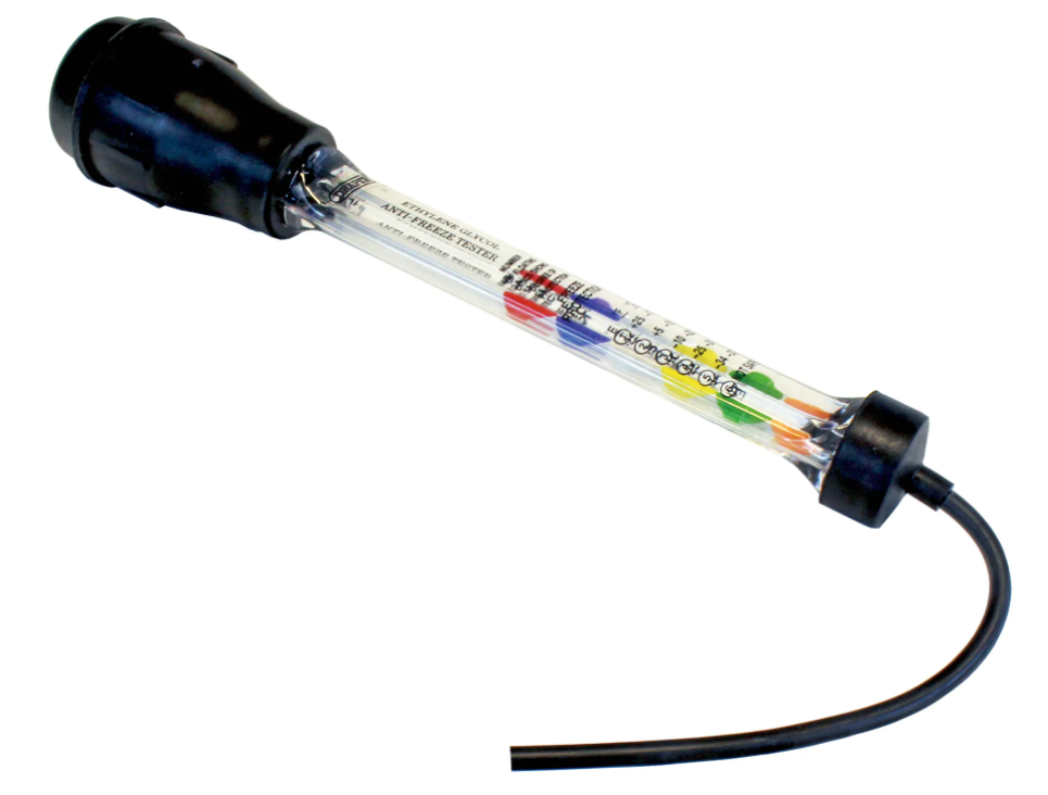

The best tool is to either check via a volt-ohm meter or do a density test - both will tell you what is good and not good about the ratio.

I would pick up a cheap tester to give yourself piece of mind too.
View attachment 55450 View attachment 55451 View attachment 55452
Never remove this plug, ours stripped off and it was an ordeal to replace it, just remove the lower hose to drain

Hydrometers are useless for measuring temperature protection, you need a refractometer. I took an auto repair class at the local community college, they had a dozen hydrometers to demonstrate that none of them worked, they weren't closer than 10 degrees.
