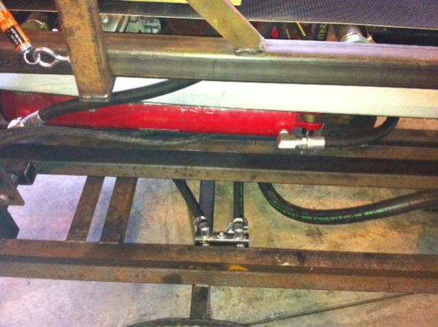

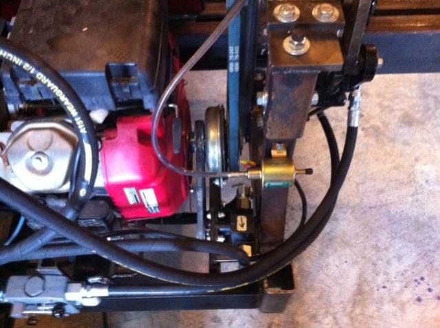

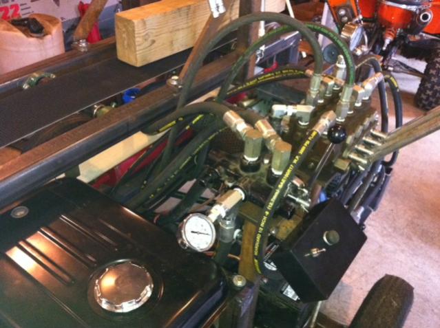

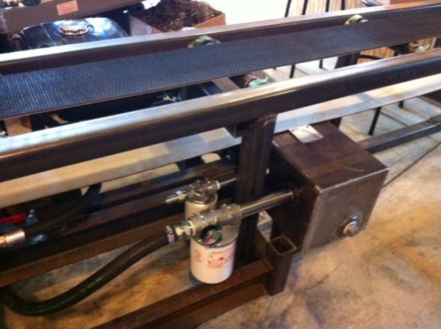

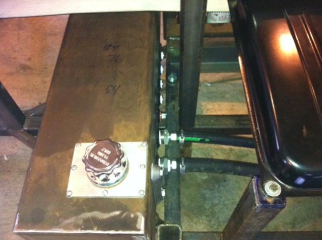

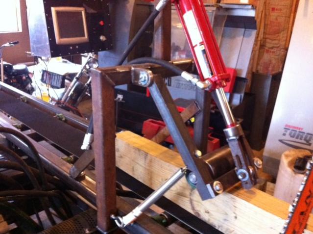

Worked all day on the processor and have everything finished except 2 hoses and a section of return hose
Back to Surplus Centers website to order again
Heres some pics I took today:
Not the best pictures but something to look at
