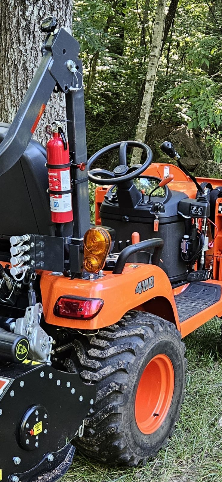

There are many roll bar fire extinguisher mounts made of nylon webbing and Velcro sold on Amazon. I bought one a couple of years ago and mounted to the ROPS. It was cheap and took less than a minute to mount it. Of course it can also be easily moved. It has stayed attached and never fallen off.

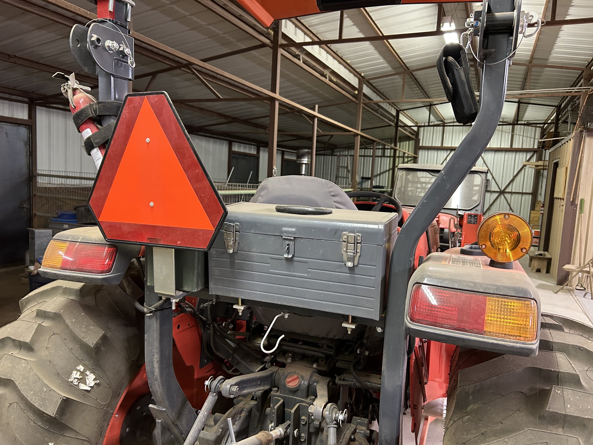

Which model tractor do you have? That must be a Craftsman toolbox. I'm wanting to do that with my soon-to-be-purchased L3902.

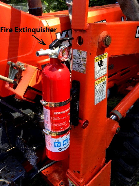

Mounted on a Quick Detach fixture. View attachment 139305

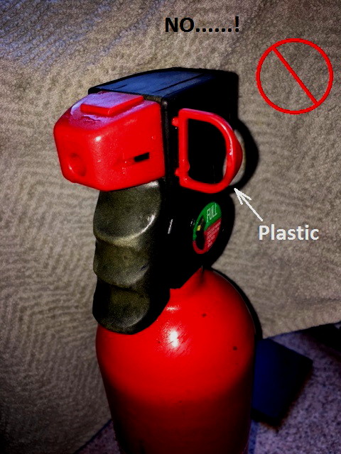

That extinguisher appears to have plastic firing grips.
A very bad idea!
The plastic grips have been known to break .....the ONLY time that you really need the extinguisher.

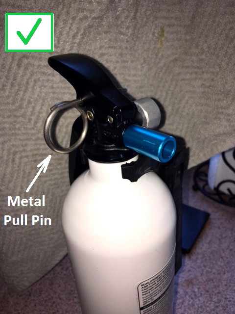

Note that "Lil Foot".....post #3, has the metal grip style, that everyone should hav.e.

MX6000. Yes it is an old craftsman tool box. I just removed the useless plastic tool box, and I put a plate of steel inside the toolbox to back the thin box metal then drilled the holes. It’s basically fastened with a u bolt on the ROPS crossbar. And I had room behind the SMV sign to also mount a small ammo box. I use that as a glovebox for small items. I did have to use a small flat bar of steel to extend the SMV sign further back to make room for the ammo box.

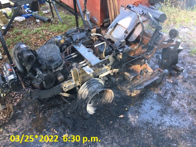

Have never had the handle itself break but my Scag Tiger Cub (Zero Turn Mower) burned to the ground because the 'plastic' Pull Pin broke off flush with the unit when I grabbed it to put out the fire.

I rest my case, with plastic part fire extinguisher release mechanisms !
No argument from me. Personally never seen a ' handle' break or heard of that happening, though I'm sure it 'could'.
The 'pull pin' on the other hand is a just a 'jammed extinguisher' waiting to happen.
