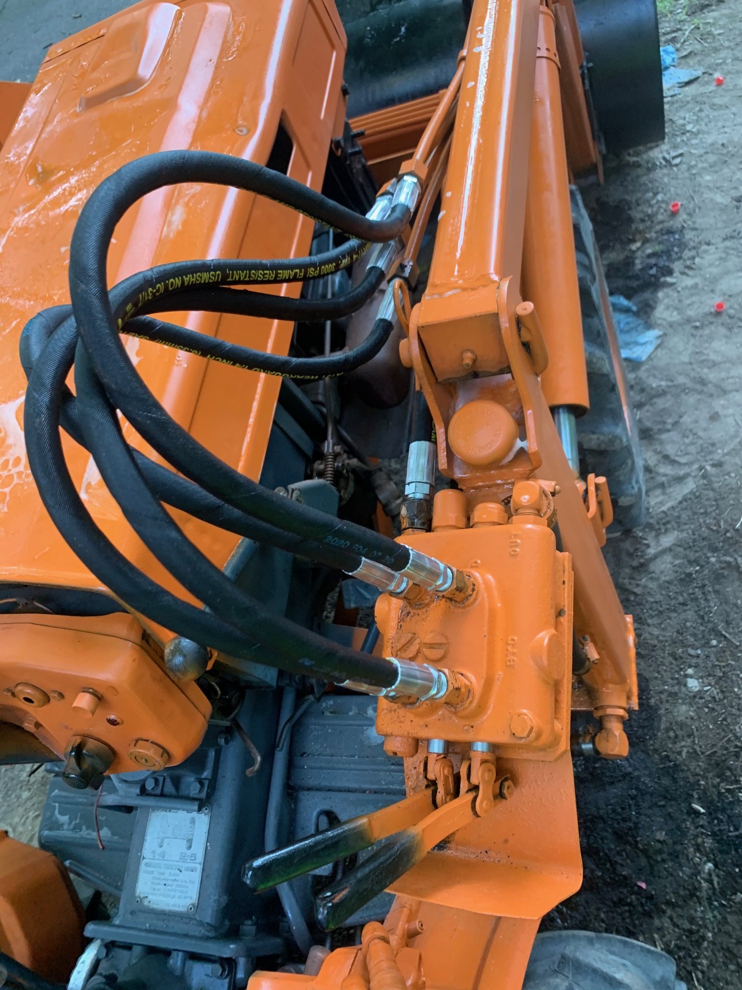

To identify where the problem originates, swap the two boom cylinder hoses and see if the problem moves.
If it does then the problem is in the loader valve.
Post a photo of your loader valve please.

Do not bother to change any hoses.
What strikes my eye is this............
The tractor is just sitting with both valves in their neutral position.
Look at the length difference in polished spool surface showing near the base of the two valve handles.
It looks like the boom spool is less out than the bucket spool.
Further, the bucket control lever is curved backwards.
Could the travel of the boom spool be limited in the lift position thus weakening the amount of lift.
Dave

The boom (left valve) has a float when it is fully pushed forward, I think that is why it is out slightly more. The bucket (right valve) is bent and operates fine.
The machine struggles curling the bucket under weight and lifting the loader under weight. Both can exert quite a lot of force in the opposite direction for down pressure, to the point lifting the machine completely off and no loss of pressure.

Dave_eng, with all the fresh paint on the machine I wondered if the difference in shiny shaft is simply paint. The one valve having a float position also makes sense.

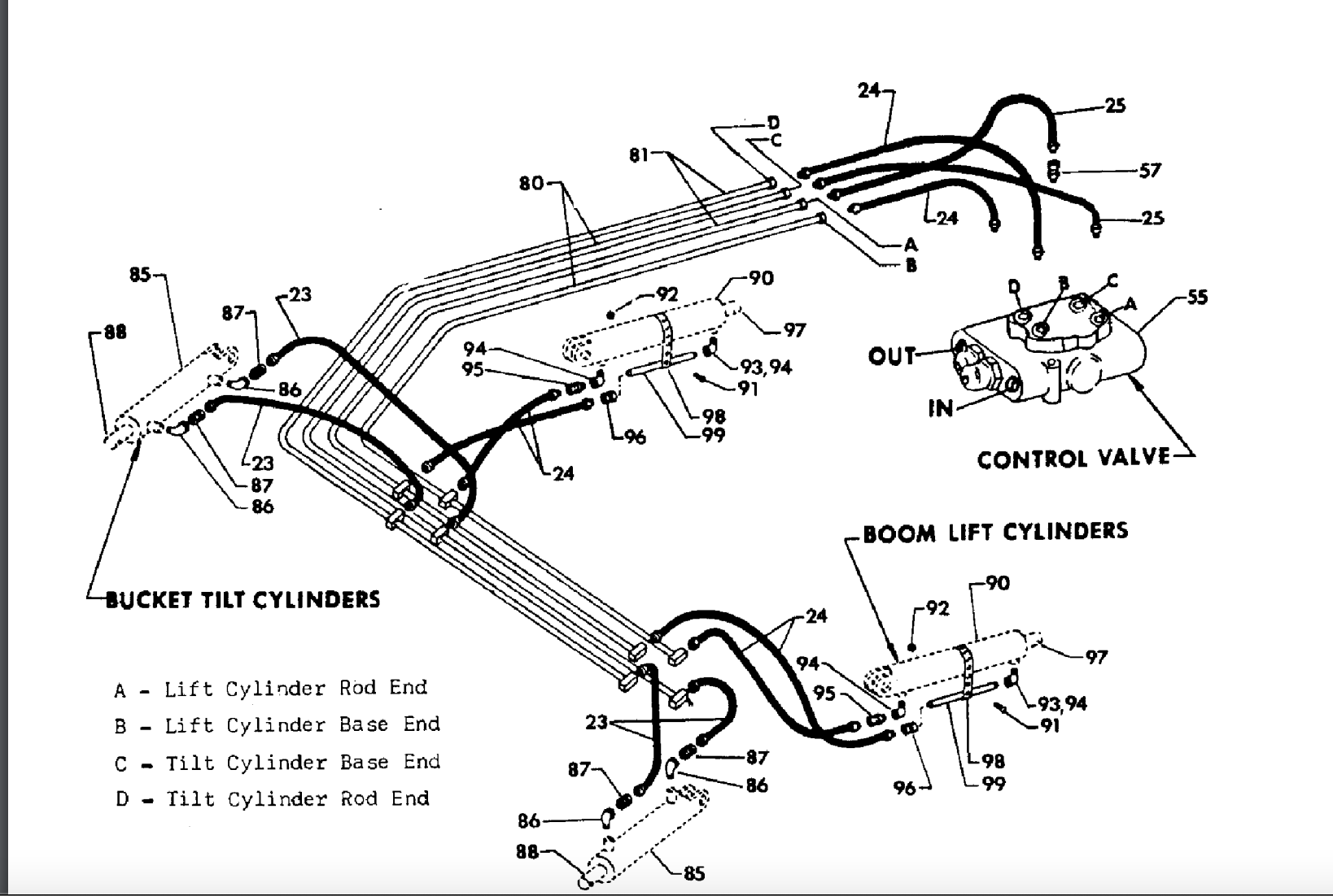

Would anyone have pics of the correct plumbing from the control valve to cylinders for a B-219 loader?
Found this diagram and verified all lines are correctly plumbed in.
Upon further inspection of the bottom half, no they are not , and no they were not since I bought it. The lower portion is all jacked up lol
Ughhhh driving me crazy.... if looking at the order of the steel bent lines its matches. but the position placements do not correspond to where the connections are. Basically steel line #1 is top and steel line #4 is bottom.... if that is the way I read it all lines are correct.
All common tie-in's on the lower steel correspond to the same tie-in per cylinder. Lower bucket cylinder is shared by both, upper bucket cylinder shared by both, lower boom cylinder shared by both , upper boom cylinder shared by both and the top side to control valve matches A->A, B->B , C->C and D->D.
So Now I am thinking either obstruction, bad hydro belt (less likely since down pressure is great), bad seals on the business end of the cylinders (lower seals?) or failing janky pump?
