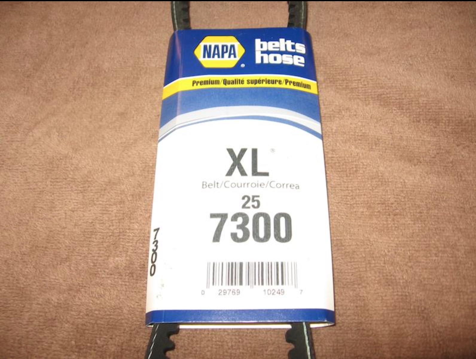

IdahoNative Active member Equipment Kubota B7100D 4x4, non-HST, FEL 1630 Jan 12, 2022 114 46 28 Florida, central Sep 23, 2023 #1 My fan belt self destructed while a friend was borrowing my tractor. Anyone know if it is 3/8” or 1/2” wide? I believe it’s 31” long. Thanks in advance!

trial and error Well-known member Equipment B7100dt manual trans. homemade FEL, 4 way hydraulic dozer blade Feb 16, 2023 393 379 63 NY Sep 23, 2023 #2 Kubota #70000-73818 Fan Belt Kubota #70000-73818 Fan Belt www.messicks.com This should be the belt but hopefully someone else can confirm. I dint see dimensions but it should give you a p/n to work with Reactions: 1 user

Lil Foot Well-known member Lifetime Member Equipment 1979 B7100DT Gear, Nissan Hanix N150-2 Excavator May 19, 2011 7,282 2,236 113 Peoria, AZ Sep 23, 2023 #3 Reactions: 1 users
IdahoNative Active member Equipment Kubota B7100D 4x4, non-HST, FEL 1630 Jan 12, 2022 114 46 28 Florida, central Sep 25, 2023 #4 Lil Foot said: View attachment 112421 Thanks! Most websites list that NAPA belt as 3/8”. I’ll give that a try. Click to expand...
