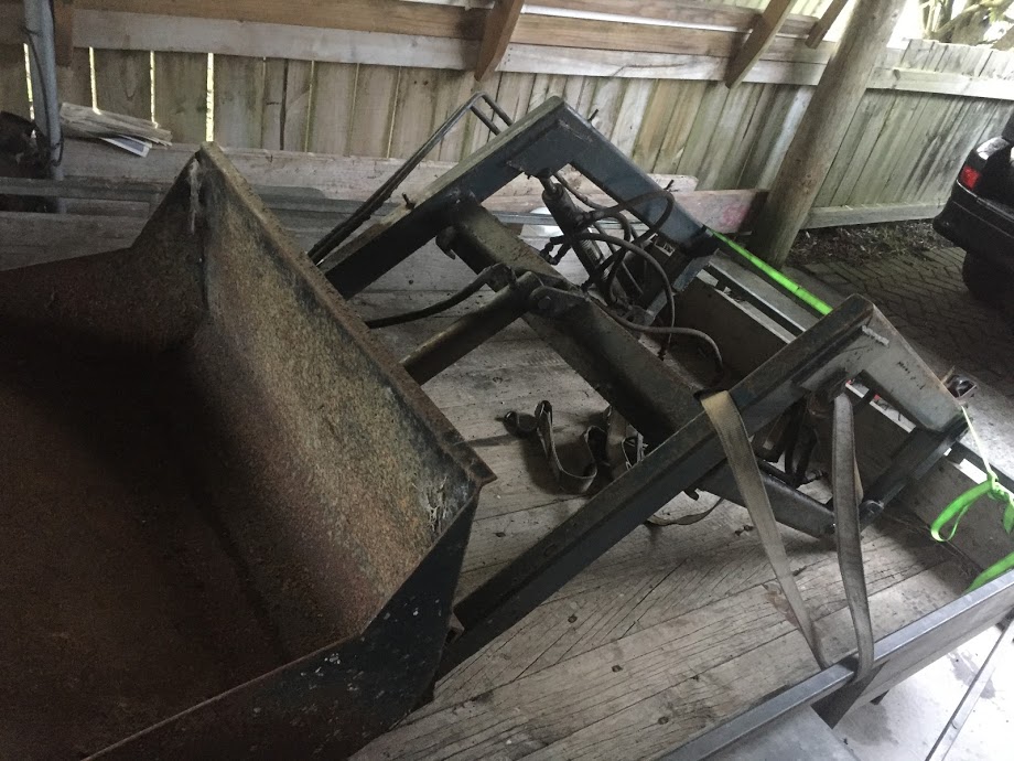

Hi Everyone,
Just thought I'd share my progress to date with trying to fit a Second Hand Loader that I picked up for $400 NZD to my B7100 HST
The Loader was fitted to a Kubota B1-16... (A similar sized tractor to my B7100 HST) So I figured... How hard could it be to make it fit...

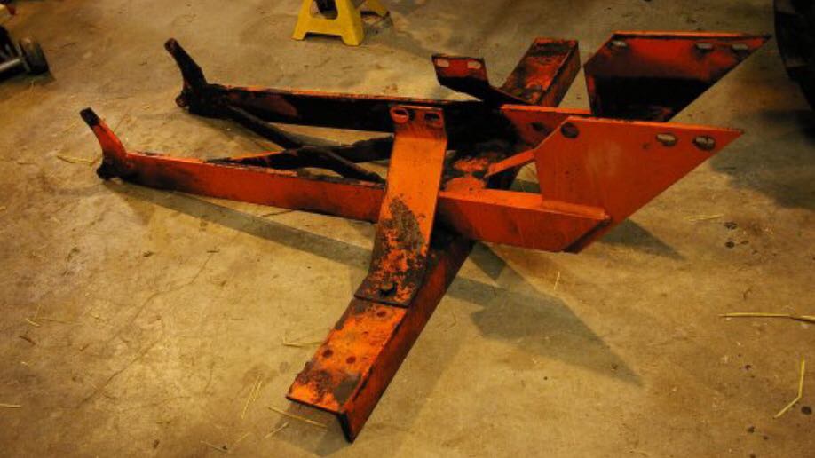

The guy I brought the loader from decided he was going to keep the "sub frame" on his Kubota B1-16 Tractor... I took a couple of pictures and it didn't look too difficult and figured I'd get something similar made up... Pic of his sub frame attached.

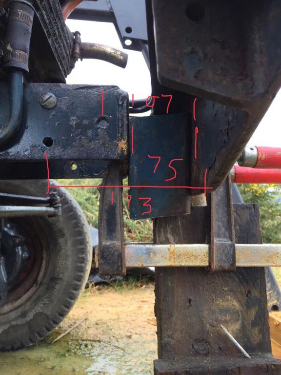

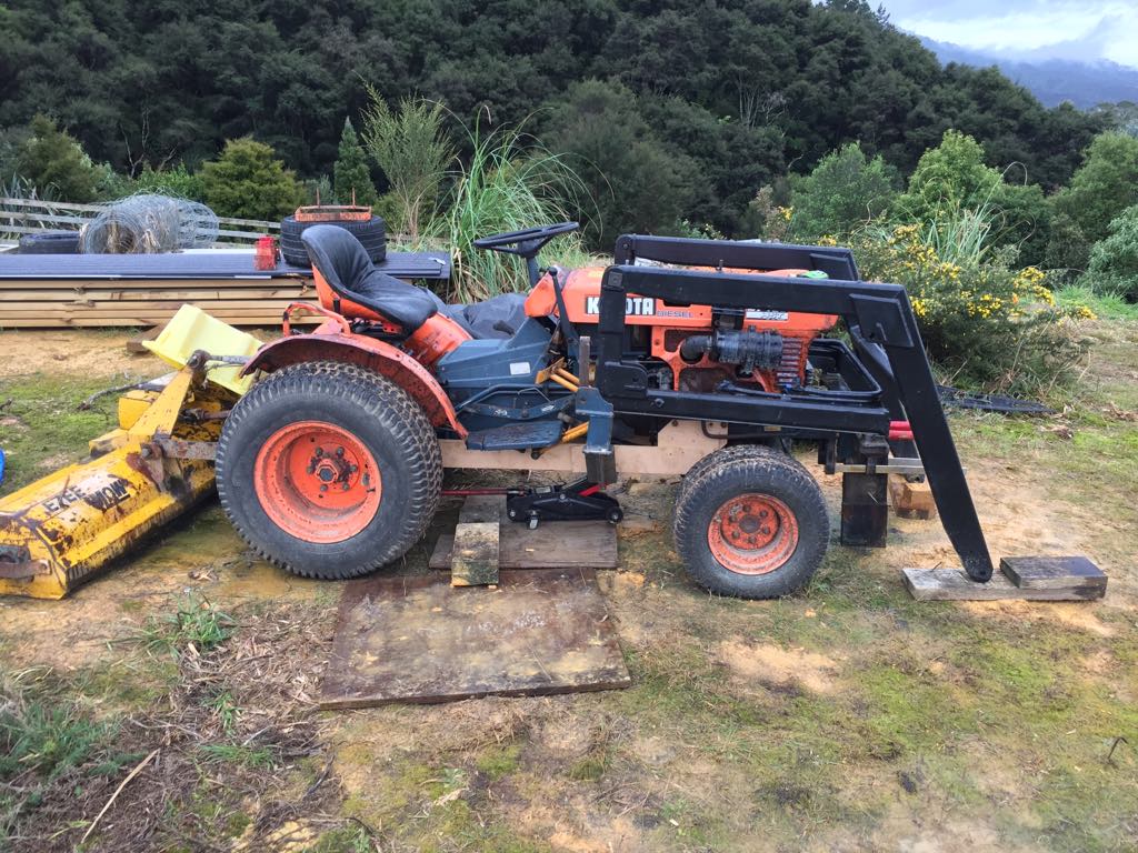

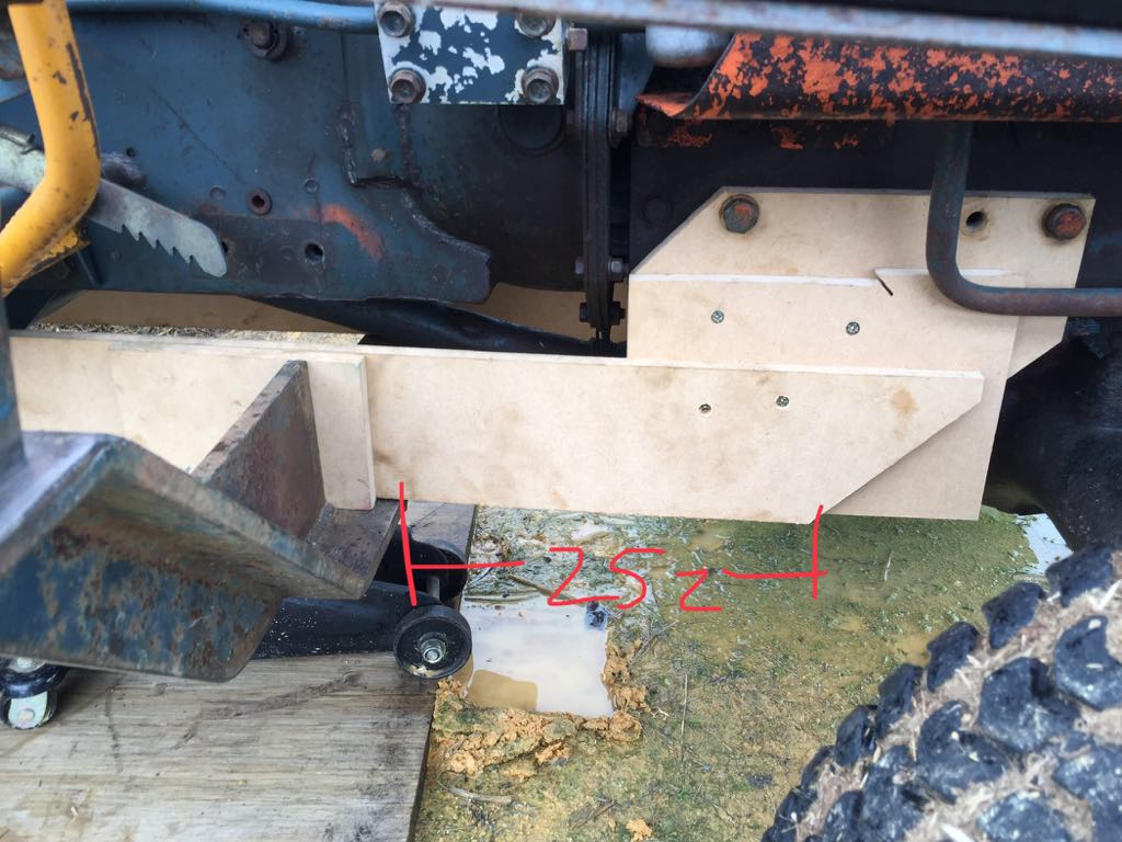

I wanted to try and get everything mounted to the tractor using a template that would allow me to figure out the best position to mount the loader to make sure it wasn't going to catch or foul on any part of the tractor.
Soooo.... Thanks to Hassman and the pics of the sub-frame ACAD drawings he posted in this post
https://www.orangetractortalks.com/forums/showthread.php?t=22322&page=3
I set about making up a wooden template of a Sub-frame from 12mm MDF so that I could provide that to an engineer and have a Sub-Frame manufactured.
For example... I was able to figure out that the whole loader needed to be mounted 75mm further forward (than where I intended) so the the right brake pedal wouldn't foul on the Loader strut
taranakiguy
B7100-D HST
49
Hamilton, New Zealand
So just thought I'd ask for any feedback, thoughts or ideas on the positioning of the Loader... fabrication of the Sub-frame etc before I hand this over to an engineer to fabricate for me... Any comments welcomed and appreciated

Nice !! Wood is a LOT easier ( and cheaper) to 'fab up' than steel ! I cut a LOT of wood into 'structural steel' sizes to do the same thing 4-5 years ago. Wood screws are easier to remove than welds.
I took my 'wooden wonder' to a friend and 3 days later his CNC machine had made the parts AND he welded them as well for me.

How about a combination of the two options.
If the B6100 sub frame is only short in 1 or 2 areas. Take your wooden set up with you to a local welder. They should be able to stretch your steel frame to the lengths of your wooden one.

What G.rid said. Simple modification for someone with experience. You have done the hard part figuring the length with the mdf.

Thanks G.rid... Yip good option... the rear of the required subframe (where it bolts onto the rear axle would be quite difficult to cut out correctly (Unless perhaps waterjet cutting?) so I figured I'd sacrifice the purchased subframe so that this rear section can be "recycled"
The "rails" of the subframe have a "cut out' where the Brake pedal mount is... therefore to make the B6000 subframe fit with my tractor, it would have to be cut and extended at both the rear and the front... so I figured it would be easier just to start with new 4" flat bar.

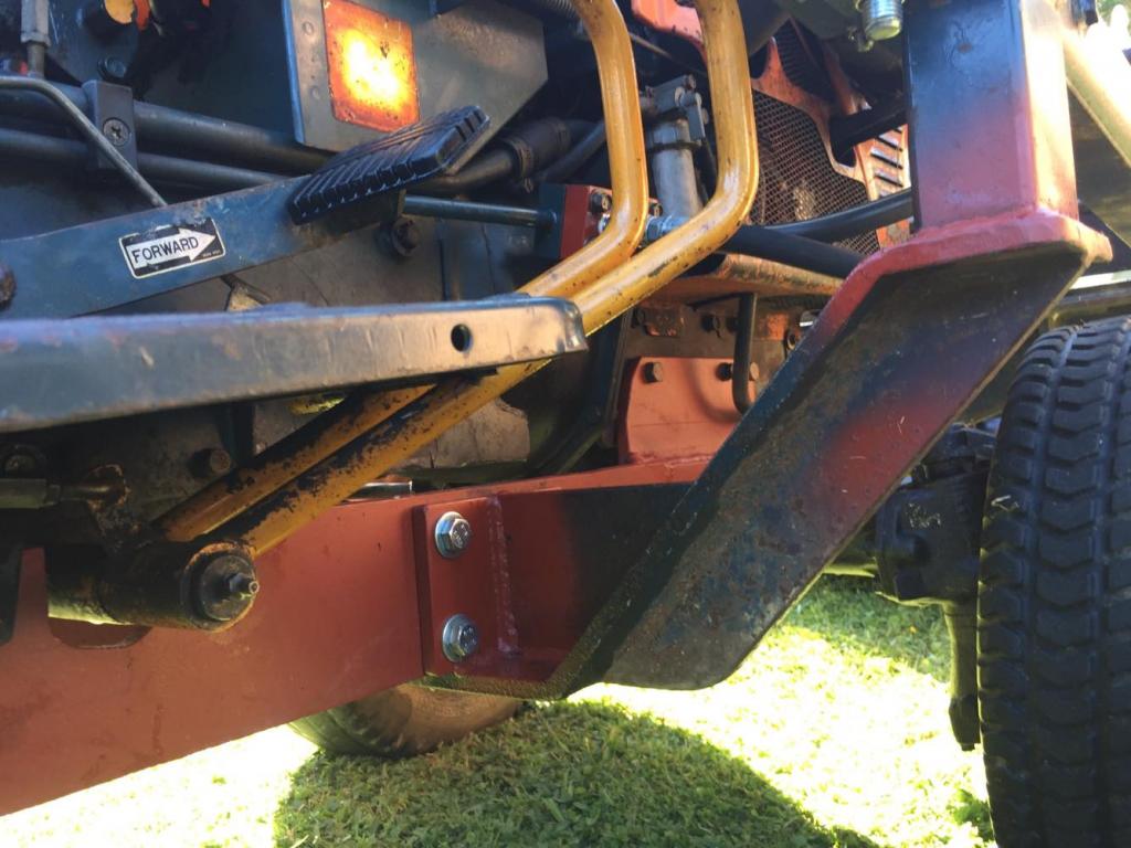

Hey Lencho, Almost embarrassed to admit I have a welder in the garage... (I recently inherited it from my father) I just wouldn't want to trust my welding skills on a project like this!!! *makes mental note to research welding night classes.
That said... I did have to shorten the struts in the attached Pic by 130mm (the subframe on the previous tractor obviously sat a lot lower, and I wanted the additional clearance under the tractor) So... I broke out the angle grinder, cut the struts shorter, ground the original weld off the horizontal plate and plucked up the courage to tack weld the shorter strut back on to the plate...
I'm sure the engineer will take one look and shake his head!
And before you ask... Yes... It is meant to be leaning forward like that! lol

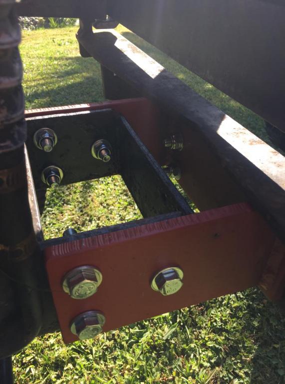

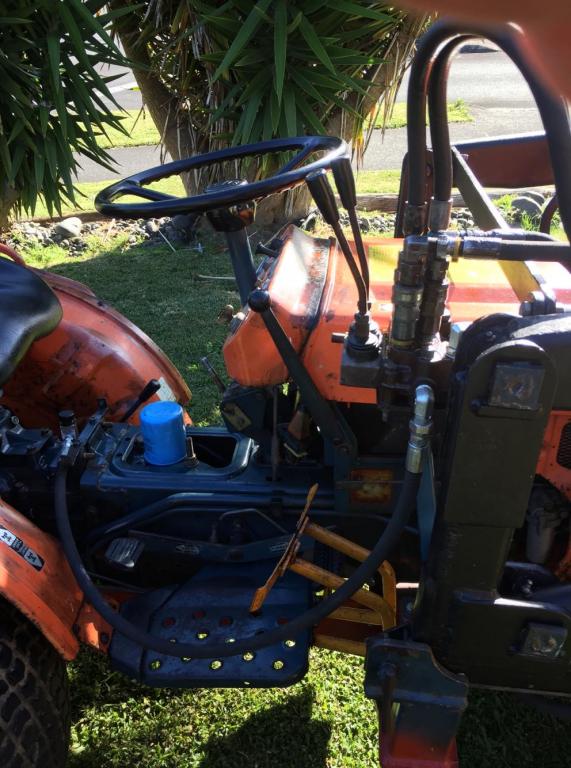

Well... it's been a while but I'm back with an update
Progress since last post...
I now have an operating Front End Loader on the Tractor!!! I haven't had a chance to put it under any load yet.. but she moves up and down and seems to do all the right things.
As per my last update, I was getting an engineer to fabricate the Loader sub frame after I made a template from MDF... it took him some time to complete and I completely underestimated the time (and therefore cost) of him doing this... He charged me 22 hours to fabricate the subframe and also create a Hydraulic Diverter Block so that I could drive the loader...
Anyways... you can see from the pictures the net result... I still need to take everything back off the tractor and paint... but given the tractor is not in the prettiest of states, I'll get around to this at some point.
Things I've learned...
* Engineers are expensive
* Hydraulic Hoses and Fittings are expensive
* The Vapormatic Hydraulic Control Valve that came with the loader needed a $1 part to convert one of the outlets to power beyond port.
* The loader definitely needs a "return to tank" Line
* Make sure you get the "return to tank" and "power beyond" plumbed the right way... or else you have no 3 point linkage hydraulics (and surprised I didn't blow anything)
* Don't run the tractor out of diesel while troubleshooting why the hydraulics are not behaving correctly!
(Plus side is, I now know how to bleed the fuel system on a B7100)
taranakiguy
B7100-D HST
49

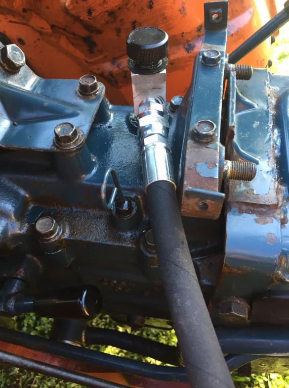

A few more Pics of the Plumbing.
The Return to Tank line is too short, So I will need to get a longer one made so that I can re-route it away from where it currently sits (a tripping hazard when getting on and off the tractor)
Also the return to tank connection/fitting seems to have tapered thread, so the cap won't screw all the way in... I'd like to find another solution for this

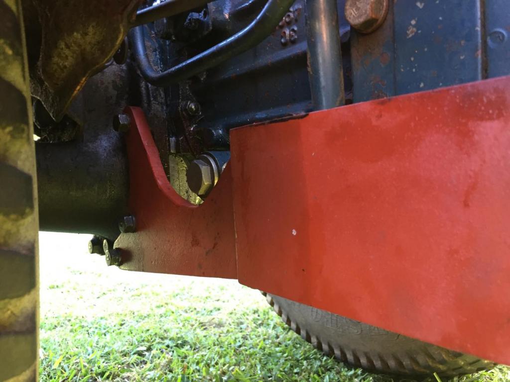

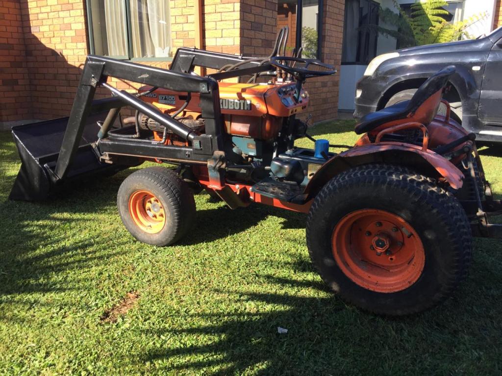

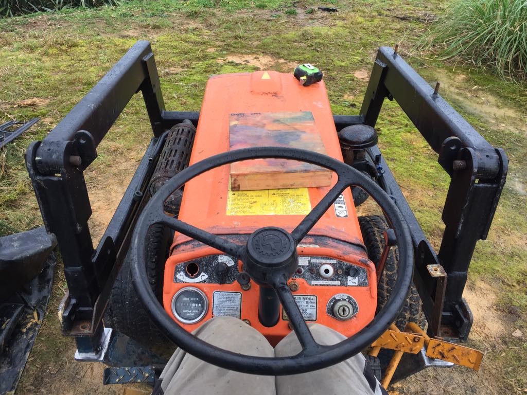

And some over all pics of the tractor with the loader attached.
Seems to fit the size and look of the tractor well, I'm glad I shortened the Loader mount struts (by approx 130mm) otherwise I feel the loader would have sat far too high.
The cross brace the sits above the bonnet, is a pain as it needs to be removed to lift the bonnet, wondering if this can be removed without affecting the integrity of the loader???
