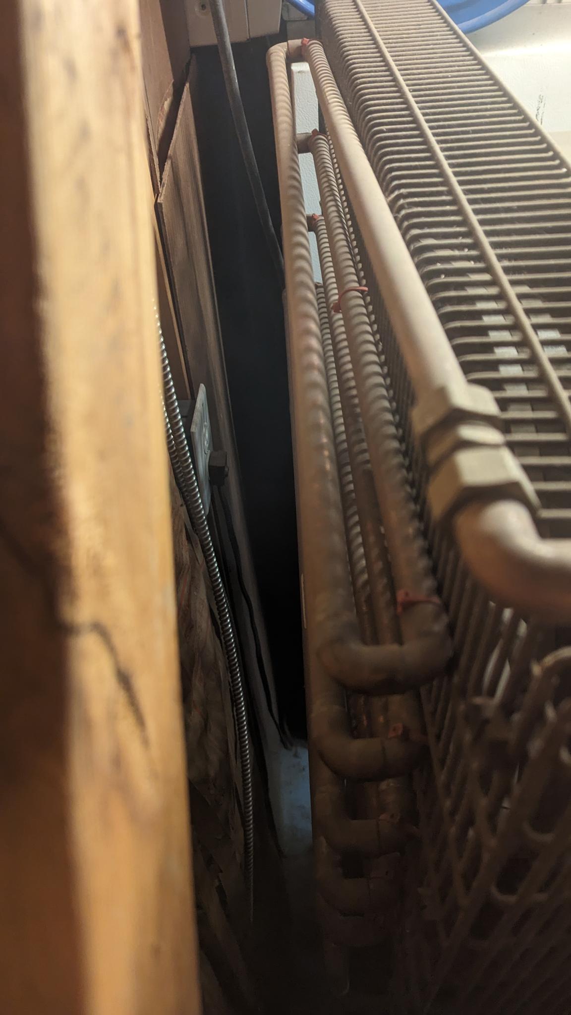

I also devised this setup about 15 yrs ago. Plumb air out of the compressor through series of baseboard heat, then into the tank. Moisture drops out of cool air faster thereby drops to the bottom of the tank and is not circulated. The sections of baseboard will actually start pinging when releasing the heat.
No clogging issues with glass bead cabinet since.

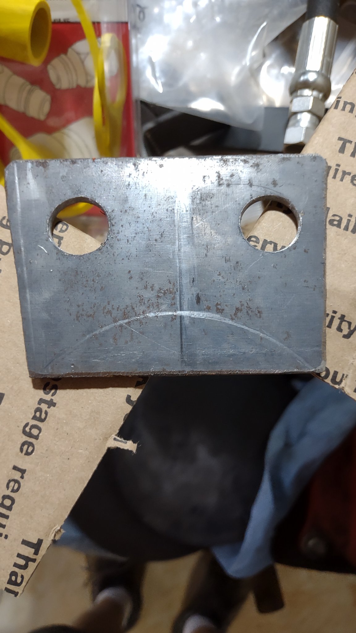

You guys bragging about your fancy-ass tools, and ole PoTreeBoy's gonna have to cut out the curve to fit my cross tube with grinder and cut-off wheels. Yes, that's a frown. Congrats!
Mine uses a similar concept. Was recommended by some old timer on Len's Auto Body Forum. (decades gone now I believe). Until now, I had never seen it used again.
Pictures aren't great, but basically copper was plumbed into switchbacks, behind the fan/pulley, that drain back into the tank.
I also have a Sharpe F88 filter after the copper (bought from Len's store). Filter never appears to need draining. Never had issues with blasting, plasma, whatever.
