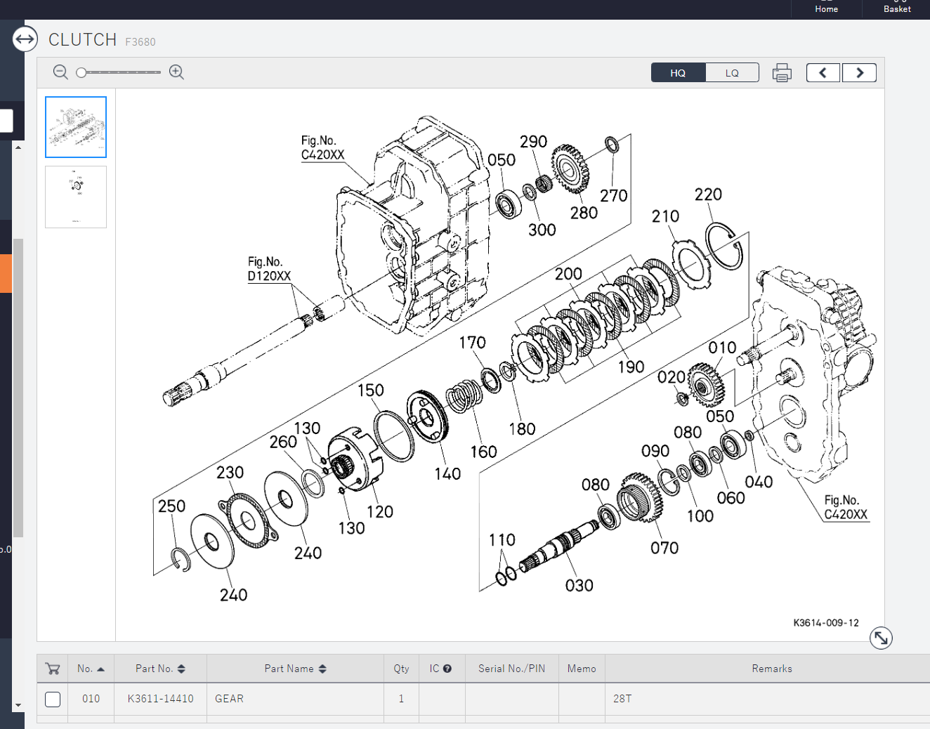

can anyone answer question pto works without attachment when attach attachment pto doesn’t work
can stop with vice grips against arm anything other than clutch?

Not yet bought machine don’t know history but I have 4 of them so parts is not problem
Where can u check pressure ?
Could spring be broke in clutch
Why work without attachment but not with attachment?
