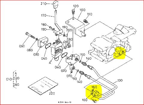

To tap into the hydraulics on that unit it's done via a plate on the side of the lift cylinder.
What you think is the hydraulic pump is not, (the hydraulic pump in on the motor behind the Injection pump) that's the HST, do not tap into anything on it or you could cause costly damage!
If you want the kit for the valve which includes all the parts:
P/N K3511-90670
Or you could buy the pipe and adapter plate and make up your own valve setup:
P/N K3511-90612

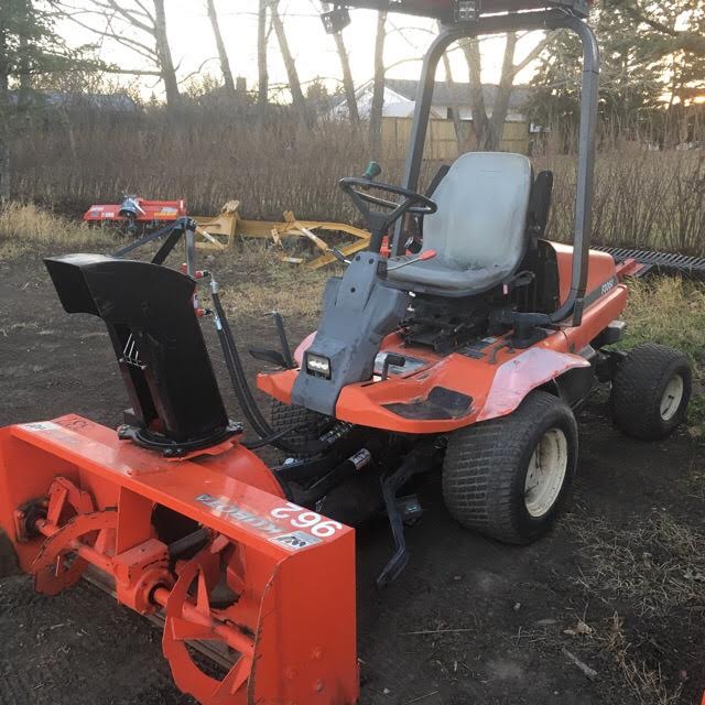

I tried to fabricate my own pipe and adapter plate. I ended up chasing leaks where I was self-teching myself tig-brazing to join 3/8 hydraulic lines to a home-build adapter plate. Kind of worked, but lots of leaks.

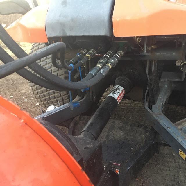

So, I purchased the pipe and adapter plate from Kubota (CAD$195, 3 days delivery) cut the hardlines down, and got hoses built to adapt the 10mm DIN connections on the Kubota pipes to the 3/8" JIC fittings for my valve.

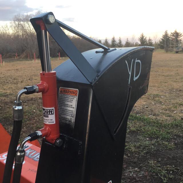

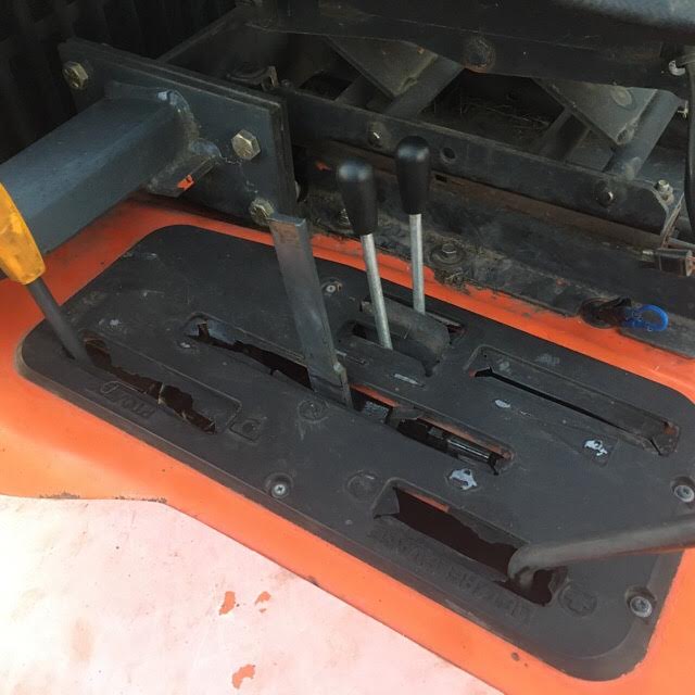

I used a dual valve from Princess Auto, added a motor spool valve, built my own mount, and added a 4" cylinder to actuate the chute height adjustment. 4 quick disconnects, 8 custom hoses, 10 hydraulic fittings, some hose brackets, a bit of scrap steel from the steel bin and some farm-quality welds, and 7 trips to various suppliers, and it might have been cheaper to buy a new tractor!
For the record, my aux hyrdaulics cost about $1000 all up, plus the $750 for the blower at the auction, and $450 for the Quick Hitch... for Under CAD$2,500, I now have I have a skookum blower ready to chooch some blizzard azz!
