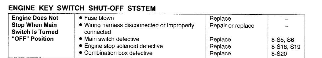

You will have a timer relay hidden and built into the combination box. It keeps power to the solenoid for a few seconds to allow the engine to stop.
According to the WSM the Combination box is usually the culprit.

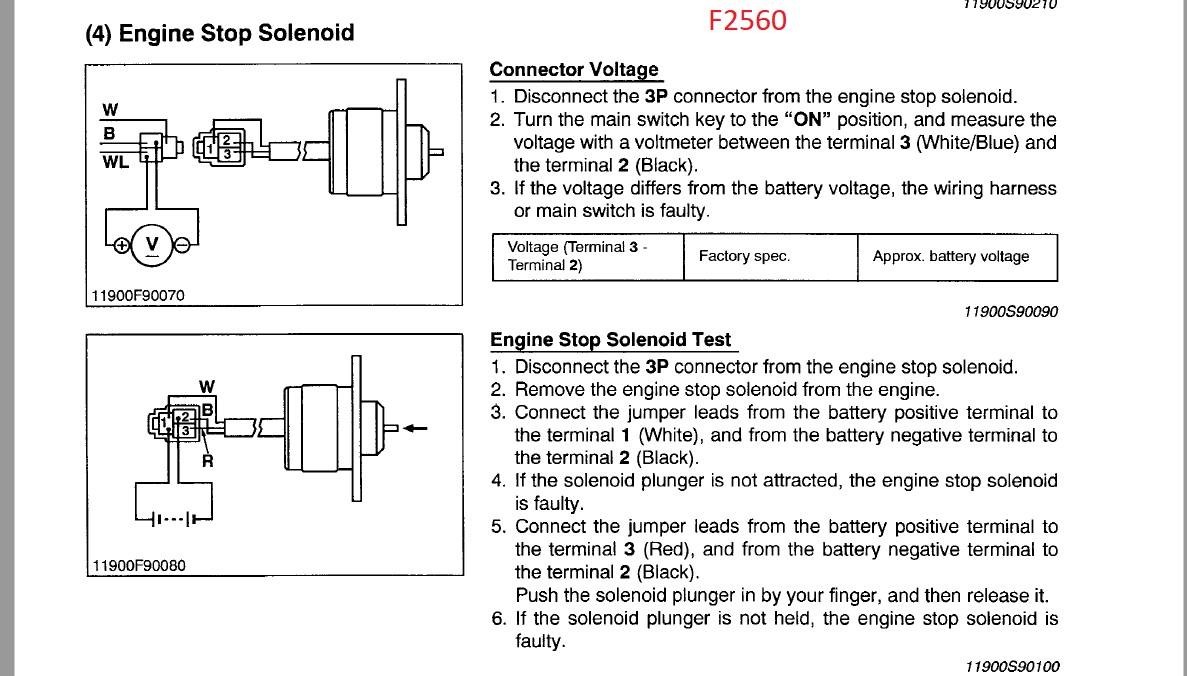

Depends on what solenoid you have. If it’s the single pin external solenoid then below will help you determine if it’s faulty. If it’s the 3 wire version that’s internal and has the pull hold feeds then above will help. Going by the thread title I’d imagine you have the internal 3 wire pull hold solenoid. It seems to work when cranking but will cut out as soon as the key returns back to the run position. You need to make sure there is voltage going to the hold pin.
The relay has 4 pins, you can remove the connector that goes to it and test it to make sure it has voltage going to it, you can also remove the relay and bench test it just to be sure but going by what you are saying it’s more than likely faulty.
It has a 12v constant feed, a switched 12v feed, a ground and then the one that goes to the solenoid. If you remove the connector and test for constant 12v, switched 12v and ground then this will tell you what pins to test on the relay itself, then you can bench test it. I did this test a few weeks ago just to confirm a faulty relay on a B2150. I applied constant 12v, ground, then applied 12v to the switched feed, I had set up a test light on the pin that would feed the solenoid and when I removed the switched feed there was nothing at the test light, I did the same test with a known working one and when you remove the 12v feed the test light came on for 5-10 seconds.

Dave those tests aren’t for the relay which gives power for a short time after switching the ignition off, those relays are for engines fitted with the external solenoids where they are activated for a short period once the key is turned off.
The tests you’ve posted are for a pull and hold solenoid which has 12v constantly applied for the hold function when the ignition is on and a short 12v supply for the pull function when cranking.

I cannot argue with you.
I just went to the F2560 WSM which I happen to have a copy of.
Perhaps the "E" after 2560 makes this difference.
