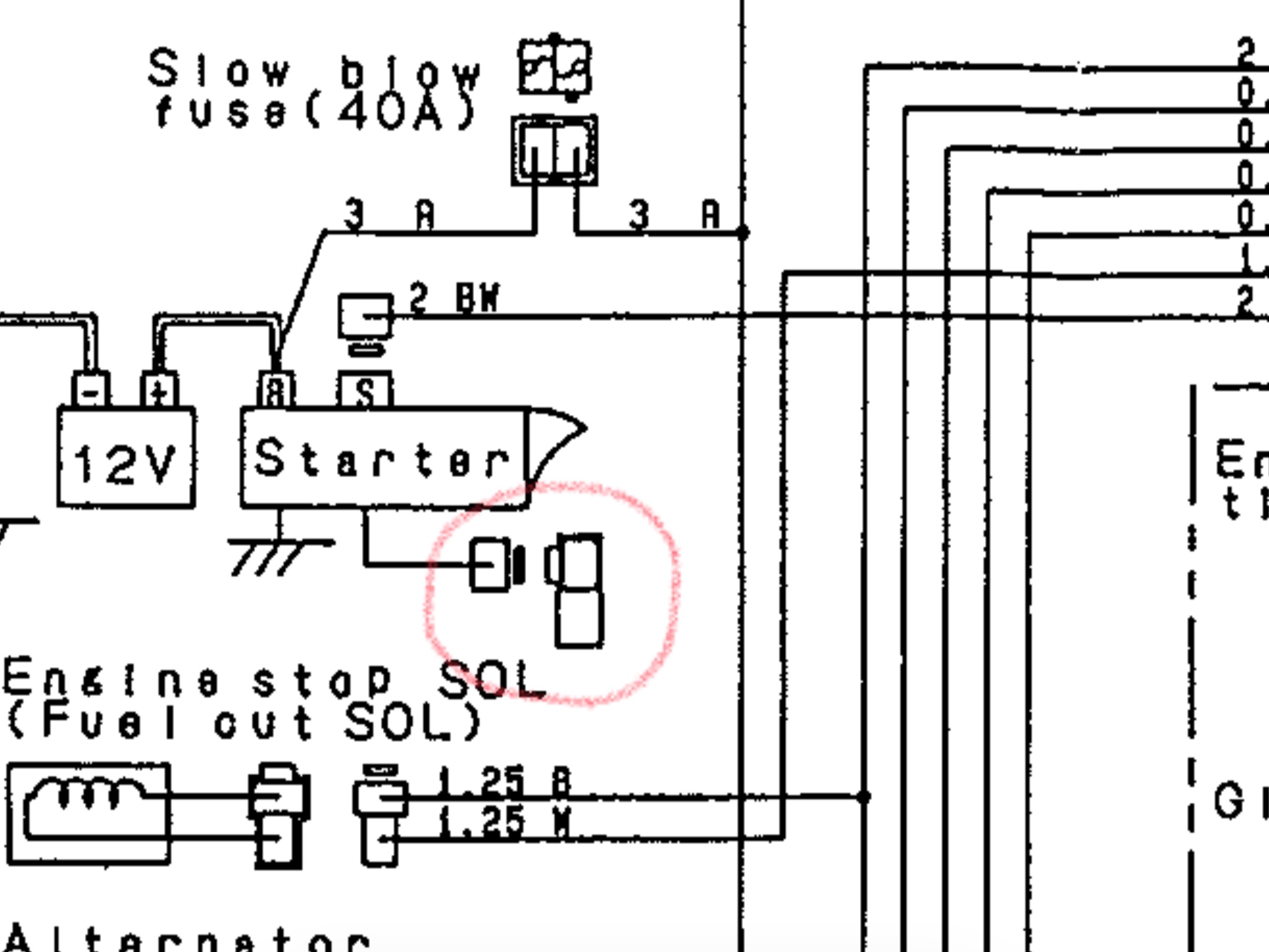

I was going to post this question separately but I thought it might be of some use to the OP, so I’ll post it here.
I looked at the electrical drawing for my KX41-2V. In my case the battery voltage comes off the starter and through an in-line fuse as described by Wolfman in his previous post.
The voltage then goes onto the switch and comes back to the starter solenoid directly.
My question relates to what is on the other side of the starter solenoid. In the case of my BX 2200 tractor, there is the fuel solenoid which completes the circuit that energizes the starter solenoid. In the case of the KX, I’m not familiar with what the symbol shown in the following screenshot is.
Can somebody tell me what this symbol represents?
That would be the extra wire that comes off the starter for the stop / run / fuel solenoid.
It's just an odd way to show it's and unused terminal.
And it's actually the other way around, the starter solenoid supplies voltage that pulls the fuel solenoid open, then the second wire to the fuel solenoid gives it the hold voltage.
I know how the circuit on my BX works, the pull in coil is activated by the current that flows through the starter solenoid when that same current activates the solenoid, which causes the starter to turn. The hold coil is energized when the key is in the on position (And also in the start position if I remember right).
But the circuit on the KX41-2 that I pictured above uses a timer to activate the “stop” solenoid. I took that to indicate the KX activates the stop solenoid for a time, to cut off fuel, when the key is turned to off, but have not followed that part of the diagram yet, as l got sidetracked by that symbol I asked about.
Having a “stop” solenoid that is activated by a timer could imply that a hold coil is not needed, as the fuel path might likely be open until the solenoid was activated.
At this point I am not sure my question is contributing any help to the OP...
BUT if the OP’s circuit happened to be the same as the one I pictured, by starting his excavator, by shorting between the terminals on the starter, he would have verified that device I questioned was not his issue.
