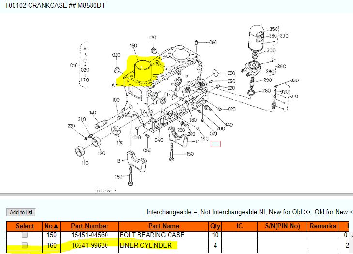

33,493
8,764
#1 Find a much more competent mechanic to look at it!
Before you spend the money to rebuild it, have a mechanic that actually knows these engines look at it, or simply enough take a video of it and post it on youtube and give us a link to see it.
I've worked on quite a few engines that others thought needed a total rebuild, only to have it need injectors or a crankcase breather cleaned out.
One such engine the previous owner didn't like the drip or smoke coming from a crankcase vent and plugged it, thing smoked like a train. :eek:
