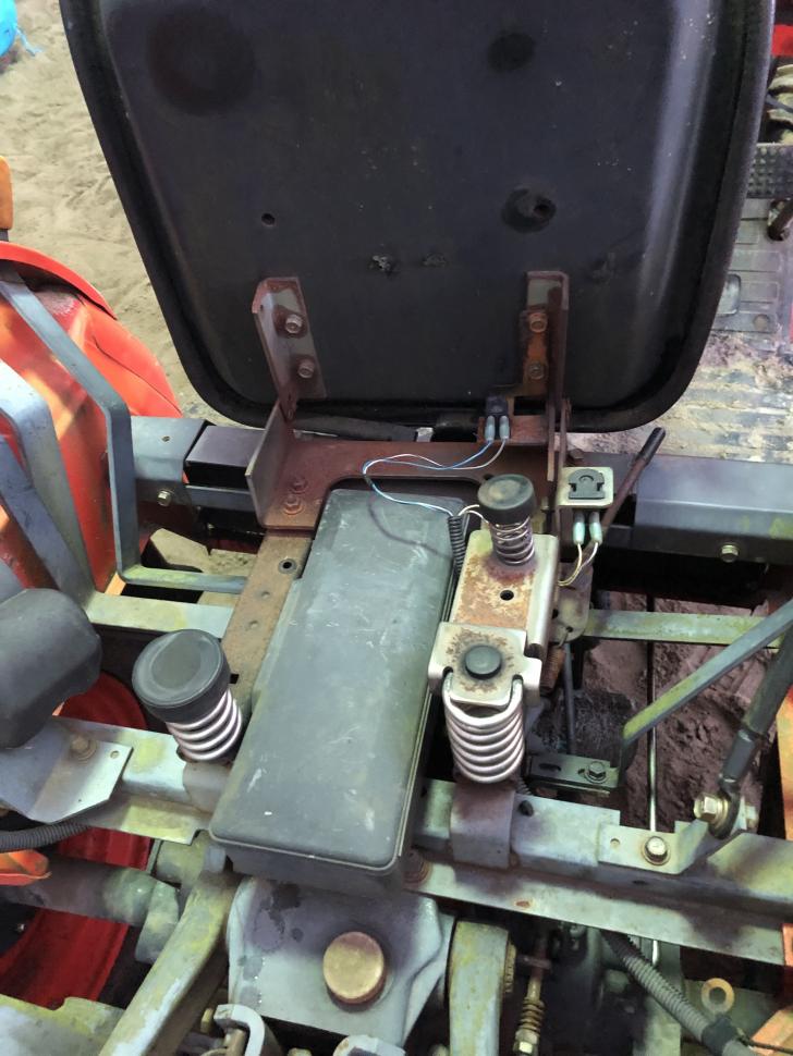

As for the seat switch, here is a photo of the wiring. I only see one switch...but will consult the WSM for official details:
Click the thumbnail to see the attached jpeg....

It doesn't look like in the photo of the seat that the seat switches are bypassed?
Just wiring the switch down does not bypass a bad switch.
Take the wires off the switch and put a jumper between the 2 wires.

And the answer is......
SEAT SAFETY SWITCH !!
Yep, just as you suggested, the seat switch was the source of the problem. Obviously the switch was stuck in the open position (at least some of the time) causing the engine to kill when applying the pedal.
Here is what I did. I pulled the connectors off the seat switches, one at a time (there are 2 switches). I jumped the positive wire to the ground wire using a 15 A auto fuse (which just happened to fit nicely into the connector ends (see photo).
The problem went away when I jumped one of the switches , (but not the other). More importantly, when I removed the jumper from that switch, the problem returned. I could repeat this experiment back and forth several times with the same results, proving that the source of the problem was a malfunctioning seat safety switch.

Attached is a photo of the jumpers in place...I secured them with electrical tape (for now). These automobile fuses just happened to fit perfectly into the connectors without needing to cut and re-wire anything.
