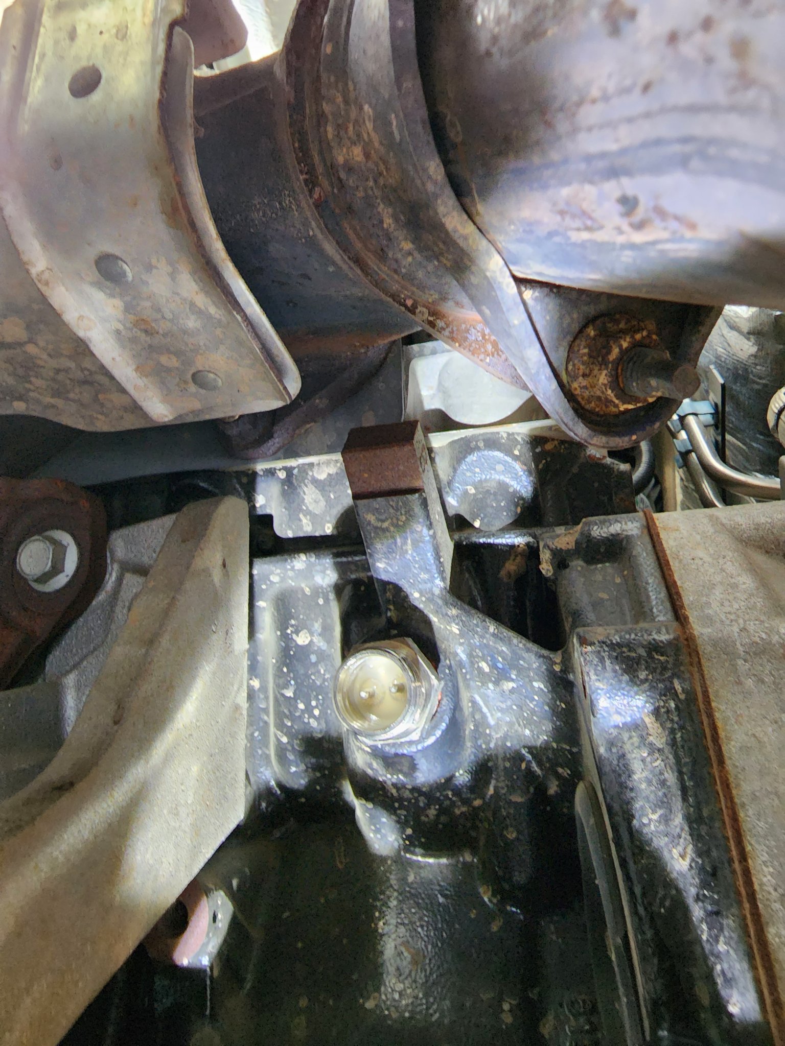

Thanks to @Fordtech86, I found the block heater install location.
I think that once the weather dips below freezing regularly, I'll plug in the unit on a timer to start the heating process a few hours before I expect to need the truck.
Edit: The engine block heater location on the 6.2 gas Ford engine is under the exhaust manifold close to the transmission bell housing on the driver's side.

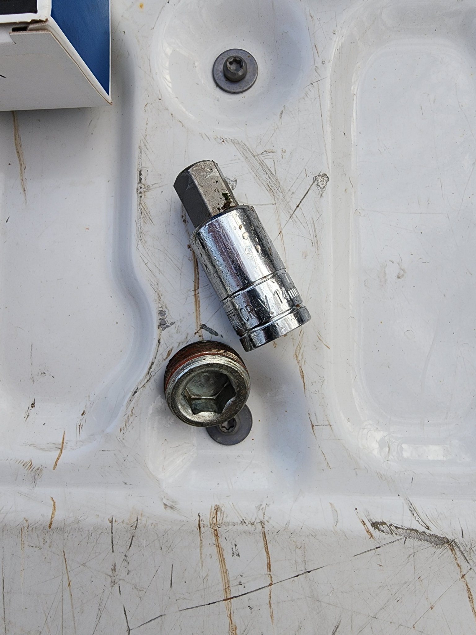

So, finally got it installed today since the weather warmed up into the high 50's low 60's today.
I'm posting this part for future reference for those searching for info.
My truck is an 2017 4wd F250 SD with the 6.2 gasoline motor:
The engine plug at the block is a female - 14mm hex plug. You'll need a 14mm male hex socket. I bought a whole kit on Amazon for $30.
I bought the factory Ford- engine block heater element, Ford P/N BC3Z-6A051-C. That was for my truck. Yours may be different. I bought it online from a Ford dealer for a lot cheaper than my local Ford dealer offered. Give them your VIN and you're good to go.
My Ford factory heater element has a 1 1/8 socket nut.
Having the new plug - heater element ready to go, I pulled the factory plug with the 14mm male hex socket with my Milwaukee impact. Then quickly installed the heater element in the threaded hole by hand. I got wet with antifreeze, but only lost about 1 cup of antifreeze. Which I had on hand to refill.
On my heater plug - element, the inner prongs for the heater cable needed to be parallel with the ground for heater cable attachment.
