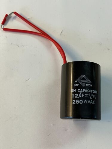

I assumed run/start caps were bad, but at Grangers today the cap I brought with me tested fine on their equipment.

There is one of these caps on eboy coming out of Canada for $57- a lot to spend if not the problem.
(or even if it is the problem;))
