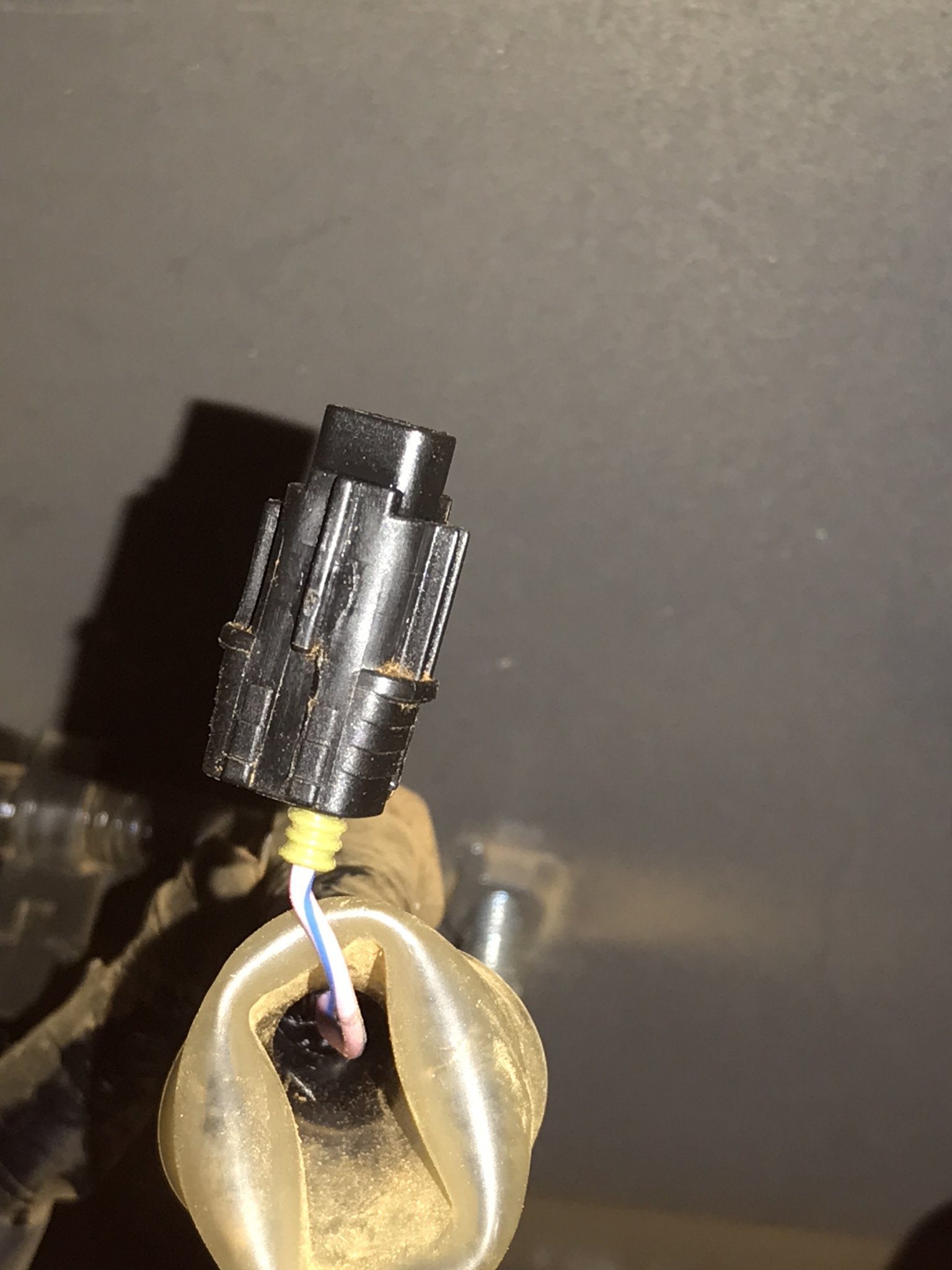

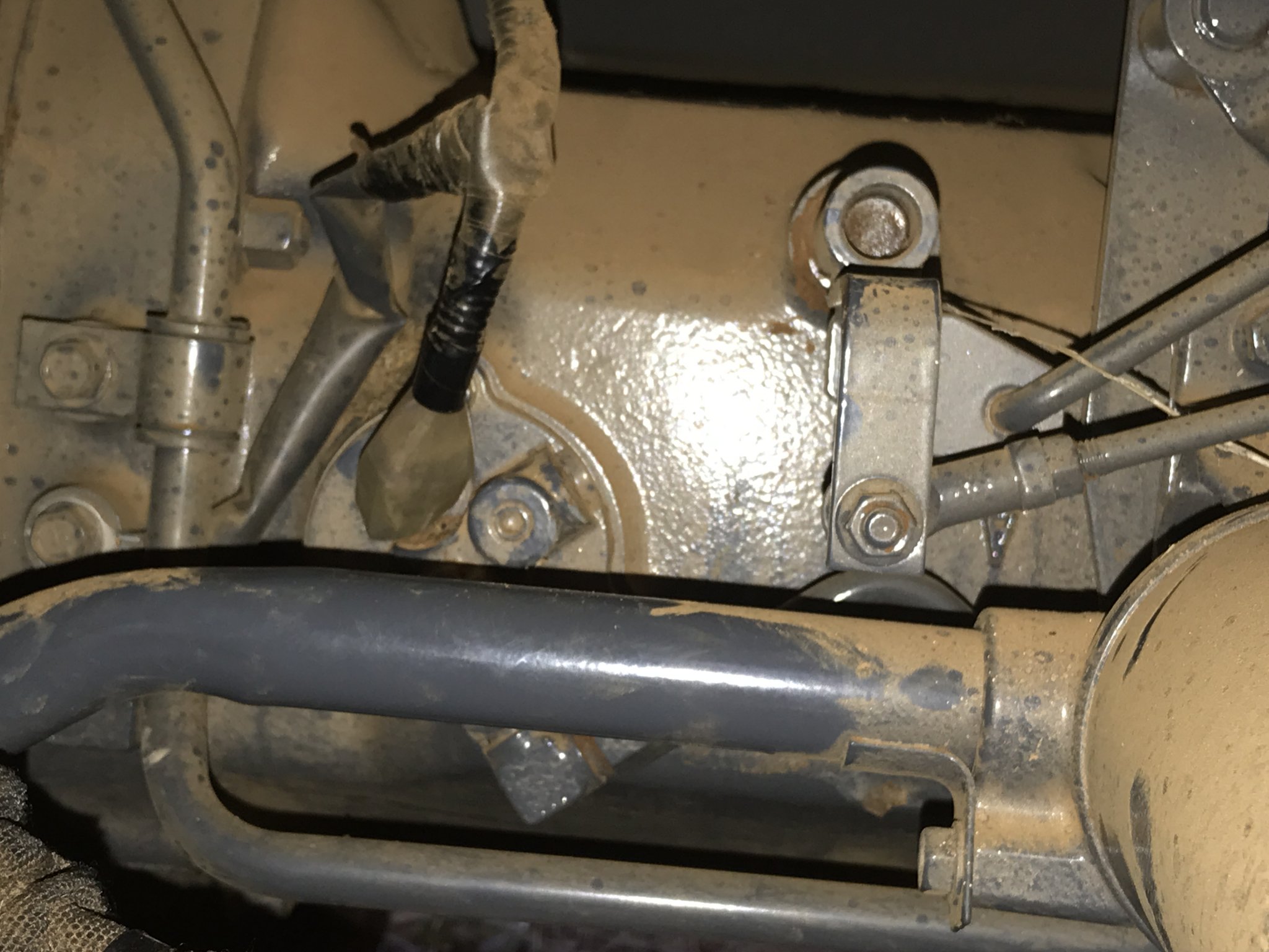

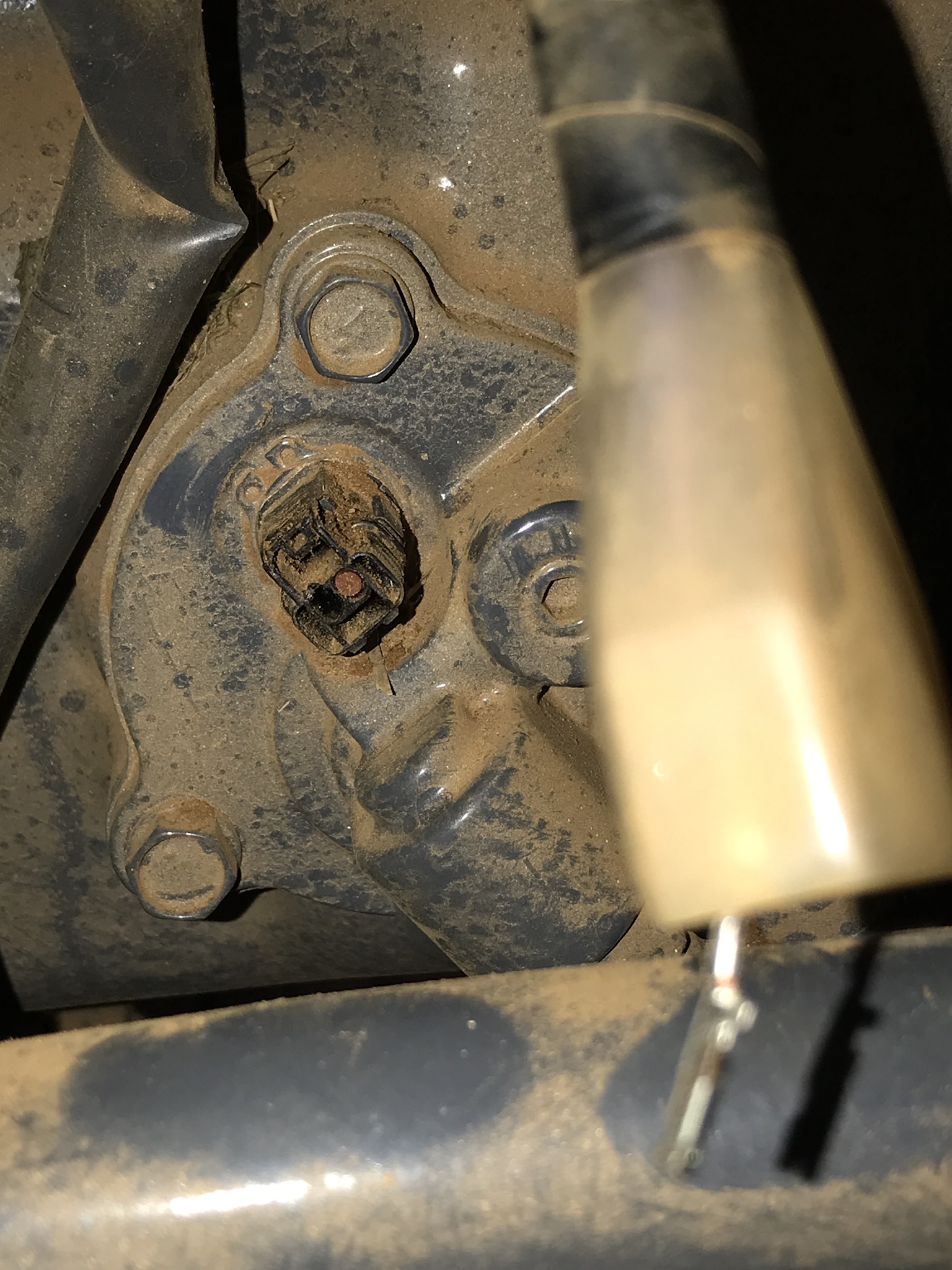

Hey everyone, I’m new here. Anyways, on our MX5400 a random stick pulled a connection loose underneath near the oil filter and now I’m getting an E-95 error and it’s disabled the PTO. I have reattached the wire but I cannot get the code to clear using older methods that I’ve found. Does anyone have any advice. Also if I need to replace the electrical clip/connector is there a market for those? Dealer said they could only sell the entire harness.

Thanks for the info. I was able to reassemble the connector and the code cleared once I had a good connection and reset it via the “b” method I found in this forum. Hopefully it all stays together!
