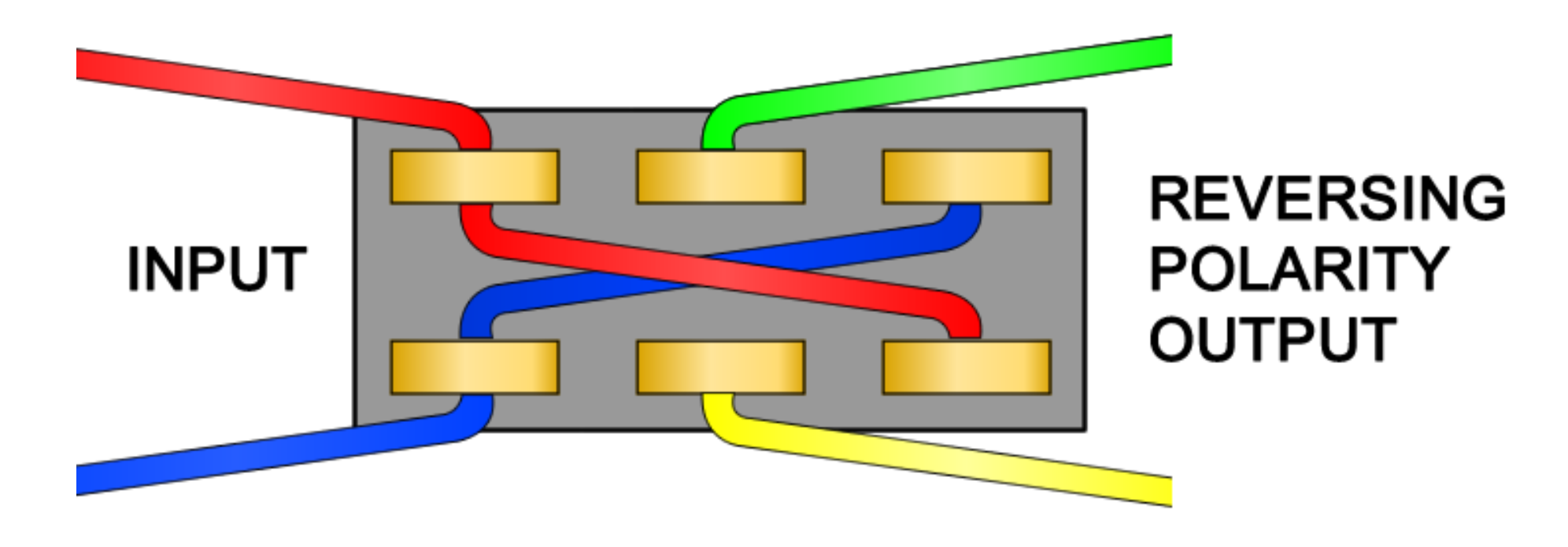

I'm assuming you meant 14 gauge as you referred to it earlier but I'm not sure your wiring advice is correct.
Doesn't the deflector motor need its polarity changed to reverse direction? If so, you would need a dpdt center off switch. Neither of the motor leads would be 'grounded'.
The input here would be your 12v and the output to the 2 motor leads.
If it uses the simple actuator with 2 wires coming out of the motor, a momentary On - Off - On switch is all that he will need. Feeding the center terminal of the switch with the positive wire, and 2 wires going out to the reversible motor.

There's 2 type of 'reversible' DC motors..
the most common(aka cheap to make) has the motor power 'floating' NOT 'grounded' and you use a DPDT center off, momentary switch to 'flip' or 'reverse' the power going to the motor.
the other method, requires that the motor have TWO separate windings ( 1 forward, other reverse ). This style is more complicated to make (aka EXPENSIVE ). It uses a slightly cheaper SPDT, momentary off switch to feed +12 to either of the two wires, with the motor ground being properly connected to the battery negative.
I'd have to see the actual installation / wiring diagram to see what is used though I find it hard to believe that the 'common' setup isn't being used, pictures will tell the story.
