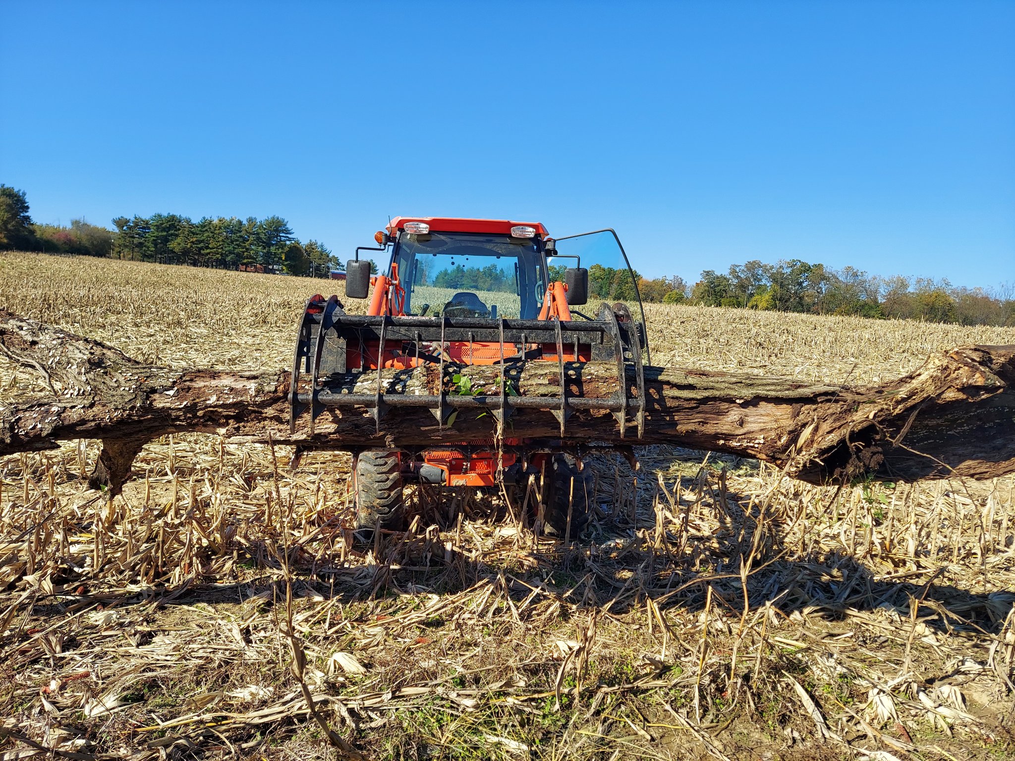

I push trees over with mine pretty routinely. I don’t push with the lids. I push with the lower teeth in the center in between the lids and keep the curl such that it’s pushing pretty much in line with the loader boom. If the tree is big enough to span the gap between the lids, my little grapple and tractor ain’t pushing it anywhere, so avoiding the lids isn’t an issue. At least for mine, I don’t think the lids are really designed to be pushed on.

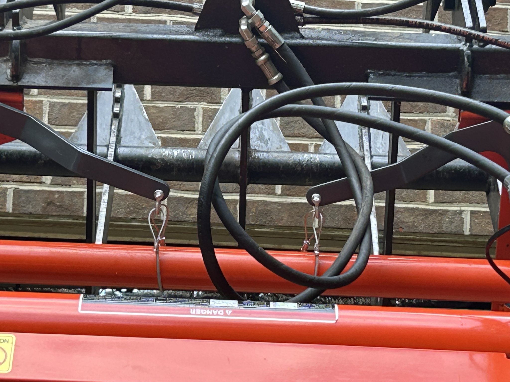

Edit: And maybe consider coming up with a way to lock the SSQA latches down. I recently bent my SSQA plate due to a limb poking through the back of the grapple, unlatching one side, and the grapple coming half off while loaded pretty heavily. I’m sure there are numerous solutions. This was mine.

Thanks for that safety cable idea. I just ordered a roll of 1/16 cable, sleeves,and ferrules. The 1/8 I have seems too stiff.
