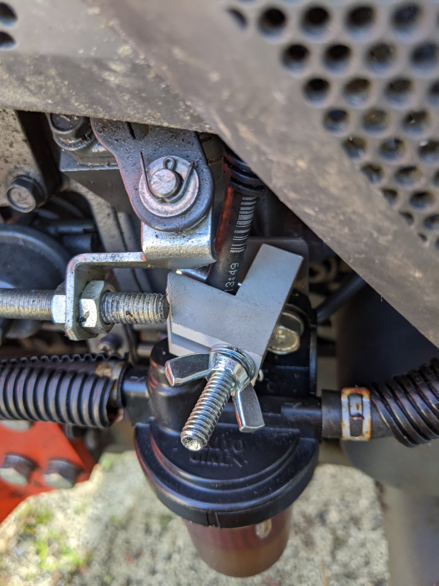

I use a line/hose clamp that I picked up from NAPA for about $6.00 for a set of two. I needed it when I had to replace the fuel return line from my fuel filter to fuel tank on my L3200.
Fuel was just pouring all over the ground when the nipple broke at the tank. I had to clamp the fuel line going into the filter in order to stop the fuel from pouring out while I placed a new nipple in the fuel tank and the new hose on the filter and tank.
